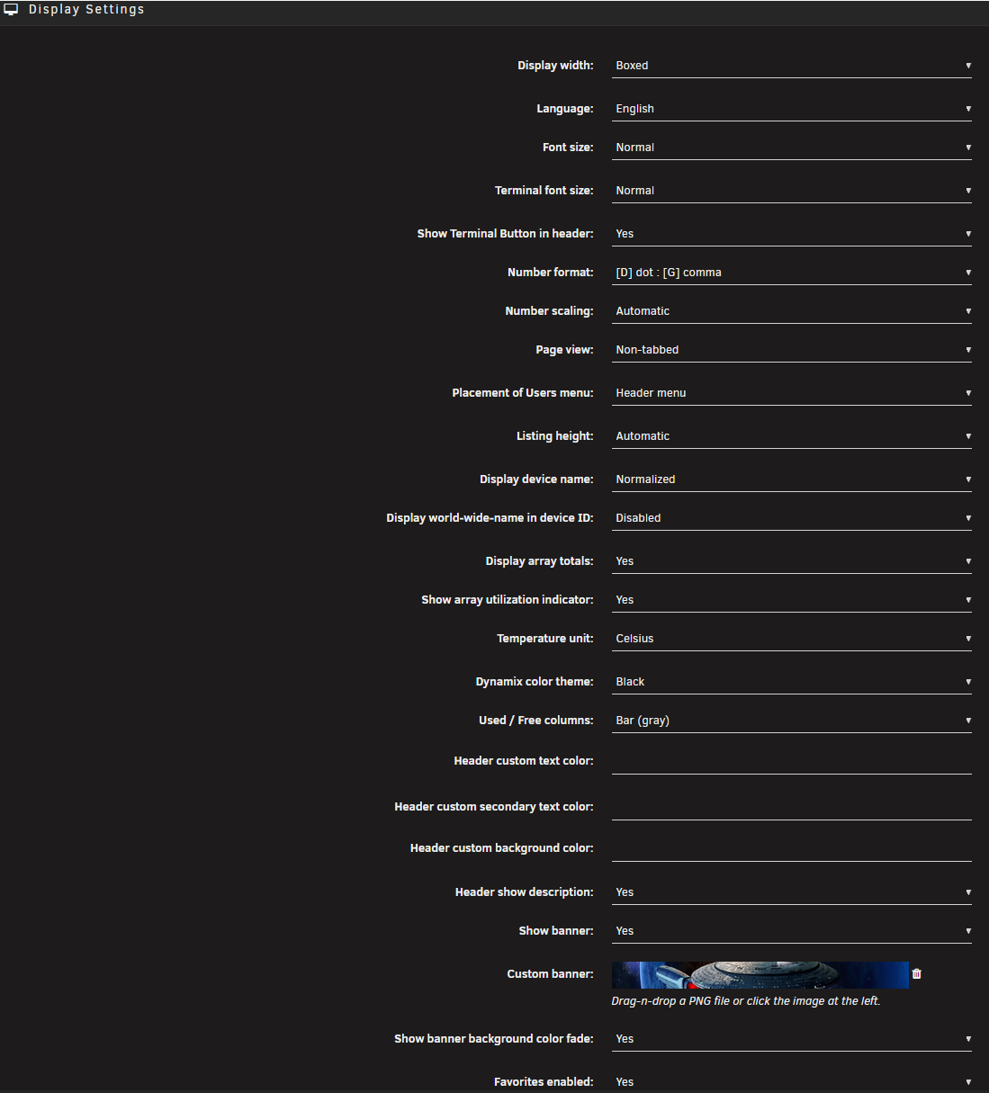

Do you have custom colors. What we found the last time is that while installing and there is no custom colors (meaning defaults), then it failed. But if you had it it worked when installing. I don't know if it is the same error now, but the same behaviour as you describe (can't reproduce it), we also saw back then: But @Mainfrezzer managed to reproduce it back then, by removing the default color, and then installing the connect plugin again.

Are you using the same display settings? Because this matters. The last time I think the error was only on the dark theme: And under certain conditions. It seams the error has reverted back to that. I can see if I can find the original thread where it was discovered what happened.- Unraid Connect breaks the header background color fade feature (Returned bug - almost the same)

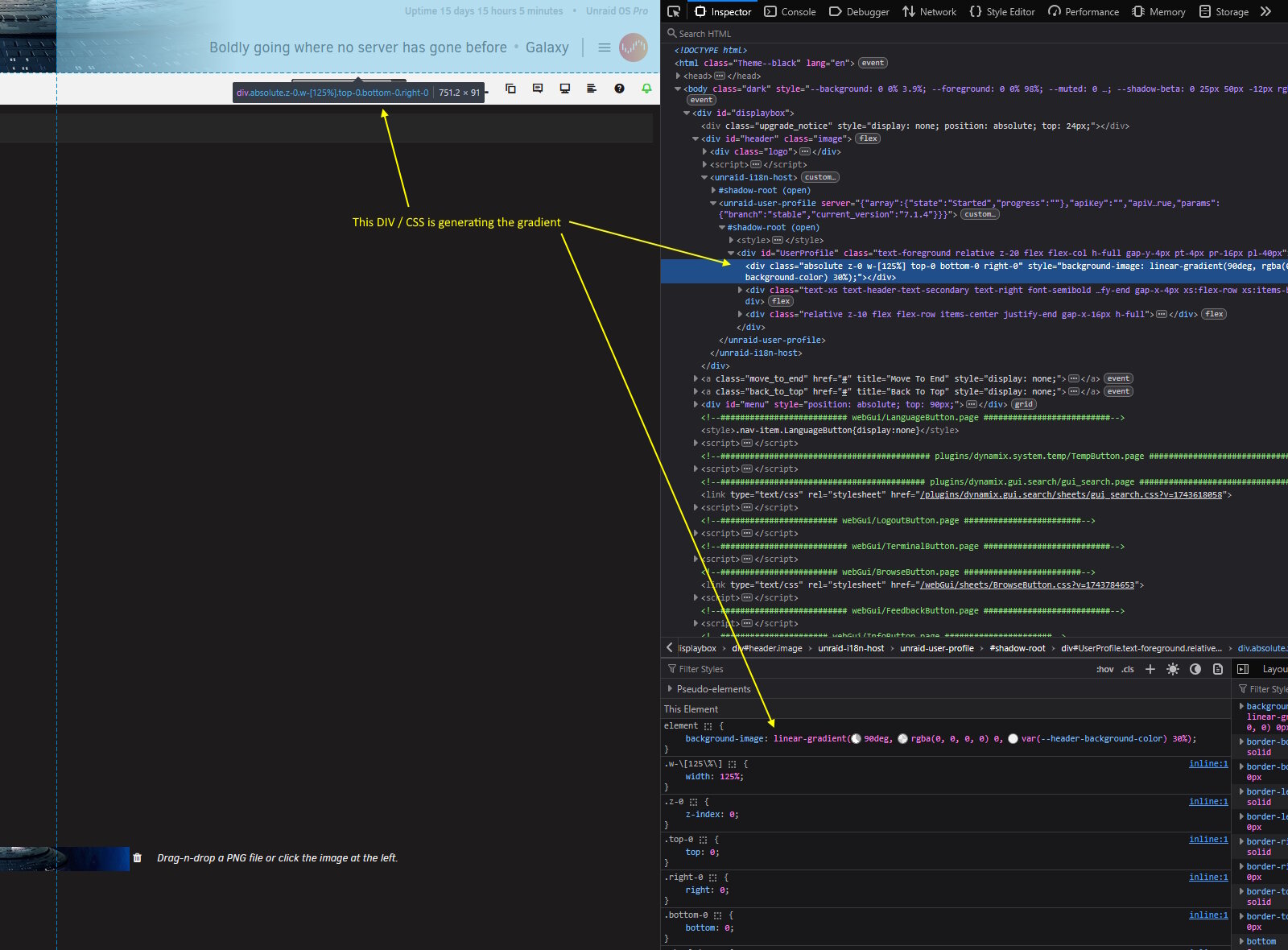

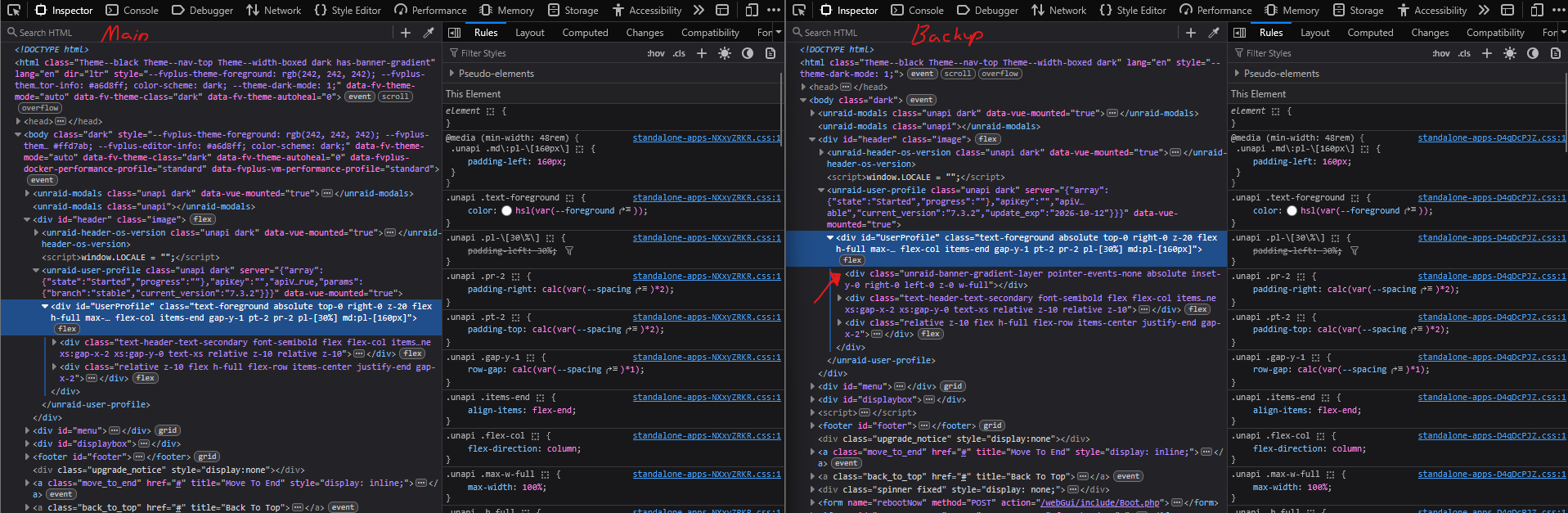

Main server on the left, Backup server on the right. Main is updated and gradient is not showing. Backup is not updated, and gradient is showing. It has an extra div, as the red arrow shows - that is not present on the updated server. That Div is the gradient.- Unraid Connect breaks the header background color fade feature (Returned bug - almost the same)

@JorgeB @elibosley This bug is back after updating Unraid Connect to "2026.08.12.1944" Today. My backup server is on "2026.06.18.1729" and it does not have the problem. Both run Unraid 7.3.2- Unraid Connect breaks the header background color fade feature (Returned bug - almost the same)
This seams to work now - as far as I can see.- Unraid Connect breaks the header background color fade feature (Returned bug - almost the same)

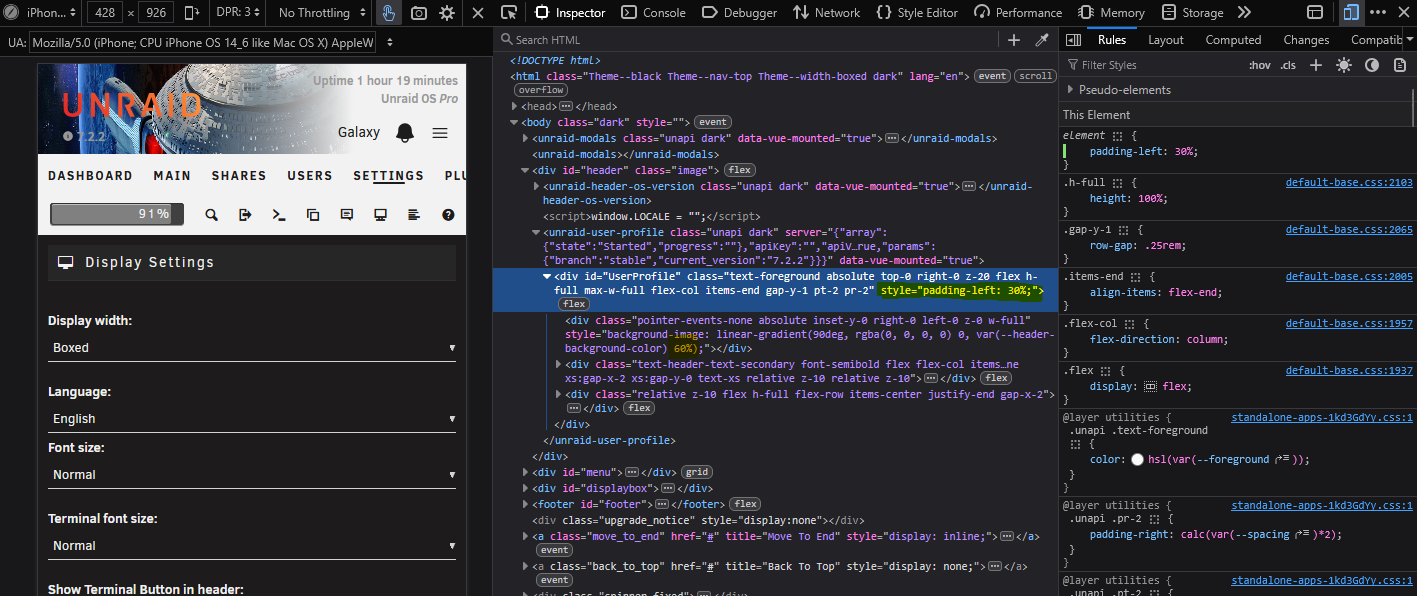

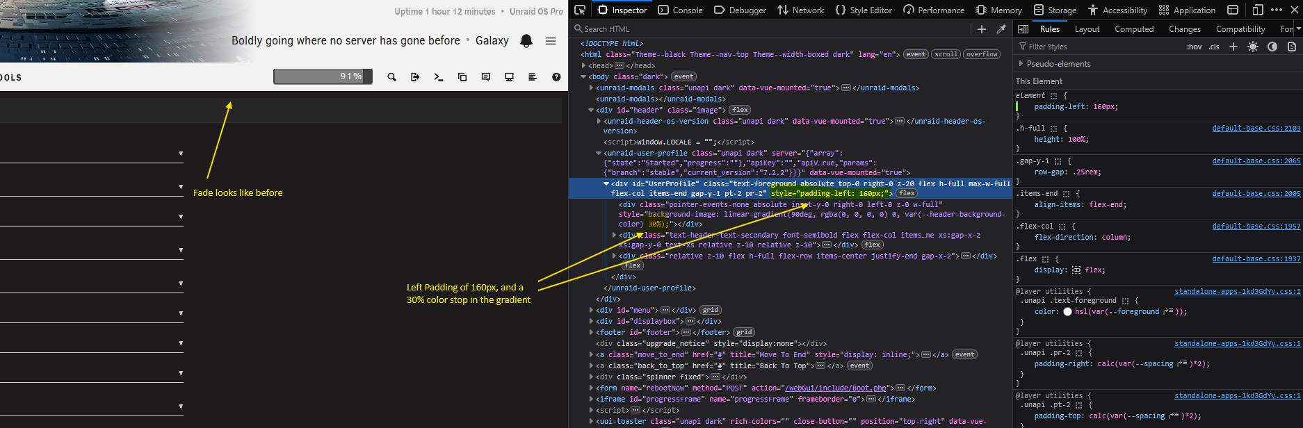

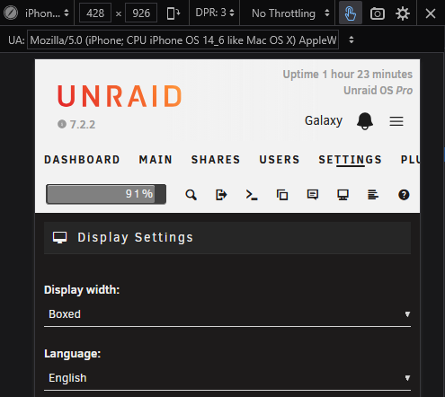

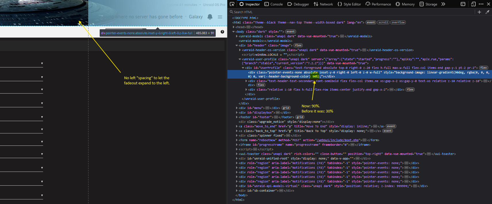

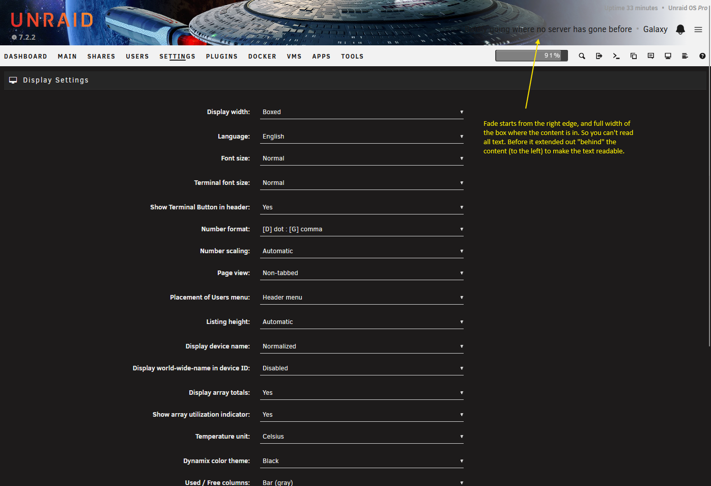

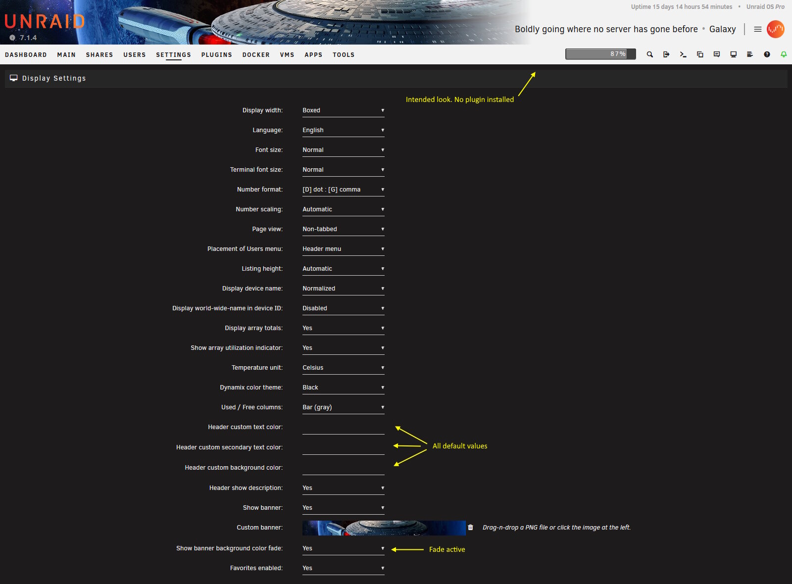

I uninstalled Unraid Connect previously, because I didn't like this bug - it looked too broken. I deliberately waited to install Unraid 7.2.2 because I had hoped this would be fixed, after a few bug fixing rounds. But unfortunately It is still not fixed 😞 - It got worse actually, because now it is also broken even without the Unraid Connect plugin installed. Yes, there is a fade now - at least 😉, but it is obviously not the intended look. I have added a screenshot of how it looks here: The color stop in the gradient is now 90% whereas it was before 30%. Also there is no spacing to the left: I messed around in the Firefox inspector and got it to kind of look similar as before, by adding a style of "padding-left: 160px" to the UserProfile div, and then setting the color stop to 30% as before. It works - in desktop, but it breaks in "responsive mode" (I have no idea how many breakpoints you have). So in "responsive mode", you could run with something like: "padding-left: 30%" on the UserProfile div, and then set the color stop to around 60%. This is just me doing some quick hacking, but it could work like that. Another idea. Maybe turn off the background image in responsive mode - by default, and then have a new option to preserve background image on responsive, or even better have a custom responsive image for that 🤩. Example with the image off: Hope this bug gets fixed soon. You tend to look at this interface quite often, and it is just an eye sore - and looks so broken. As as UX designer, I hope you also prioritize visual stuff like this 🙂 Thanks!- Unraid Connect breaks the header background color fade feature (Returned bug - almost the same)

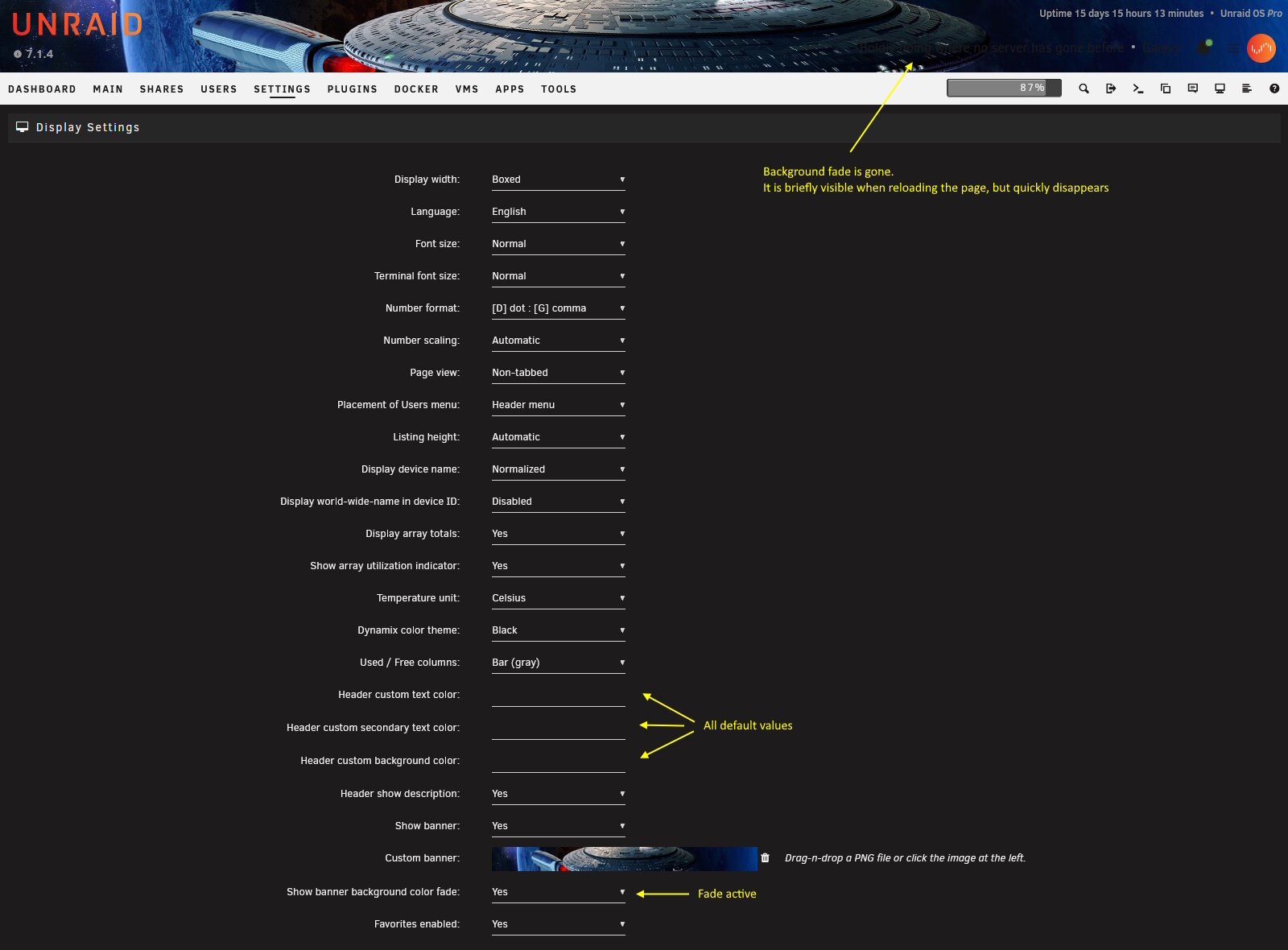

Hey This bug "seems to be back". Reference to the previous thread: https://forums.unraid.net/topic/186992-unraid-connect-breaks-default-css-of-header/#findComment-1576801 I posted there first, but I am opening a new thread since the behavior is a bit different now I found. Summary Installing the Unraid Connect plugin while having no custom colors set removes the header fade. The setting Display Settings -> “Show banner background color fade” has no effect. Expected With no custom colors and "Show banner background color fade" = Yes, the header shows the gradient fade based on the default theme color. Actual The fade is missing. On reload, the gradient appears for a split second, then disappears. In DevTools the child element that renders the gradient is present when the plugin is not installed, but is removed from the DOM once Unraid Connect is installed and the page finishes loading. In contrast to the old bug, the theme color variable now resolve to a value (with a slightly different name). So the issue is not a missing CSS variable like before, but that the gradient container div is gone after the plugin initializes - at least that is what I figured out. Screenshots Working (no plugin) - 2 Screenshots: Gradient element present with inline background-image: linear-gradient(...) on the absolute child. Broken (plugin installed) - 2 Screenshots: That gradient element is missing from the HTML. Steps to reproduce Settings -> Display Theme: Black Ensure no custom colors are set Set “Show banner background color fade” = Yes Install Unraid Connect Refresh Result: header fade is gone. Browsers tested: Chrome and Firefox Notes Setting Header custom background color does not restore the fade, like in the old bug. It looks like Unraid Connect is rewriting the header markup and dropping the gradient container. If needed I can provide a a short screen recording?- Unraid Connect breaks default css of header

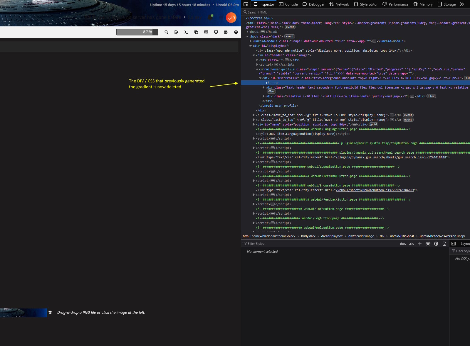

@pujitm This bug has returned :( It seems to me that the div that had the gradient background before, is simply just deleted now? You see it briefly when reloading the page, and then it disappears.- [Support] ich777 - AMD Vendor Reset, CoralTPU, hpsahba,...
