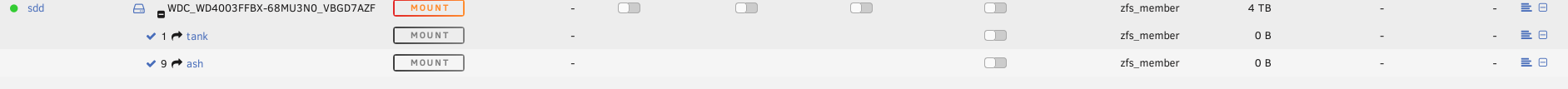

  6. Did it, and the pool was successfully imported and shows fine on FreeNAS. The only thing is.. it is empty. Before this (yesterday, before even creating the topic) I tried 'recreating' the pool in Unraid as a part of rebuilding the pool inside. Using the same name. Is it possible that I may have fucked up the data inside the drive, even if only recreating the zpool this way? It should be noted that I got it to work earlier this week. I could see my files in unraid. The only thing is.. I didn't have the drive to transfer all my data by then.
  7. Of course I am doing that hehe sorry if it looked as I literally pasted the command I think I may have fucked up somehow I just don't know how or why
  8. Doing so gives me It there any other way to mount that drive? This is the UD menu, with its pools showed when expanded.
  9. Hello, I am running into a simple problem, yet I won't be trying anything that might damage the disk I am trying to get data from. I have backups, but recovering data would take me weeks with my current connection. I am coming from FreeNAS, with a 4TB ZFS formatted drive. I got a new 4TB drive, which is already formatted in XFS and ready to get that data. Problem is: I forgot to 'export' my zpool on the FreeNAS system before, well, formatting it to install unRaid. As so, the 'zpool import' command does not work, and I am unsure on how to properly mount the ZFS drive to retrieve the data. That HDD will be properly formatted and added to the array when the transfer is done. I got this far, but pressing 'mount' won't properly mount the drive. What should I do to retrieve that data?
