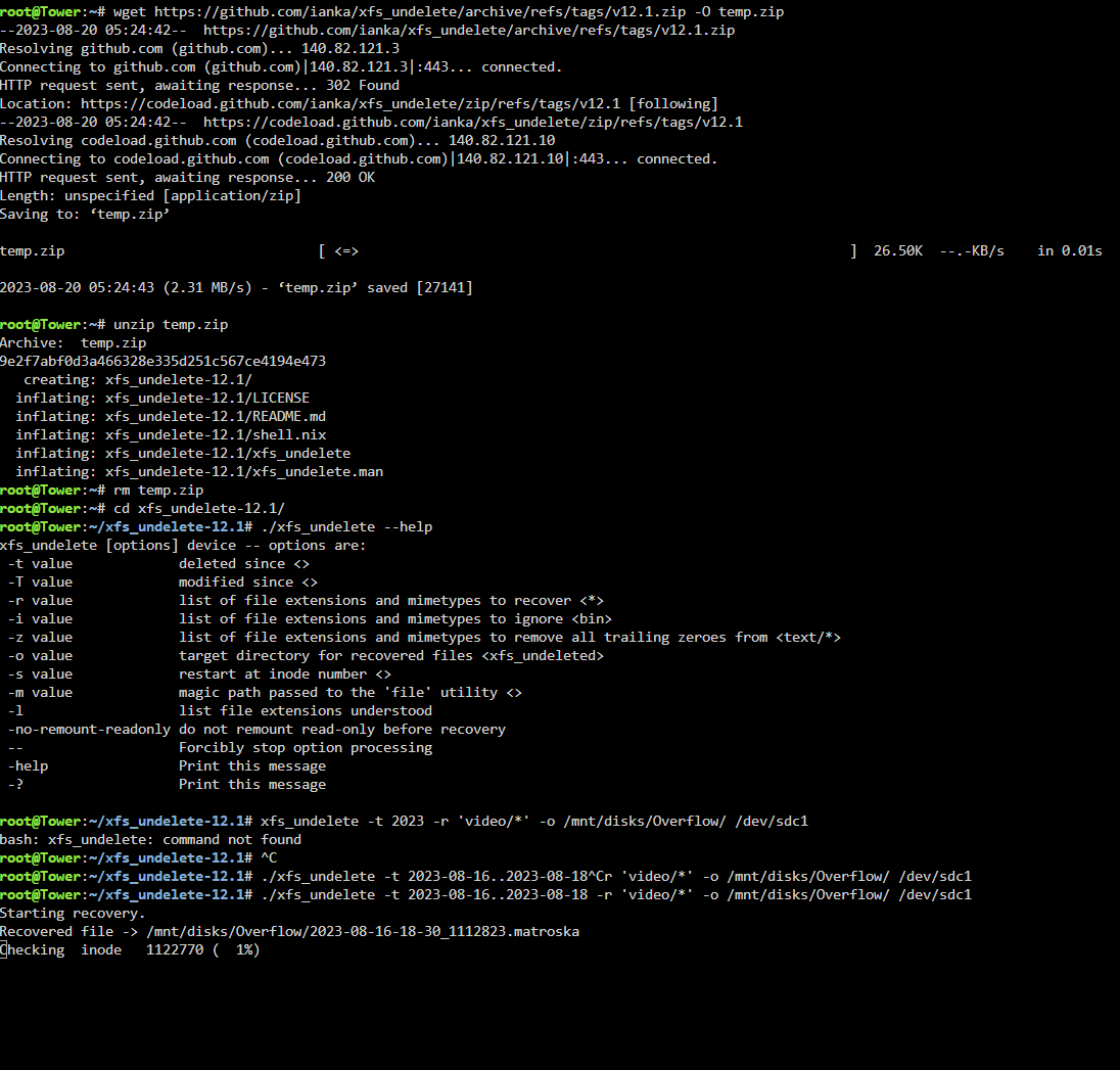

January 22, 20233 yr On 1/11/2022 at 2:24 PM, Advice said: Hey, can you give more details on how exactly you installed `xfs_undelete`? I've installed the nerd pack and tcl + tclib, but I don't know how to actually add in `xfs_undelete` to my Unraid server. 1. SSH into your Unraid (or access the terminal from the ">_" icon in the upper right hand of the GUI) 2. I used wget to get the file (I installed it in my "/etc/" folder) wget https://github.com/ianka/xfs_undelete/archive/refs/tags/v12.0.zip -O temp.zip unzip temp.zip rm temp.zip cd xfs_undelete-12.0/ ./xfs_undelete --help They should get you going. I'm doing a recovery as I type this Good luck with yours! Edited January 22, 20233 yr by richardoswald

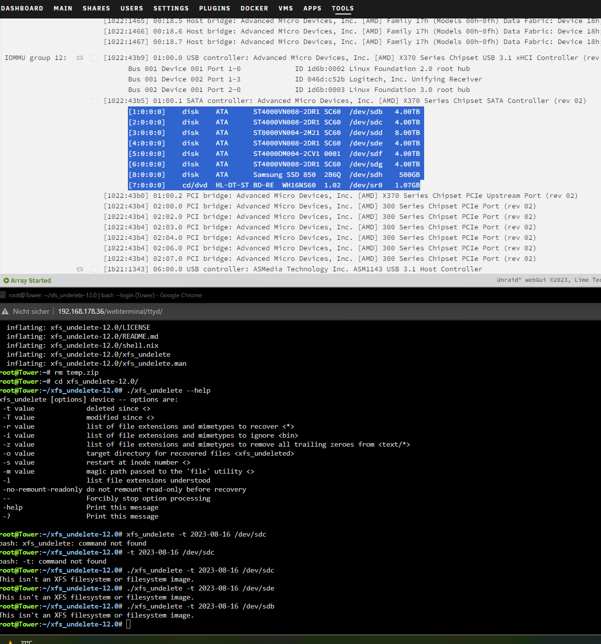

August 18, 20233 yr On 1/22/2023 at 7:04 AM, richardoswald said: 1. SSH into your Unraid (or access the terminal from the ">_" icon in the upper right hand of the GUI) 2. I used wget to get the file (I installed it in my "/etc/" folder) wget https://github.com/ianka/xfs_undelete/archive/refs/tags/v12.0.zip -O temp.zip unzip temp.zip rm temp.zip cd xfs_undelete-12.0/ ./xfs_undelete --help They should get you going. I'm doing a recovery as I type this Good luck with yours! Hey, any pointers on what to do ? I was was moving some videos around, after which i routinely deleted the then empty folders. At 03:30AM I must have accidentaly selected the parent folder and pressed delete. I noticed immidiatly and canceled the deletion but lost 3tb in movies. BtW there was a parity check running. I shut down my server and removed each of the 5 disks. I tried to recover the files with UFS Explorer Standard Recovery but only found empty folders. The cause may be that the movie folder is in a share which has all five disks included. Now i put the disks back in my server and am trying to get it to work with XFS_undelete. I don't seem to get the command right. This is the best i can make from the instructions: ./xfs_undelete -t 2023-08-16..2023-08-18/dev/sdc I also want the restored files to be written to an unnasigned device which i plugged in to the server so: -o/mnt/disks/Overflow/dev/sdc do i type this in the same line?Like: ./xfs_undelete -t 2023-08-16..2023-08-18/dev/sdc -o/mnt/disks/Overflow /dev/sdc Obviously i am rather unexperienced using Commandline so any help will be grately appreciated. Edited August 18, 20233 yr by Wesiwestside afterthought
August 19, 20233 yr 1 hour ago, Wesiwestside said: Hey, any pointers on what to do ? I was was moving some videos around, after which i routinely deleted the then empty folders. At 03:30AM I must have accidentaly selected the parent folder and pressed delete. I noticed immidiatly and canceled the deletion but lost 3tb in movies. BtW there was a parity check running. I shut down my server and removed each of the 5 disks. I tried to recover the files with UFS Explorer Standard Recovery but only found empty folders. The cause may be that the movie folder is in a share which has all five disks included. Now i put the disks back in my server and am trying to get it to work with XFS_undelete. I don't seem to get the command right. This is the best i can make from the instructions: ./xfs_undelete -t 2023-08-16..2023-08-18/dev/sdc I also want the restored files to be written to an unnasigned device which i plugged in to the server so: -o/mnt/disks/Overflow/dev/sdc do i type this in the same line?Like: ./xfs_undelete -t 2023-08-16..2023-08-18/dev/sdc -o/mnt/disks/Overflow /dev/sdc Obviously i am rather unexperienced using Commandline so any help will be grately appreciated. root@Tower:~# ^[[200~wget https://github.com/ianka/xfs_undelete/archive/refs/tags/v12.0.zip -O temp.zip ~ bash: $'\E[200~wget': command not found root@Tower:~# wget https://github.com/ianka/xfs_undelete/archive/refs/tags/v12.0.zip -O temp.zip --2023-08-18 15:35:20-- https://github.com/ianka/xfs_undelete/archive/refs/tags/v12.0.zip Resolving github.com (github.com)... 140.82.121.4 Connecting to github.com (github.com)|140.82.121.4|:443... connected. HTTP request sent, awaiting response... 302 Found Location: https://codeload.github.com/ianka/xfs_undelete/zip/refs/tags/v12.0 [following] --2023-08-18 15:35:20-- https://codeload.github.com/ianka/xfs_undelete/zip/refs/tags/v12.0 Resolving codeload.github.com (codeload.github.com)... 140.82.121.10 Connecting to codeload.github.com (codeload.github.com)|140.82.121.10|:443... connected. HTTP request sent, awaiting response... 200 OK Length: unspecified [application/zip] Saving to: ‘temp.zip’ temp.zip [ <=> ] 26.44K --.-KB/s in 0.01s 2023-08-18 15:35:21 (2.26 MB/s) - ‘temp.zip’ saved [27076] root@Tower:~# unzip temp.zip Archive: temp.zip 4c15e5763e1c560b0b6c8dbdc5f1b06d1530d3fc creating: xfs_undelete-12.0/ inflating: xfs_undelete-12.0/LICENSE inflating: xfs_undelete-12.0/README.md inflating: xfs_undelete-12.0/shell.nix inflating: xfs_undelete-12.0/xfs_undelete inflating: xfs_undelete-12.0/xfs_undelete.man root@Tower:~# rm temp.zip root@Tower:~# cd xfs_undelete-12.0/ root@Tower:~/xfs_undelete-12.0# ./xfs_undelete --help xfs_undelete [options] device -- options are: -t value deleted since <> -T value modified since <> -r value list of file extensions and mimetypes to recover <*> -i value list of file extensions and mimetypes to ignore <bin> -z value list of file extensions and mimetypes to remove all trailing zeroes from <text/*> -o value target directory for recovered files <xfs_undeleted> -s value restart at inode number <> -m value magic path passed to the 'file' utility <> -l list file extensions understood -no-remount-readonly do not remount read-only before recovery -- Forcibly stop option processing -help Print this message -? Print this message root@Tower:~/xfs_undelete-12.0# xfs_undelete -t 2023-08-16 /dev/sdc bash: xfs_undelete: command not found root@Tower:~/xfs_undelete-12.0# -t 2023-08-16 /dev/sdc bash: -t: command not found root@Tower:~/xfs_undelete-12.0# ./xfs_undelete -t 2023-08-16 /dev/sdc This isn't an XFS filesystem or filesystem image. root@Tower:~/xfs_undelete-12.0# ./xfs_undelete -t 2023-08-16 /dev/sde This isn't an XFS filesystem or filesystem image. root@Tower:~/xfs_undelete-12.0# ./xfs_undelete -t 2023-08-16 /dev/sdb This isn't an XFS filesystem or filesystem image. root@Tower:~/xfs_undelete-12.0# ./xfs_undelete -t 2023-08-16/dev/sdc Unable to parse time range. Please put it as a range of time specs Tcl's [clock scan] can understand, e.g. 2022-06-04..-2hours. A single value as -2hours is considered the same as a range -2hours..now. root@Tower:~/xfs_undelete-12.0# ./xfs_undelete -t 2023-08-16../dev/sdc Unable to parse time range. Please put it as a range of time specs Tcl's [clock scan] can understand, e.g. 2022-06-04..-2hours. A single value as -2hours is considered the same as a range -2hours..now. root@Tower:~/xfs_undelete-12.0# ./xfs_undelete -t 2023-08-16/dev/sdc -o/mnt/external_harddisk/dev/sdi xfs_undelete [options] device -- options are: -t value deleted since <> -T value modified since <> -r value list of file extensions and mimetypes to recover <*> -i value list of file extensions and mimetypes to ignore <bin> -z value list of file extensions and mimetypes to remove all trailing zeroes from <text/*> -o value target directory for recovered files <xfs_undeleted> -s value restart at inode number <> -m value magic path passed to the 'file' utility <> -l list file extensions understood -no-remount-readonly do not remount read-only before recovery -- Forcibly stop option processing -help Print this message -? Print this message root@Tower:~/xfs_undelete-12.0# -o/mnt/external_harddisk/dev/sdi bash: -o/mnt/external_harddisk/dev/sdi: No such file or directory root@Tower:~/xfs_undelete-12.0# ./xfs_undelete -o/mnt/external_harddisk/dev/sdi xfs_undelete [options] device -- options are: -t value deleted since <> -T value modified since <> -r value list of file extensions and mimetypes to recover <*> -i value list of file extensions and mimetypes to ignore <bin> -z value list of file extensions and mimetypes to remove all trailing zeroes from <text/*> -o value target directory for recovered files <xfs_undeleted> -s value restart at inode number <> -m value magic path passed to the 'file' utility <> -l list file extensions understood -no-remount-readonly do not remount read-only before recovery -- Forcibly stop option processing -help Print this message -? Print this message root@Tower:~/xfs_undelete-12.0# ./xfs_undelete -t 2023-08-16..2023-08-18/dev/sdc -o/mnt/external_harddisk/dev/sdi xfs_undelete [options] device -- options are: -t value deleted since <> -T value modified since <> -r value list of file extensions and mimetypes to recover <*> -i value list of file extensions and mimetypes to ignore <bin> -z value list of file extensions and mimetypes to remove all trailing zeroes from <text/*> -o value target directory for recovered files <xfs_undeleted> -s value restart at inode number <> -m value magic path passed to the 'file' utility <> -l list file extensions understood -no-remount-readonly do not remount read-only before recovery -- Forcibly stop option processing -help Print this message -? Print this message root@Tower:~/xfs_undelete-12.0# ./xfs_undelete -t 2023-08-16..2023-08-18/dev/sdc Unable to parse time range. Please put it as a range of time specs Tcl's [clock scan] can understand, e.g. 2022-06-04..-2hours. A single value as -2hours is considered the same as a range -2hours..now. root@Tower:~/xfs_undelete-12.0# ./xfs_undelete -t 2023-08-16..-6hours/dev/sdc Unable to parse time range. Please put it as a range of time specs Tcl's [clock scan] can understand, e.g. 2022-06-04..-2hours. A single value as -2hours is considered the same as a range -2hours..now. root@Tower:~/xfs_undelete-12.0# ./xfs_undelete -t -96hours/dev/sdc Unable to parse time range. Please put it as a range of time specs Tcl's [clock scan] can understand, e.g. 2022-06-04..-2hours. A single value as -2hours is considered the same as a range -2hours..now. root@Tower:~/xfs_undelete-12.0# ./xfs_undelete -o/mnt/disks/Overflow/dev/sdc xfs_undelete [options] device -- options are: -t value deleted since <> -T value modified since <> -r value list of file extensions and mimetypes to recover <*> -i value list of file extensions and mimetypes to ignore <bin> -z value list of file extensions and mimetypes to remove all trailing zeroes from <text/*> -o value target directory for recovered files <xfs_undeleted> -s value restart at inode number <> -m value magic path passed to the 'file' utility <> -l list file extensions understood -no-remount-readonly do not remount read-only before recovery -- Forcibly stop option processing -help Print this message -? Print this message root@Tower:~/xfs_undelete-12.0# ./xfs_undelete -t -96hours../dev/sdc Unable to parse time range. Please put it as a range of time specs Tcl's [clock scan] can understand, e.g. 2022-06-04..-2hours. A single value as -2hours is considered the same as a range -2hours..now. root@Tower:~/xfs_undelete-12.0# ./xfs_undelete -t -96hours../dev/sdc Unable to parse time range. Please put it as a range of time specs Tcl's [clock scan] can understand, e.g. 2022-06-04..-2hours. A single value as -2hours is considered the same as a range -2hours..now. root@Tower:~/xfs_undelete-12.0# ./xfs_undelete -t 6hours../dev/sdc Unable to parse time range. Please put it as a range of time specs Tcl's [clock scan] can understand, e.g. 2022-06-04..-2hours. A single value as -2hours is considered the same as a range -2hours..now. root@Tower:~/xfs_undelete-12.0# ./xfs_undelete -t <-96hours..>/dev/sdc bash: -96hours..: No such file or directory root@Tower:~/xfs_undelete-12.0# ./xfs_undelete -t 2023-08-16 -r 'video/*' -o /mnt/disks/Overflow/xfs_undeleted/ /dev/sdc This isn't an XFS filesystem or filesystem image. root@Tower:~/xfs_undelete-12.0# ./xfs_undelete -t 2023-08-16 -r 'video/*' -o /mnt/disks/Overflow/ /dev/sdc This isn't an XFS filesystem or filesystem image. root@Tower:~/xfs_undelete-12.0# ./xfs_undelete -t 2023-08-16 -r 'video/*' -o /mnt/disks/Overflow//dev/sdc Please specify a block device or an XFS filesystem image. root@Tower:~/xfs_undelete-12.0# ./xfs_undelete -t 2023-08-16..2023-08-18 -r 'video/*' -o /mnt/disks/Overflow/dev/sdc Please specify a block device or an XFS filesystem image. root@Tower:~/xfs_undelete-12.0# ./xfs_undelete -t 2023-08-16..2023-08-18 Please specify a block device or an XFS filesystem image. root@Tower:~/xfs_undelete-12.0# ./xfs_undelete -t 2023-08-16..2023-08-18/dev/sdc Unable to parse time range. Please put it as a range of time specs Tcl's [clock scan] can understand, e.g. 2022-06-04..-2hours. A single value as -2hours is considered the same as a range -2hours..now. root@Tower:~/xfs_undelete-12.0# ./xfs_undelete -t 2023-16-08..2023-18-08/dev/sdc Unable to parse time range. Please put it as a range of time specs Tcl's [clock scan] can understand, e.g. 2022-06-04..-2hours. A single value as -2hours is considered the same as a range -2hours..now. root@Tower:~/xfs_undelete-12.0# ^C root@Tower:~/xfs_undelete-12.0# xfs_undelete -t 2023-08-16 -r 'video/*' -o /mnt/disks/Overflow/xfs_undeleted/ /dev/sdc bash: xfs_undelete: command not found root@Tower:~/xfs_undelete-12.0# Im looking into installing the GNU Coreutils now.
August 19, 20233 yr I think you want to run this on the unraid device such as /dev/md# so you're doing it on the drives inside the parity protected array. If you run it on /dev/sdx#/ then you are invalidating the parity since you are writing below the devicemapper. Also, you need to run it on a partition, such as /dev/sdc1 (first partition). Specifying /dev/sdc is for the entire drive. That is why it can't find any valid filesystems.. The /dev/md# syntax may have changed on 6.12 unraid versions for ZFS tomfoolery, so check what the right device name is. I'm still on 6.11 where it's /dev/md1 for first partition of the first drive in the array. Only use /dev/sdX1 if you are recovering to another drive. Edited August 19, 20233 yr by BRiT

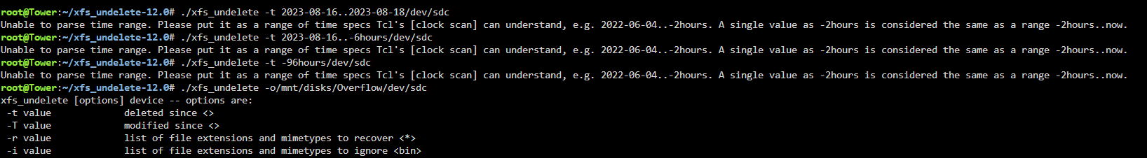

August 19, 20233 yr Firstly thanks a lot. like this? I still don't get whats wrong with my time range input. Is the md# part supposed to point to the whole array? Couldn't figur out where to get the info? My best guess was System devices. Where does it say on your system? Well it seems to be working. Edited August 20, 20233 yr by Wesiwestside
