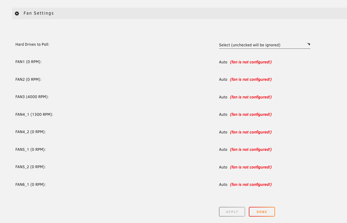

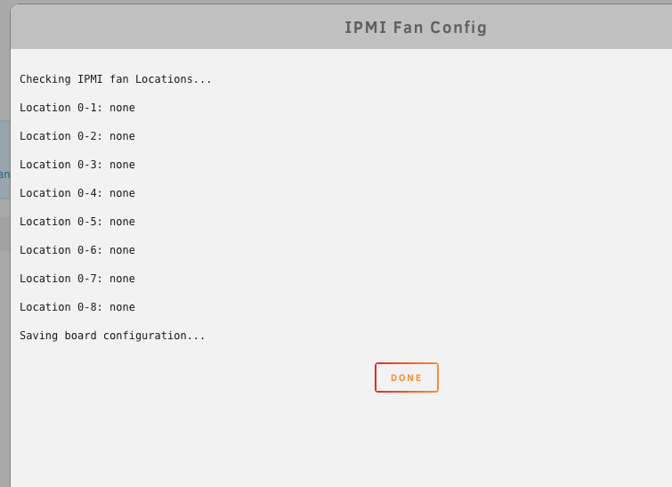

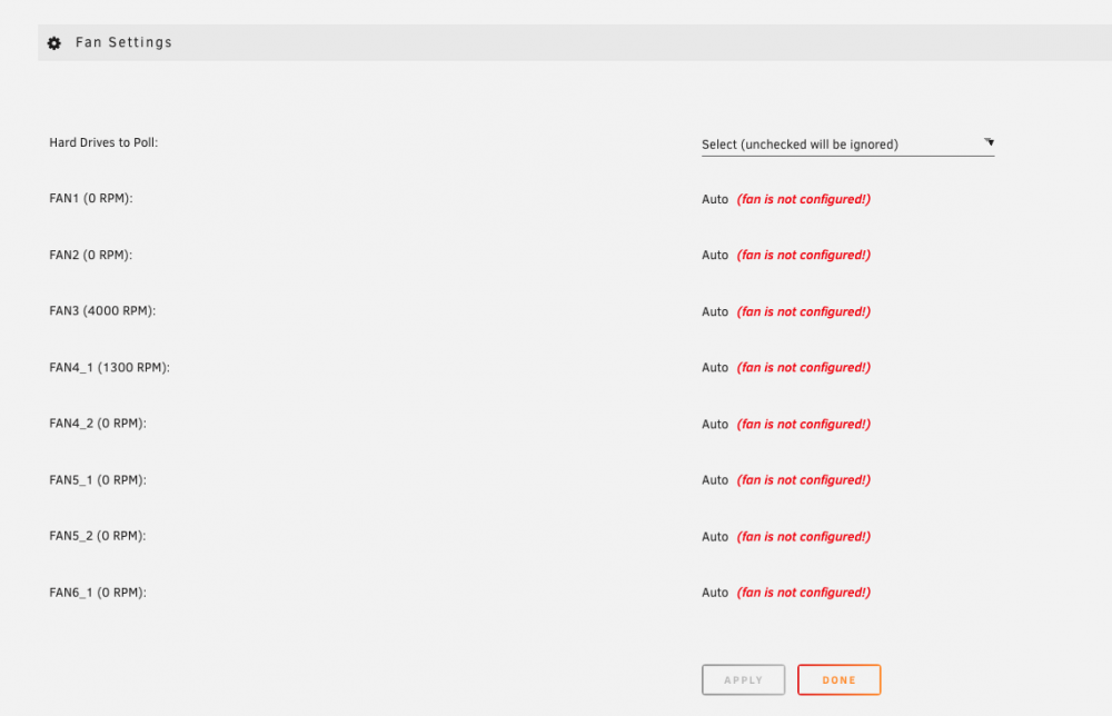

  13. Maybe try ipmitool. Could be a freeipmi problem. Also is the bmc firmware up to date. Yeah tried that with the same results, well the thing is, this is a brand new board and I dont have any drivers to downloads at the Asrock website: https://www.asrockrack.com/general/productdetail.asp?Model=X570D4U#Specifications Never had a BMC board before, is updating the firmware on the BMC wise if not specified by the manufacturer? Might also help to see the output of the sensors and the fans: root@tower:~# ipmisensors -t fan ID | Name | Type | Reading | Units | Event 25 | FAN1 | Fan | 400.00 | RPM | 'OK' 26 | FAN2 | Fan | 4100.00 | RPM | 'OK' 27 | FAN3 | Fan | 1300.00 | RPM | 'OK' 28 | FAN4_1 | Fan | 4000.00 | RPM | 'OK' 29 | FAN4_2 | Fan | N/A | RPM | N/A 30 | FAN5_1 | Fan | N/A | RPM | N/A 31 | FAN5_2 | Fan | N/A | RPM | N/A 32 | FAN6_1 | Fan | N/A | RPM | N/A 33 | FAN6_2 | Fan | N/A | RPM | N/A Fans 4 to 6 have that split, I wonder if that causes some huge difference. Those are 6 pin fan connectors that can be used as 2x3 pin connectors.
  14. Yeah I've tried the dual CPU commands and no results. Yeah all Noctua PWM fans. Here is the output of trying to send the command via the terminal: root@tower:~# ipmi-raw 00 3a 01 00 00 00 00 00 00 00 00 --debug ===================================================== OEM - Unknown Request ===================================================== [ HEX DUMP ..... ] = HEX[ 9B] [ 01h 00h 00h 00h 00h 00h 00h 00h ] [ 00h ] ===================================================== OEM - Unknown Response ===================================================== [ HEX DUMP ..... ] = HEX[ 2B] [ 01h C1h ] rcvd: 01 C1 Looks like the controller is not recognizing it as a valid request.
