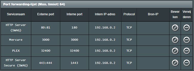

  7. @ljm42 , Thanks for the reply! Your solution has worked, had to forward it twice.... i'm going to ask my ISP for a modem-only solution since i cant put their router-modem in bridge mode! Thanks for pointing me in the good direction!
  8. Ok so far not much progress.. The portforwarding seems to work cause i can vpn through my unraid server again, however swag does not revesere proxy my containers (nextcloud, vaultwarden, etc etc) any idea how i could debug this ?
  9. @MAM59, thanks for the reply! Seems the port forwarding worked now (can see them open at canyouseemee) but still can't acces my docker containers. Gonna look abit more into this, keep you posted on the result.
  10. Dear, I'm having troubles setting up the new router with port forwarding, those might not be so much of an unraid issue but didn't know where to ask. I'm using unraid with SWAG, to make some unraid containers accessible from the outside. This used to work flawless on my first setup which was a router and modem in one machine (by my provider) and some port forwarding. I recently installed a new router, setup the port forwarding on that one, but i can't seem to be able to connect to any ports. See the specs below. MODEM: Telenet DOCSIS 3.1 WIRELESS Lan ip: 192.168.1.1 Wan ip: 84.195.xxx.xxx Router: Asus RT-AX89X Lan ip: 192.168.0.1 (Different subnet) Wan ip: 192.168.1.201 Unraid IP: 192.168.0.2 I currently only use the modem to get my internet connection and then route the modem to my router for the port forwarding (192.168.1.1 -> 192.168.0.1) Can anyone please point me in the right direction. If needed more info feel free to ask, hope some one can help me since networking is not my strong suite. Kind regards

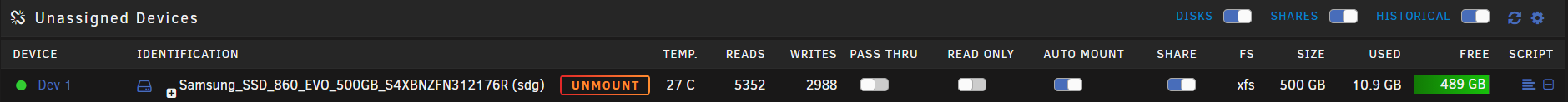

  11. Yes, got a Samsung EVO 860 where i store my plex appdata and do the transcoding. See the attachment ^^, but since you mention BTRFS... whats the difference and why should i format it like that ?
  12. Hmm i see, in my case it was the formatting of my plex cache ssd in unraid, fomated it to NTFS first but that gave loads of errors while transcoding so had to switch to XFS and all started working flawless... but in this case i think i cant help sorry, this is all i know ^^
  13. Are you storing your app data in a cache drive or the unraid array ? I've had this problem before
