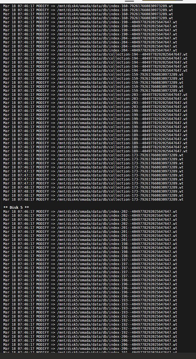

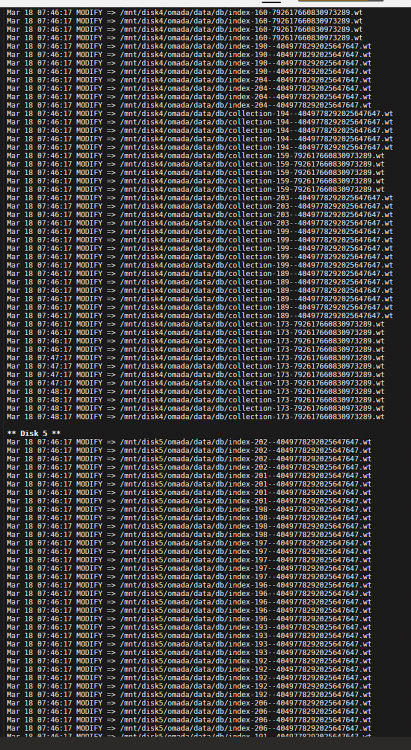

  1. Anyone having this issue where Omada is keeping all the Unraid drive from spinning down due to file activity? This happens across all my drives.

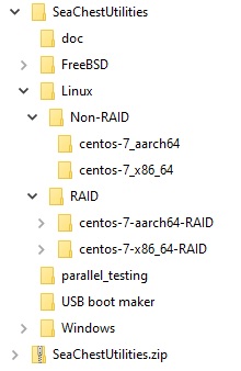

  6. Same here running on 6.9.2 with 4 Ironwolf drives. Had endless issues and was pulling out my hair until I found this fix. I applied it and have had no hassles from the Ironwolf drives again. It's been running since July with this fix.
  7. Got it working using centos-7_x86_64. Will test it out and hopefully this will fix my issues.
  8. Where can I find the older tool set or am I being an idiot and downloading the wrong SeaChest Utilities?
