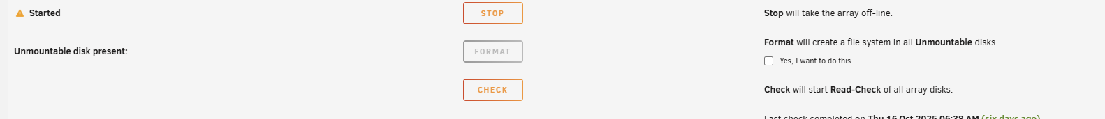

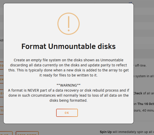

  1. After copying the data, do I format the drive? Even though it says not to? I am copying the data to the array while the disk is attached to my PC, so the data ends up on the other drives. I don't have space on my PC, so it's my only option. But this basically means that I can remove the drive and format it through Unraid to avoid having to rebuild parity, right?

  5. Did that already. Doesn't work. Same error. Is UFS Explorer the best tool? Could you provide a good guide I could follow?
  6. A drive is unmountable. Xfs_repair doesn't work. There are way too many errors, like thousands of lines of inode errors. In the end it says: xfs_repair: phase6.c:1674: longform_dir2_entry_check_data: Assertion parent != 0' failed. Even during the check, it says: No modify flag set, skipping phase 5 Inode allocation btrees are too corrupted, skipping phases 6 and 7 I have now removed the disk from the NAS and hooked it up to my PC. I am pretty sure the drive itself is fine and that the source was corruption caused by either bad power or bad SATA cable, which I have both since replaced. How do I proceed? From my research DDrescue could be helpful, though I have never used it. If it doesn't work I could pay for Rstudio or UFS. Last resort would be photorec, as it doesn't preserve file structure and names. With the free version of ddrescue I could see some files and folders, though not many, as it's very limited.
