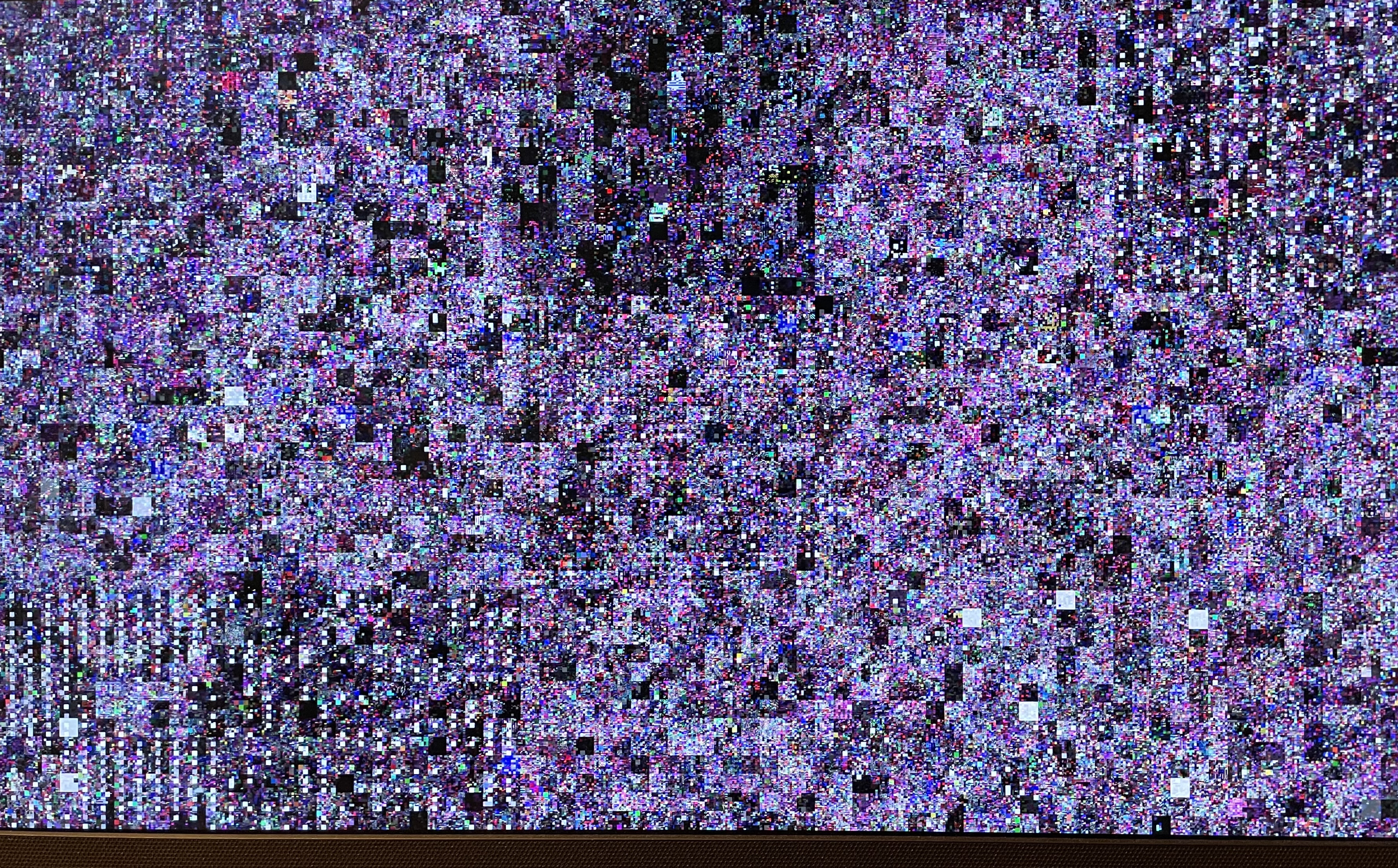

I have narrowed it down to AMD drivers which are automatically installed by Windows Update. I can "Pause Updates for 7 days" in W10, but that's like putting a bandage on a bleeding wound, doesn't do much long-term. I am looking into why this may be occurring, however also came across these posts on Reddit where people point out that it may be a driver version issue, since AMD may be detecting VMs and not allowing us to run the driver properly. For what it's worth, the mouse usually works fine and I can move it around and see it on my display, everything 'behind' the mouse (the entire W10 UI) is that garbled pixelated mess though.

I got iGPU passthrough (with audio over HDMI as well, did not test display port yet) working in a Proxmox Windows 10 VM! Seems to be limited to ~30hz refresh rate but I am investigating if AMD driver updates will fix the issue. I will test on Unraid in the coming days once I am happy with the Proxmox install. But briefly, what was key was passing the VBIOS file (latest version works fine, see file Renoir-017.010.000.028.000000.ROM from previous post), AND using a q35 machine (not default i440fx) with SeaBIOS (NOT OVMF). I will try to get it working on Unraid soon and make a guide, but will also make a guide for Proxmox for those who use PVE. Cheers!

Might be worth trying to run these commands on the Unraid server immediately upon bootup (via SSH! or userscripts plugin), and THEN starting the VM via web UI from another computer. Very important not to use unraid GUI mode or text mode at all. echo 0 > /sys/class/vtconsole/vtcon0/bind echo 0 > /sys/class/vtconsole/vtcon1/bind echo efi-framebuffer.0 > /sys/bus/platform/drivers/efi-framebuffer/unbind Also are you running the VM with SeaBIOS or OVMF? I think SeaBIOS is preferred for this type of pass-through, since the VBIOSs provided by AMD don't support UEFI firmware (which is what OVMF is).
