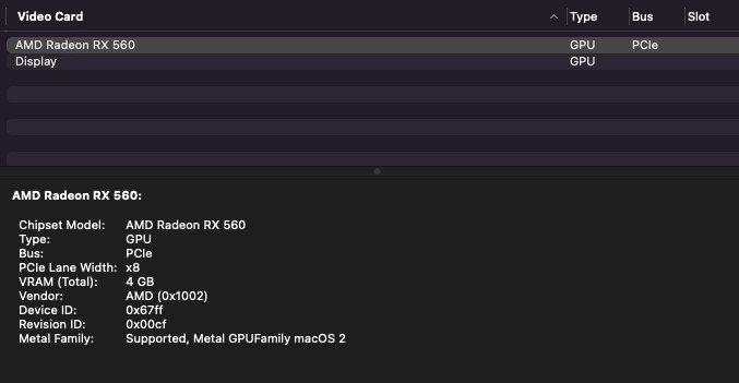

  7. Finally getting time to mess with this again. The Display listed was the QEMU display adapter, not the actual monitor itself. Turns out I just needed to update OpenCore and drop a newer version of the files into the Bootloader. It has restored my ability to use external monitors. Thanks for chiming in though! 😀

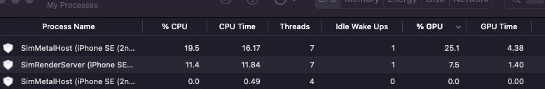

  8. Any luck on this? I chose the same MSI card as the poster above as it is listed as supported by Apple directly in an article that was last updated yesterday! I am having no luck getting the display to light up upon moving up to Monterey, worked fine in Big Sur. It's detected as a Metal supported GPU if I go into the VM via TeamViewer. Also works to accelerate iOS simulators just fine, proving it is actually using the GPU to accelerate. Makes no sense, just no display. Same as the other folks, it will show the BIOS and Apple logo until about halfway and then shut off. Has to be a bug on Apple's side. I've seen others complaining about external displays on Monterey on native Apple machines. I have an M1 Max on Monterey that works fine with the same display though. https://support.apple.com/en-us/HT202239

  14. I figured it out. I turned off Resizeable Bar in the BIOS settings of my motherboard and it started working.
