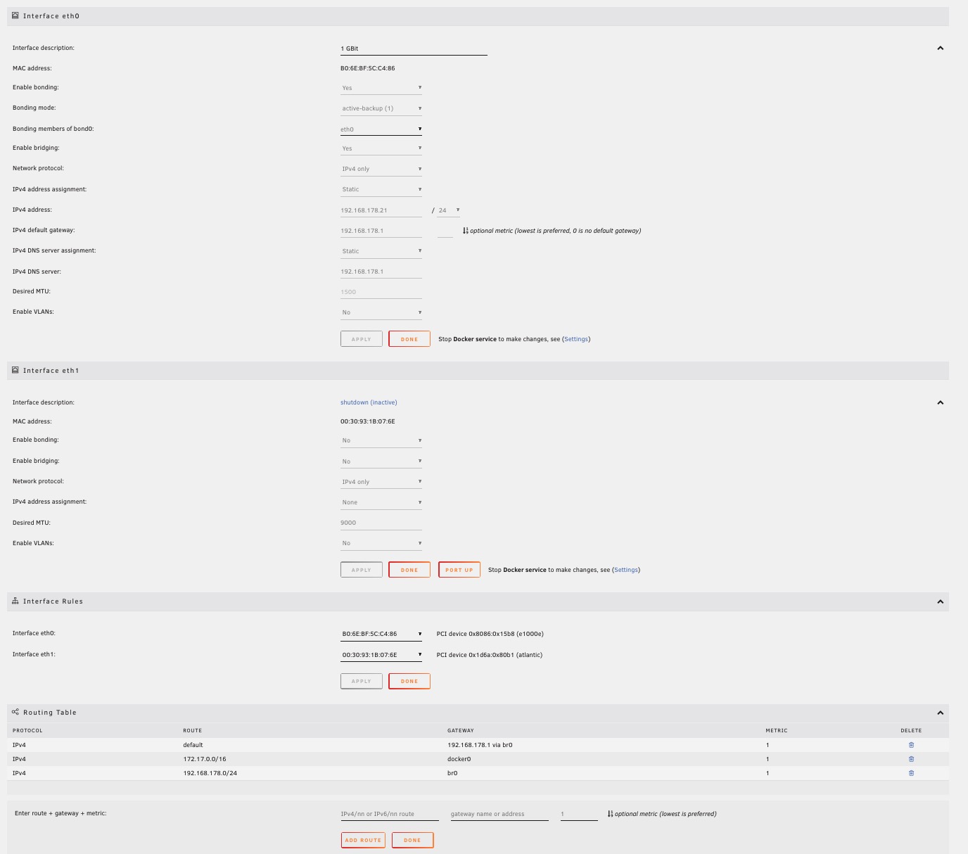

Hi there ... I added a Sonnett 10 Gbit card to my server and it shows up as eth1 in network settings. Right now I connected my Mac Pro directly with SFP+ cable to the Unraid Server (no switch). Eth0 (1 Gbit onboard) it connected to the Modem/Router. My question is: How do I have to setup the network correctly and how do I configure the two cards in order to use both connections? I do not have any network experience and tried to find some solution on the internet, but I did not find anything about this special case. Maybe there is a way to seperate the 10 Gbit net from the 1 Gbit connection for file transfer ? How can I assure to have a working remote access to Unraid after changing the configuration? And what I also do not understand (I will add a screenshot) is why (under interface eth1 under description) is there a "shutdown (inactive)". Is there a simple way to leave the eth0 as it is and use eth1 simply as a fast way to access the UNRAID server from the Mac? Any help will be gladly appreciated. Have a nice weekend ... Best wishes ... retox
