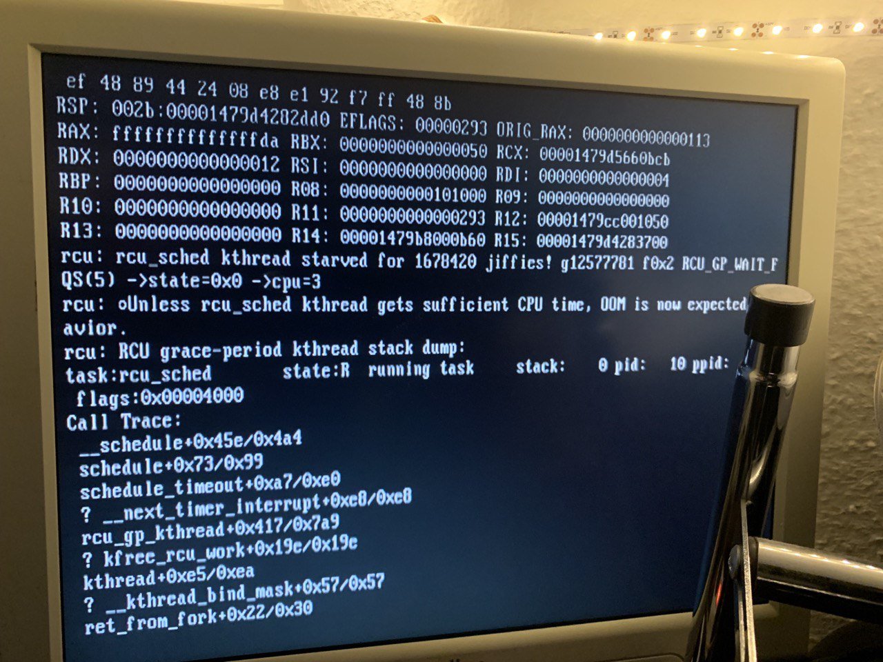

A picture of what's on the screen would also be helpful
Hi Squid,
as I said, the screen kept constantly scrolling ... here is the only photo where the screen was stuck. Do you have an advice how to log this?

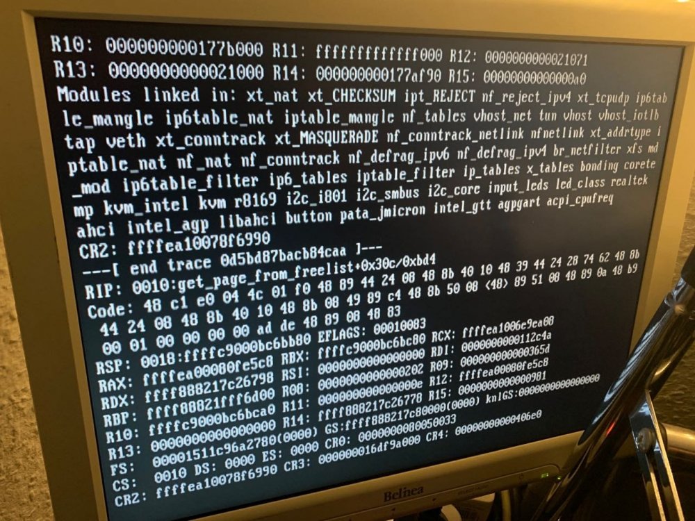

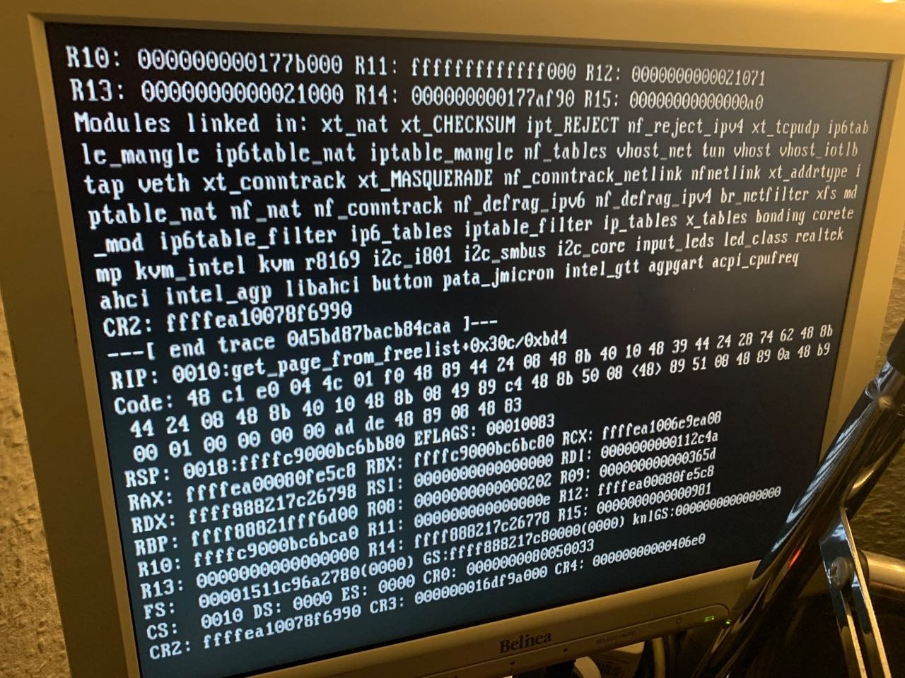

I'll also add a photo of the monitor screen after the crash. What i noticed is: Copying files internally without copying at once from a client to the server does nothing.
Copying externally and internally leads to a crash. I thing it has something to do with the network/memory, maybe an overflow?
I think you'll better know what it could be looking at the protocols.
Thank you in advance ... retox

Hi there, so here at last my syslog and a photo of the latest crash on the monitor . I'm really excited what kind of problem this is ...😉
