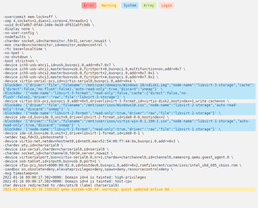

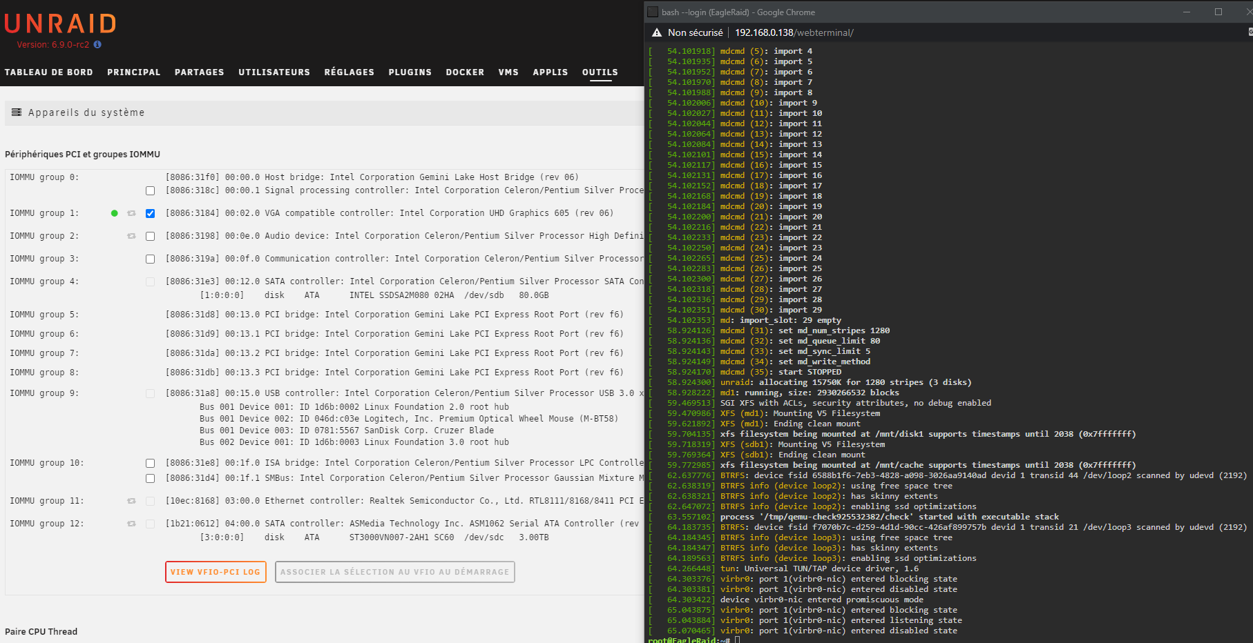

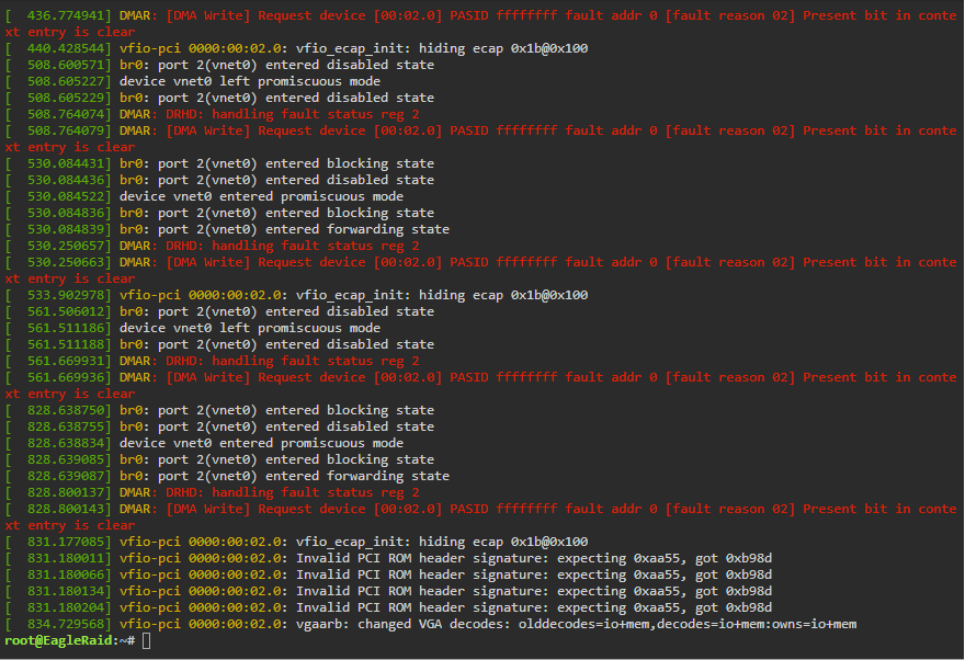

  6. Hello Picha, I have tried a lot of configurations and this is the configuration I have at least the windows boot logo on the screen. But, after the boot sequence i have a black screen. Over RDP i can connect me on the VM. Unraid start parameters: label Unraid GUI Test menu default kernel /bzimage append pcie_acs_override=downstream vfio-pci.ids=8086:3184 video=efifb:off,vesafb:off modprobe.blacklist=i2c_i801,i2c_smbus,snd_hda_intel,snd_hda_codec_hdmi,i915,drm,drm_kms_helper,i2c_algo_bit initrd=/bzroot On the right left side, you can see the dmesg befor are starting the VM: After starting the VM, i see follows errors: The VM Log file: I tried other VM with the OVMF Bios, but i see nothing on my screen... Black screen 😞 Thanks in advanceand have a nice day and stay healthy! vm.xml
  7. Hello guys, thank you for your help on this page! I was able to configure my VM W10 with this. The Intel UHD 605 reconnected perfectly and I installed the Intel drivers. But I like to use the output of the VM on the monitor via HDMI from the Intel UHD 605. Is this possible? I read a lot of web pages but I haven't found the solution until now. For your information, displaying the Unraid gui is not necessary. My HW: - ASROCK J5040 - 16GB RAM - Unraid last RC2 Thank you in advance Christophe
