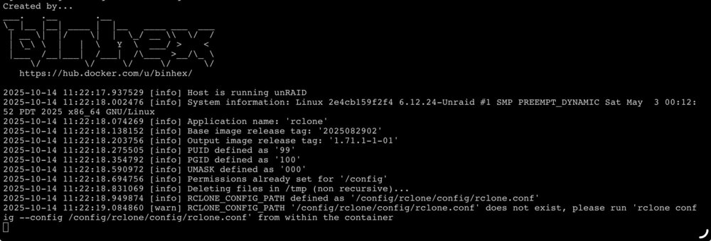

IMPORTANT - Please note this image requires the user to create the rclone configuration file up front, more instruction on this will be added to the faq shortly.
Tried running this but it stops immediately after starting. tried changing ports incase that was the problem but that didn't work.
can't make it to the console to run rclone wizard.
ahh i think what is happening is the script is exiting out because there is no config file, ok i have relaxed this so that now it does an infinite pause which should give you enough time to configure, please pull down latest image by doing 'force update' and then follow faq q1:- https://github.com/binhex/documentation/blob/master/docker/faq/rclone.md
thanks mate. I had to create a config on another machine with rclone and then transferred it and the container starts :)

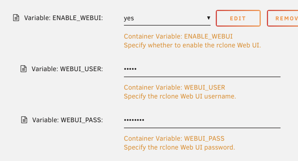

Hello,
i have installed the docker container on my Unraid and try to access on the Web-UI, but with an error "ERR_CONNECTION_REFUSED".
In the container config, i have activated this with the option "ENABLE_WEBUI" = yes
What is my error or what i should make to run it?
Thanks in advance
17 hours ago, [email protected] said:
Hello,
Thanks in advance
take a look at /config/supervisord.log, its probably that you havent run through the rclone config wizard yet see q1:- https://github.com/binhex/documentation/blob/master/docker/faq/rclone.md

similar story, I installed the container, followed the config wizard and setup 1 FTP server.
After that, I expected to then have access to the WebUI, sadly not.
Still have this error in the logs...
RCLONE_CONFIG_PATH '/config/rclone/config/rclone.conf' does not exist, please run 'rclone config --config /config/rclone/config/rclone.conf' from within the container
Also, each time the container restarts, the config seems to get lost.
Any suggestions that I could try would be very much appreciated.
does the rclone config file exist at that location? '/config/rclone/config/rclone.conf'
Yes. Don't have permission to view it though.
From the logs after a restart just then...
2021-07-22 19:37:59.194454 [info] RCLONE_CONFIG_PATH defined as '/config/rclone/config/rclone.conf'
2021-07-22 19:37:59.326300 [crit] RCLONE_MEDIA_SHARES not defined,(via -e RCLONE_MEDIA_SHARES), exiting script...
hmm so you dont have the message:-
looking at the issue now its around the fact you haven't defined RCLONE_MEDIA_SHARES to backup, see here:-
https://forums.unraid.net/topic/111235-support-binhex-rclone/?do=findComment&comment=1016547
EDIT - its been asked twice so written up a FAQ for it now, see Q3:- https://github.com/binhex/documentation/blob/master/docker/faq/rclone.md
