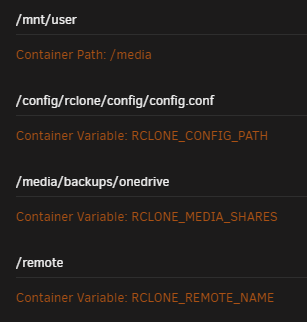

Do I have to choose a whole share or can I choose a folder within a share?
In my backups share, I have a folder called onedrive and I want all files/folders within that to go to my OneDrive in a folder called remote?
Have I configured that right?
RCLONE_MEDIA_SHARES is configured correctly, but RCLONE_REMOTE_NAME is not, this should be the name of the remote when you ran through the rclone wizard to create the rclone configuration file, if you cant remember what you set it to then open your rclone config file with a text editor and look at the value in square brackets, that is the remote name.
Oh, the name I set specifically for OneDrive. OK, that worked. I can see the files on OneDrive now :) Thanks.
