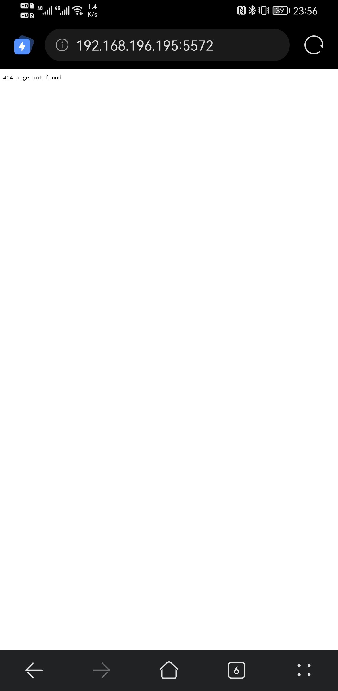

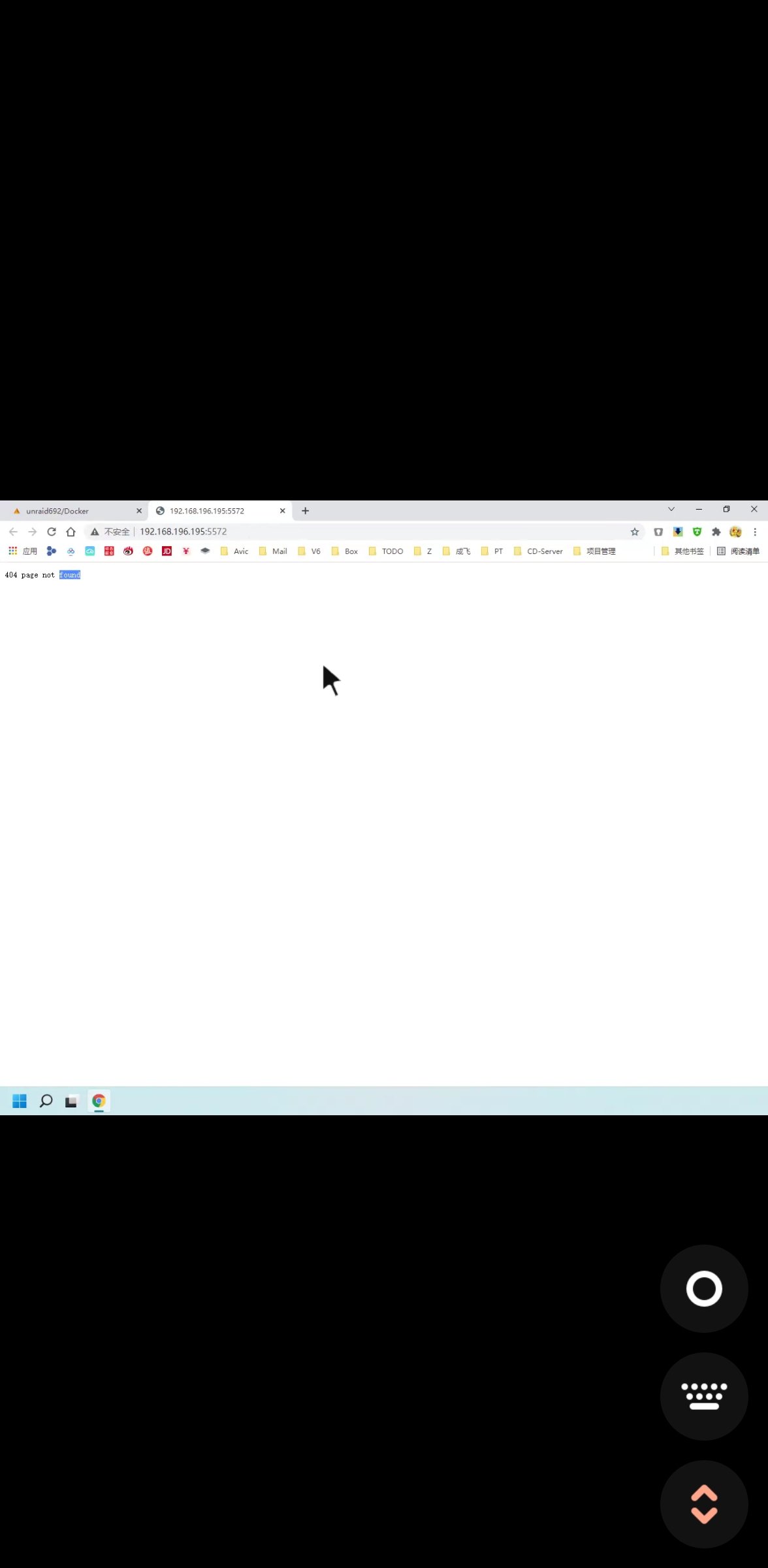

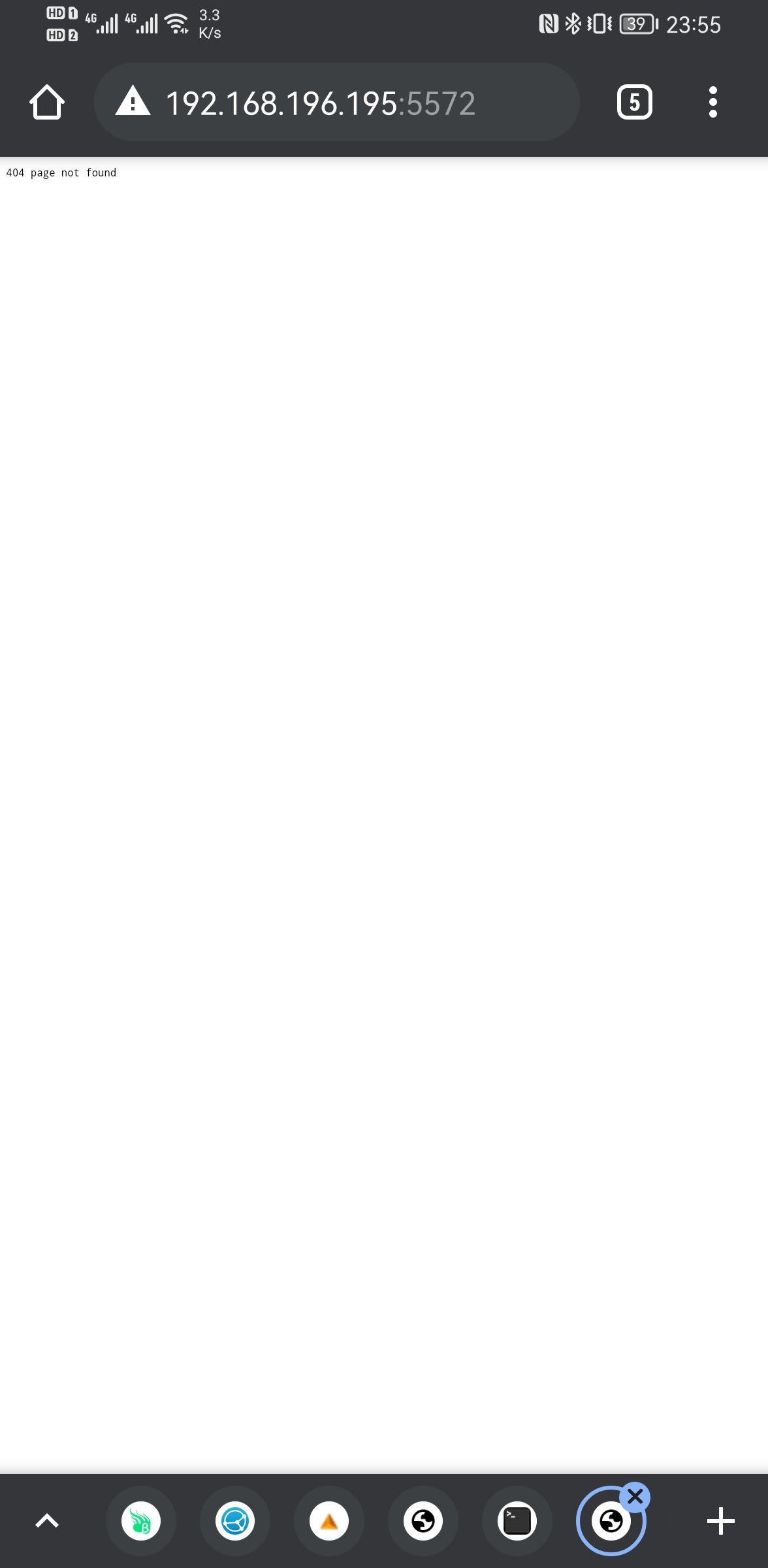

hey,thanks for your work,
i work with docker all brealiant ,but i cant get the gui web with the  'ENABLE_WEBUI=YES' I only get the page '404 page not found'
check the supervisord.log file, im assuming you havent generated a rclone config file most probably.
1 minute ago, Alex1989 said:
i already can work backgroud ,only the webui not worked,i pease the log under:

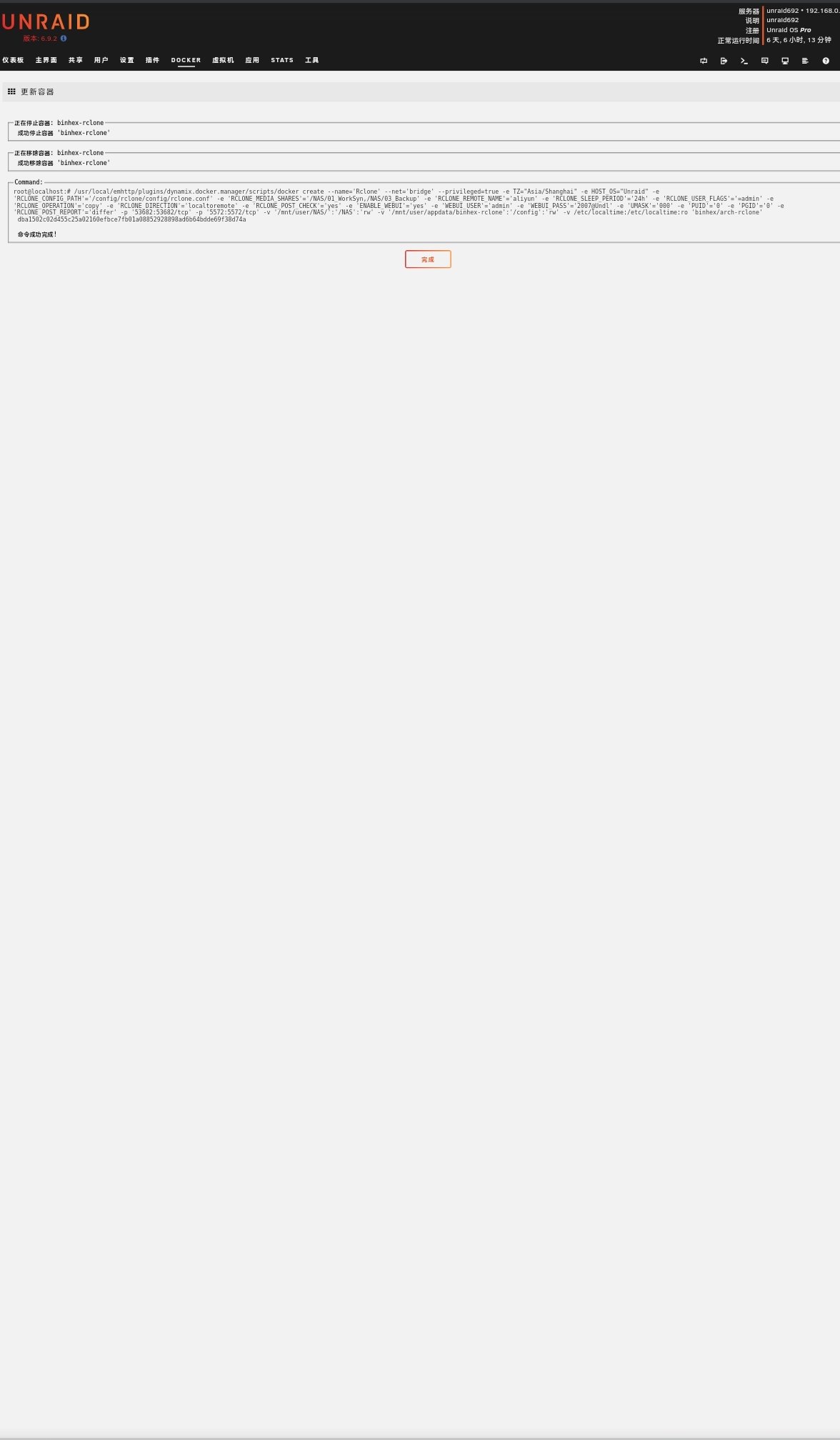

ok can you please share your docker configuration, if you are a unraid user (not sure as your media share name looks odd) then easiest way is to edit the container, change something, change it back to what it was, click apply then copy and paste the entire output here, else if not unraid user then paste your docker run/compose file here.
yes i use the unraid,but i change the route of the based
Command:
 create --name='Rclone' --net='bridge' --privileged=true -e TZ="Asia/Shanghai" -e HOST_OS="Unraid" -e 'RCLONE_CONFIG_PATH'='/config/rclone/config/rclone.conf' -e 'RCLONE_MEDIA_SHARES'='/NAS/01_WorkSyn,/NAS/03_Backup' -e 'RCLONE_REMOTE_NAME'='aliyun' -e 'RCLONE_SLEEP_PERIOD'='24h' -e 'RCLONE_USER_FLAGS'='=admin' -e 'RCLONE_OPERATION'='copy' -e 'RCLONE_DIRECTION'='localtoremote' -e 'RCLONE_POST_CHECK'='yes' -e 'ENABLE_WEBUI'='yes' -e 'WEBUI_USER'='admin' -e 'WEBUI_PASS'='XXXXXXXXXX'                     -e 'UMASK'='000' -e 'PUID'='0' -e 'PGID'='0' -e 'RCLONE_POST_REPORT'='differ' -p '53682:53682/tcp' -p '5572:5572/tcp' -v '/mnt/user/NAS/':'/NAS':'rw' -v '/mnt/user/appdata/binhex-rclone':'/config':'rw' -v /etc/localtime:/etc/localtime:ro 'binhex/arch-rclone
ok that looks alright, the above is the port the web ui uses, so you should be attempting connection on:-
http://<unraid ip address>:5572
does that not work?, if not try a different browser, watch out for adblocking extensions too, also check for any firewall running that might be blocking port 5572.

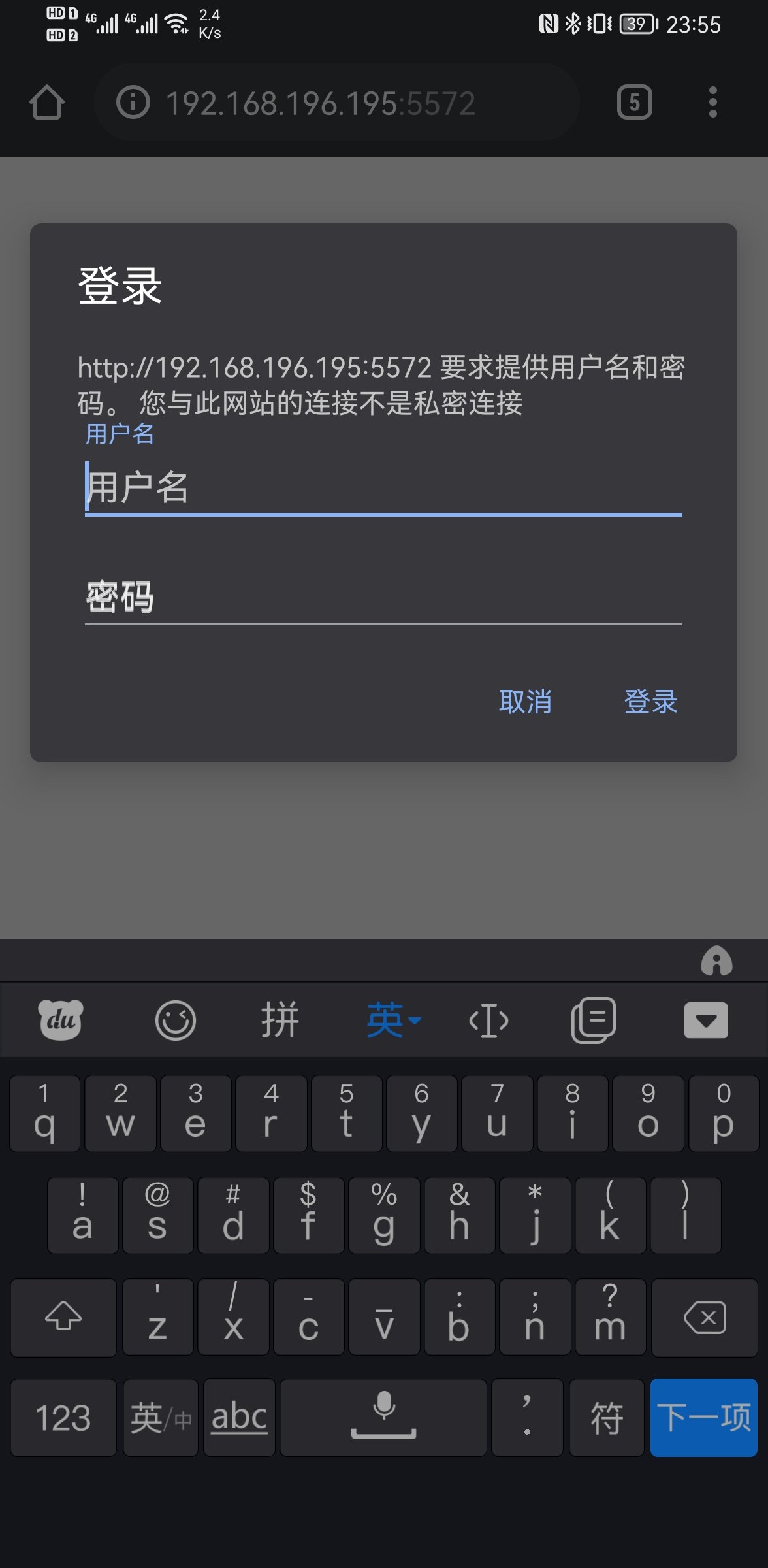

don't work also. I have chack all the things but only got results like this
i can touch the 5572 port and with auth too
im assuming when prompted to login (as shown in your first screenshot) you put in the WEBUI_USER amd WEBUI_PASS values right?, can you try a desktop pc not smartphone/tablet, it might be the browser you are running is not compatible

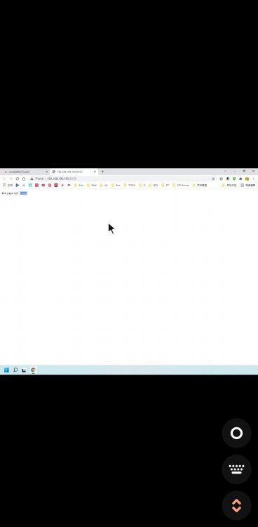

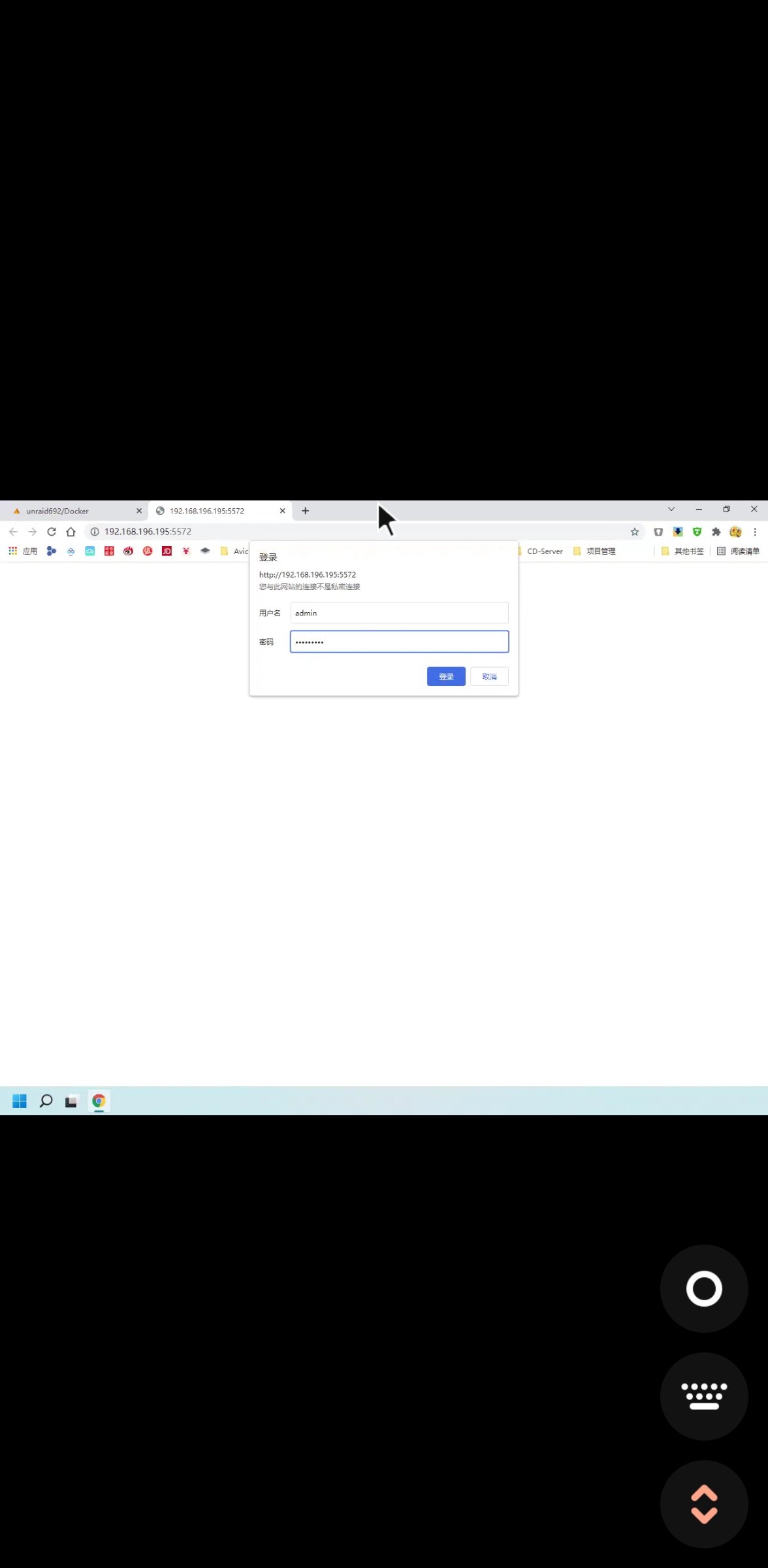

if i type the wrong value i can't get anything or like screenshot  below .also with the pc broser with the same results.
i just use chrome or IE but got the same results

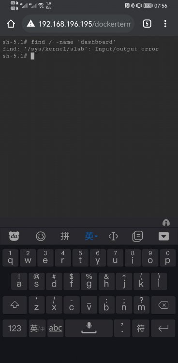

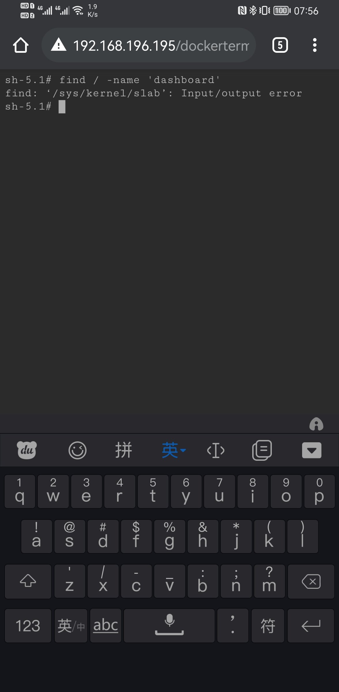

also the same results,I Have try many ways to solve this problems but get nothing. so I try to connect with you. Help me!
 I also try to find some html in docker but nothing results too

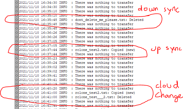

After some messing around I've got docker to connect to my OneDrive, and I'm testing syncing.
However, I can only seem to sync files UP, but not DOWN, and if I add files to the folder from the OneDrive side, they are deleted.
If I change something on the OneDrive side, the "new" (changed) file gets deleted, and the "old" (unchanged) file is synced back up in its place.
Seems like a working 1-way sync, I'm trying to get 2-way.
I've resolved all errors in the logs/reports, and the link seems to be working.
Anyone know why this is happening?
I have the variables set as following:
RCLONE_OPERATION=sync
RCLONE_DIRECTION=both
