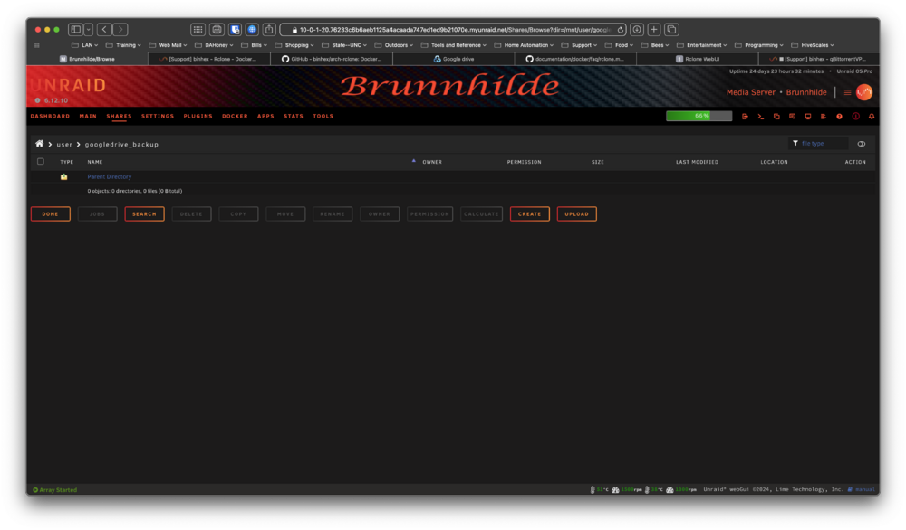

Maybe I missed a forward slash somewhere or something but I'm not seeing it???
I've tried many different paths but they all seem not to exist. My guess is that I'm misunderstanding something somewhere. Not sure why RCLONE_MEDIA_SHARES is a variable rather than a path?

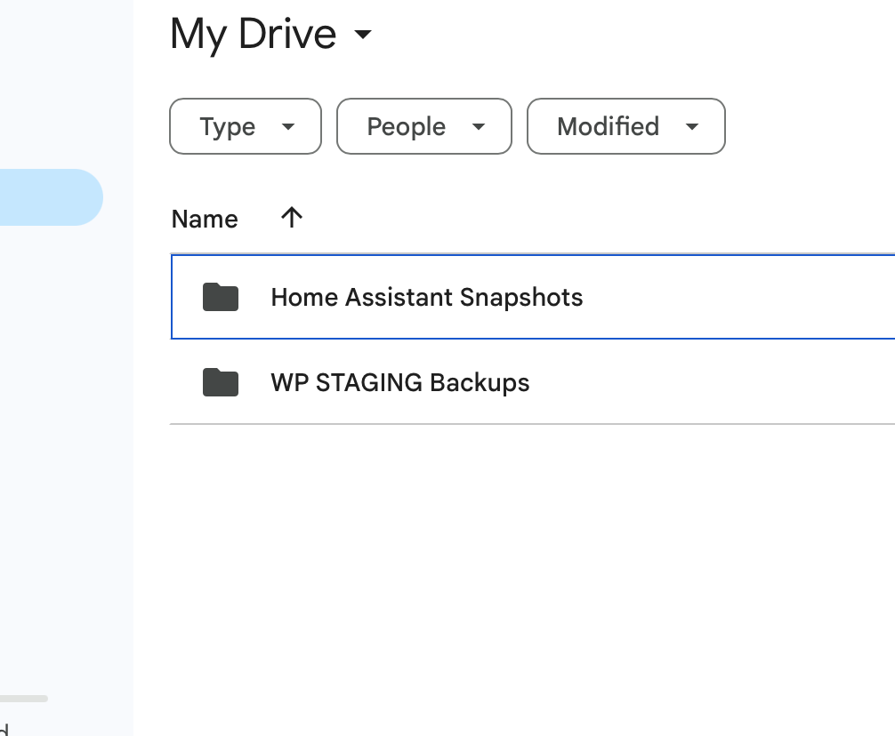

Regardless, I am trying to do a remotetolocal copy of two folders on my GoogleDrive.
I want to copy them to /mnt/user/googledrive_backup/. I have /media path set to /mnt/user/googledrive_backup/ which is maybe correct??? I can't figure out what to set for RCLONE_MEDIA_SHARES though? Everything I have tried so far results in a does not exist error. Currently it is "Home Assistant Snapshots","WP STAGING Backups" because I seem to remember a comment about comma separating multiple folders.

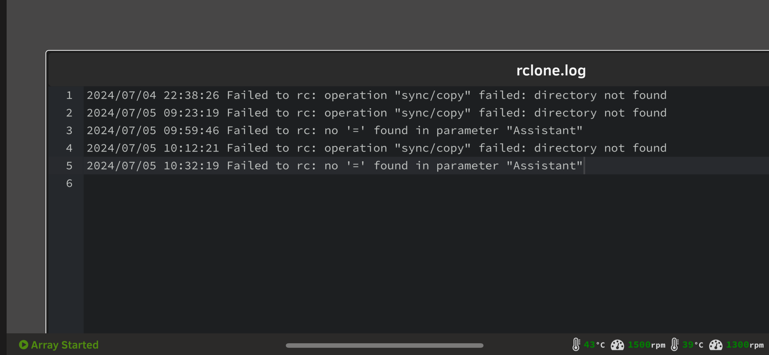

I think I’ve made some progress after reading back through early posts here I realized that I needed to manually create folders in my Unraid share with names matching the folders on my google drive. Doing that results in /media path of /mnt/user/googledrive_backup and RCLONE_MEDIA_SHARES is set to Home Assistant Snapshots (no quotes). This appears to function properly in the container log but I get an error in the rclone log and nothing is being synced/copied.
I think this is due to the spaces in the folder name but if I escape the spaces with single or double quotes I get a directory not found error in the container log.
rclone.log
1 hour ago, wgstarks said:
Update
rclone.log 396 B · 0 downloads

Finally got it working. Didn’t realize I needed to enclose everything on my google drive in a /media folder so that the file structure on the gdrive was the same as RCLONE_MEDIA_SHARES (should have though I think). Not sure what the path would have been to just copy everything from the root of the gdrive but this is working and it’s really just backups of backups so navigating through a few extra directories doesn’t really matter. All automated anyway.😁
