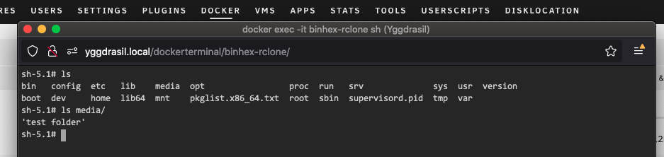

Ok, I understand the risks of what you've described, but I think maybe I'm not communicating this well enough. I think I'm using the word/term "sync" loosely, so maybe I can clarify. My bad.
I set the variables to RCLONE_OPERATION=copy and RCLONE_DIRECTION=both, and made 2 changes on the remote cloud side; I created a new file "dont_delete_me_please.txt" and renamed a file "rclone_test2.txt" to "rclone_test_2.txt" (added the 2nd underscore to the filename).
With that logic, I expected the operation to delete the local copy of "rclone_test2.txt", then copy down "rclone_test_2.txt" and "dont_delete_me_please.txt".
But I had the duplicate behaviour as shown in the screenshot.
It duplicated the renamed file, and copied down the new file.
But I take it that the RCLONE_OPERATION=copy behaviour will never delete anything, but only copy, which is fair enough (Is that correct?).
The original issue however, was that when setting RCLONE_OPERATION=sync, it would only sync in 1 direction.
So am I correct in thinking that (Assuming RCLONE_DIRECTION=both) an RCLONE_OPERATION=sync operation will copy everything in 1 direction, then copy everything (including the previous copy) in the other direction (including new duplicates)?
Am I missing something?

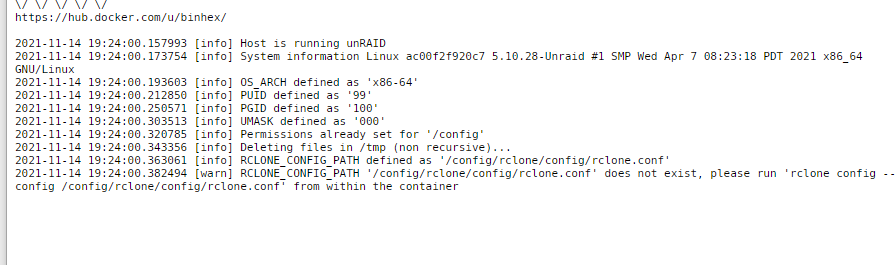

I seem to be having issues with the config file. I originally just created it using rclone config, read some more and realized that was incorrect, so reran it with rclone config --config /config/rclone/config/config.conf, I now have a config file showing
But upon starting the web UI I'm getting "This site can't be reached". Looking at the log, looks like it is not seeing the config file?
Only thing I can think of is I messed up my config path somehow but I have it as the default still so I think I should be good?
Do you see anything obvious that I'm missing? I'm terrible with this stuff, so it probably is something right in front of me.

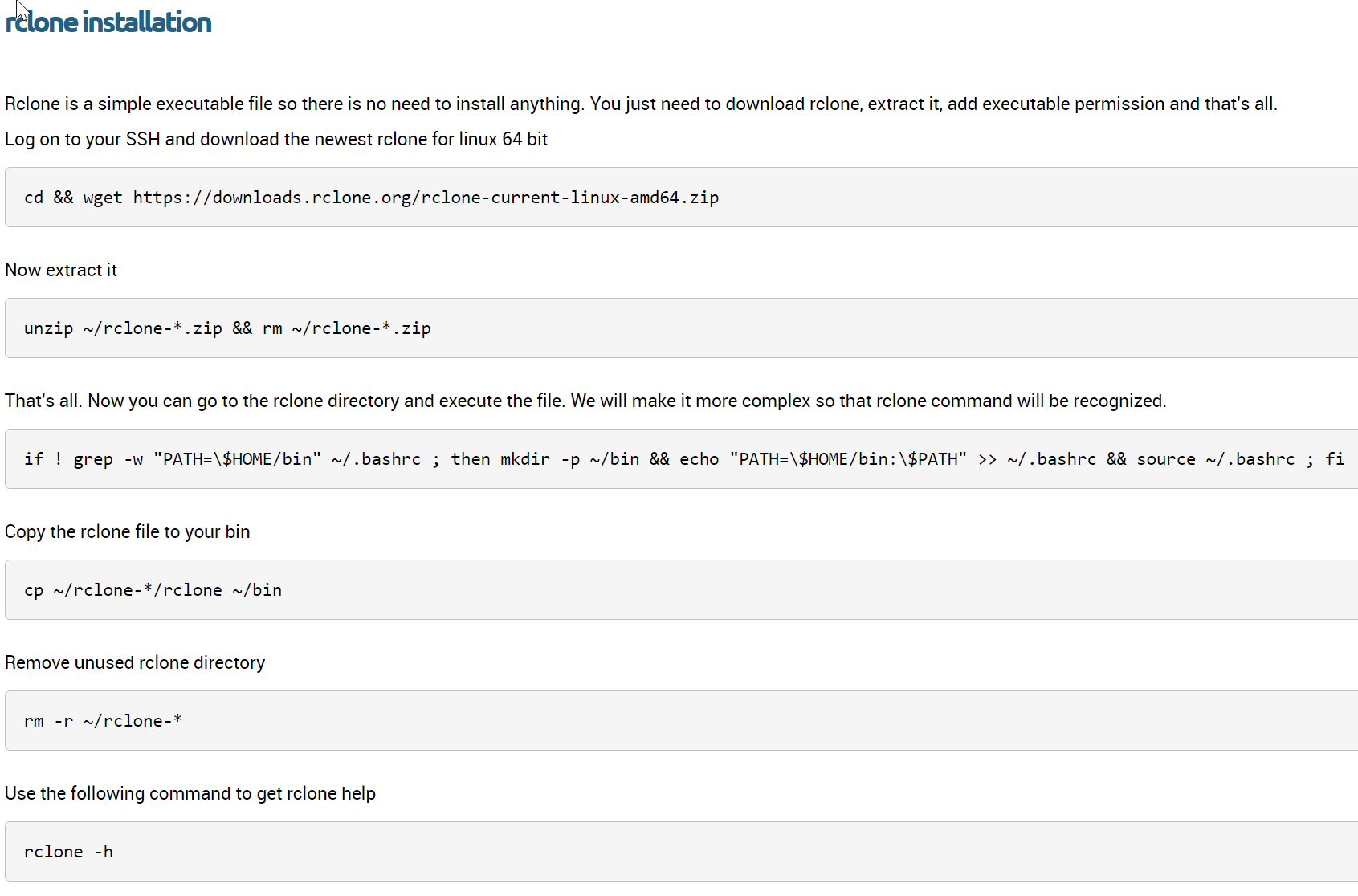

On 10/27/2021 at 9:51 PM, casperse said:
Hi binhex
I think you are the one to ask ;-)
Over some years I have transferred data one way --> to my Unraid server
FTP, Synchting, Resilio Sync, and latest LFTP using Seedsync Docker & Ubuntu VM Last one very unstable)
Could I use your binhex rclone to connect to my off-site server and do a oneway synct to my unraid server?
I have read all of the post and they are mostly about google drive and big vendors?
I was able to install rclone on the remote server doing this:
Would this make it possible to use your docker?
And would the configuration be simpler?
Sorry I am still trying to get my head around settings this up to just run and work (FAST ;-)
Would this docker work for this problem?

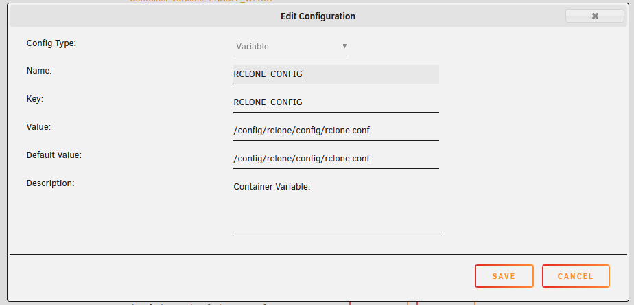

I had a SIMILAR problem. I never found a quick/easy solution, but adding another variable worked for me:
After adding that and restarting the docker,  it is able to find the .conf stored in appdata.
I hope this helps someone. I also hope this issues is resolved somehow in a future release.
The dev doesn't seem to know what causes, lol.

unlikely unless you made the same error as @Matt0925 where he named his config file incorrectly. naming it config.conf and not the required rclone.conf
Wow, thanks for the insightful and extremely helpful reply.
I assume you are clueless about why this happened to me, but thanks for your "support"!
no idea without a log, attach /config/supervisord.log oh and btw creating a new variable with key name RCLONE_CONFIG will do absolutely nothing for this image, it needs to be named RCLONE_CONFIG_PATH

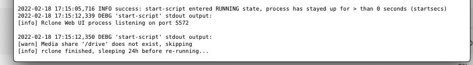

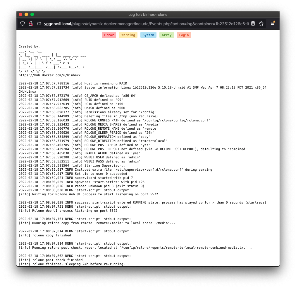

Hello,
I am trying to do a simple thing : copy my Google Drive in /mnt/user/GoogleDrive.
But i missed something...
Here the details if you can help, thanks.
I successfully installed this Docker with that :

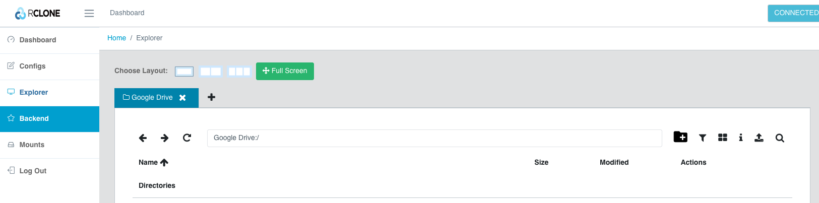

695503179_Capturedecran2022-02-18a17_08_20.thumb.png.e717ebb1aa8adc2777a81d8b464b90a7.png
I can navigate from the docker to my /media path
I can see my Google Drive on the WebGUI :
362191687_Capturedecran2022-02-18a17_11_17.thumb.png.d4f1ff81e99c304313a1f4504b11e312.png
But in the log, i have :
I try a lot of things for RCLONE_MEDIA_SHARES, but i think i don't understand what it is.
Thank you for your assitance,
K.

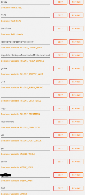

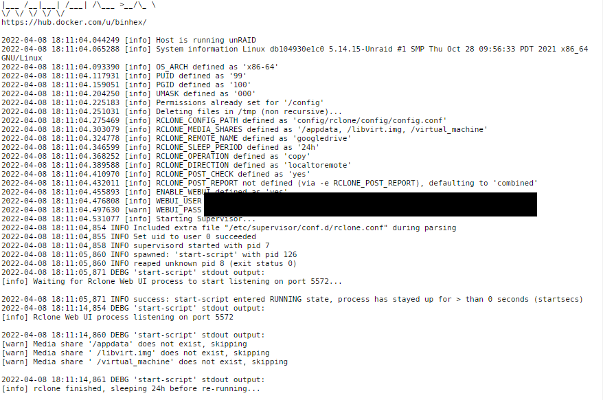

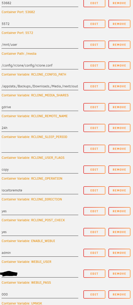

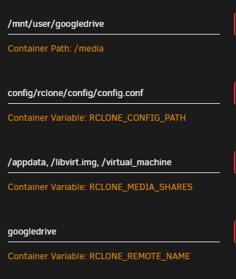

Hi everyone, I have tried to configure the rclone media but I am not understanding what I am doing wrong.
Console:
Setting docker:
Rclone:
Hey,
Just a quick heads up on this one, I ran in to the same issue they did where the config file was named config.conf and didn't work but that's because the rclone FAQ here https://github.com/binhex/documentation/blob/master/docker/faq/rclone.md says to run "
rclone config --config /config/rclone/config/config.conf", you might want to tweak that.
Hey,
Thanks I will make the change to the faq, just for reference the filename can be anything you want as long as you ensure the env var RCLONE_CONFIG_PATH specifies the filepath
