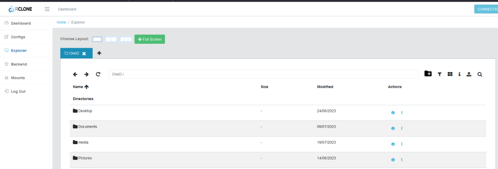

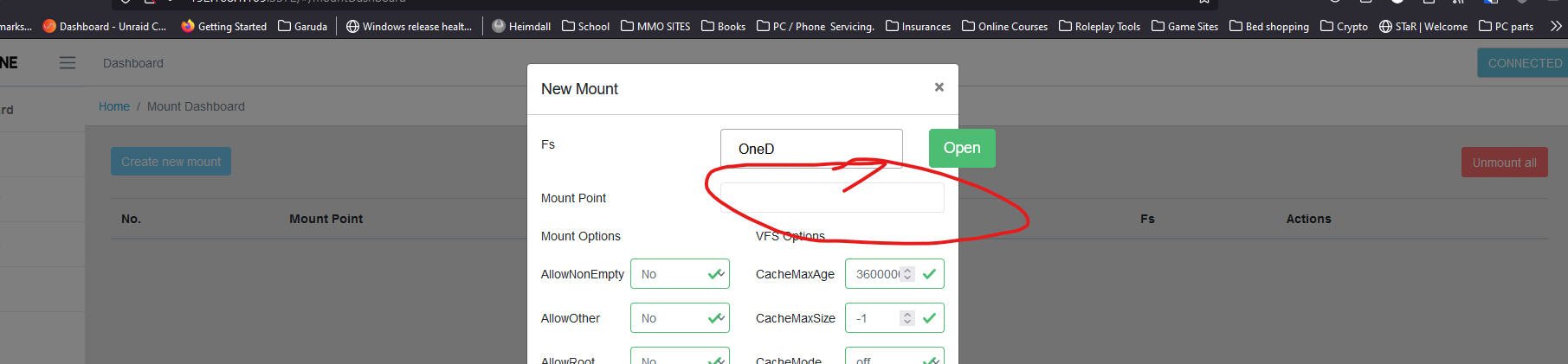

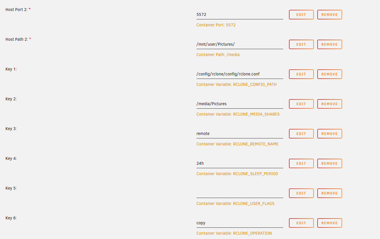

Hi sorry if it turns out to be a total newb question.   But trying to use the Binhex Rclone docker to back up my family pics to one of the 1TB onedrive allocations from an office 365 family sub.
I have managed what seems to be the tricky bit of getting the token to connect.   in the Rclone GUI i can go to the Explorer and see the mounted Onedrive, and browse existing files on the Onedrive account.   But i am becoming confused at this point, i think i need to do something in the mounts tab?
How ive got it set up  (do let me know if more information is needed)
On Container Config
Host Path 2  (/media)   is /mnt/user/Pictures  (pictures being the unraid share with er pictures in)
Key 2: i am not sure what i am supposed to put in there  its titled  Container Variable: RCLONE_MEDIA_SHARES,   ive tried mirroring the path on OneDrive , but us that correct  (see screenshots)
In the WebGui when its up and running,  Explorer the (see screenshots)  theres a drive called OneD:/  with some folders in
What i want to do is copy everything in the  unraid share called Pictures into a  folder called Pictures which is in Onedrive  under /media/picture    (the root level pictures folder is the one from the users Windows Pictures folder)
example  the share has year folders
/pictures/2005
/pictures/2006
etc
i want these copied into the /media/pictures folder in the Onedrive.
Hopeing some kind sole could point me into where i am going wrong?
Whats the correct line to put in Key 2: (Container Variable: RCLONE_MEDIA_SHARES)
What if anything am i supposed to do on the Mounts tab in Gui?
Thank you in advance for any guidance given

@Billwin I believe I can help you a bit --
/media should be the path to where the folder lives that you want to backup. You have it set to /mnt/user/Pictures/
Then you have RCLONE_MEDIA_SHARES set to /media/Pictures
That would mean it is looking for a folder called /mnt/user/Pictures/Pictures
Does such a folder exist? Perhaps you should set /media to /mnt/user/ and then it would find your Pictures directory.
As far as getting the files to upload automatically, I don't know. I just finished getting mine setup and authed to Google Drive (bit of a headache because I just ran rclone config without telling it what config file to use, so I couldn't figure out why the web GUI was not matching the command line. Once I gave it the path to the conf file I was good to go). However, nothing has started uploading. Perhaps I just haven't waited long enough? I also can explore to my Google Drive and see the files there, so I don't know for sure what's going on there.
Figured out my issue - I hadn't named my remote config "remote" and I didn't set the RCLONE_REMOTE_NAME to match the name of my remote. Once I did that and restarted, it began syncing immediately.
Cool good pointers thank you..  I'd I'm understanding then for my remote name I would be putting oneD. Which is the name showing for the onedrive when looking at it in the explorer in gui
Yes, you'd want to make that match the name in the explorer, or if you go to the configs section of the web GUI, it will list your remote name as the "name". That should be what you enter into the RCLONE_REMOTE_NAME variable.
Up and Running,  had one hitch,  for some reason i couldnt figure getting it to go to OneD:/media/Pictures and start checking what was there and start uploading the newly added,  but i could get it to go to OneD:/media.    So to end my headscratching i figured leave it configured like that,  turned it off,  popped onto the 365 account for that OneDrive and got Onedrive to move all the folders in media/Pictures to  to be in /media.     Restarted and were off. :)
Thank you for you help Wallypop,  it was enough for me to get to the finish line and is much appreciated.

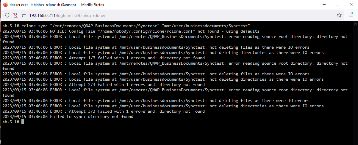

Hi friends, thanks and apologies for what I know to be an embarrassing request for assistance.
I'm trying to run a simple sync command from an SMB share to the local array. The SMB share is mounted successfully and browsable in unraid and midnight commander. When I run the sync command, rclone cannot access the directory.
Does the rclone docker have a permissions issue in being able to see outside of itself to mounted SMB shares? Is there a simple formatting error with the file path?
Your help in sending me on my way is much appreciated, thanks :)

It will automatically copy any new files from source to remote when it completes it's sleep period and re-runs the copy service.
It doesn't continuously look for and auto detect new files and transfer them.
What have you set in the container variable "RCLONE_SLEEP_PERIOD"? Default is 24h. i.e it runs the copy process once every 24hrs.
You can set this to 1m for example and it will run the copy service every minute. However if you're local and remote have large number of files, despite nothing being copied if there are no new files, it will still run the post check which will take a long time to complete and use a lot of system resources. Thus isn't practical.
