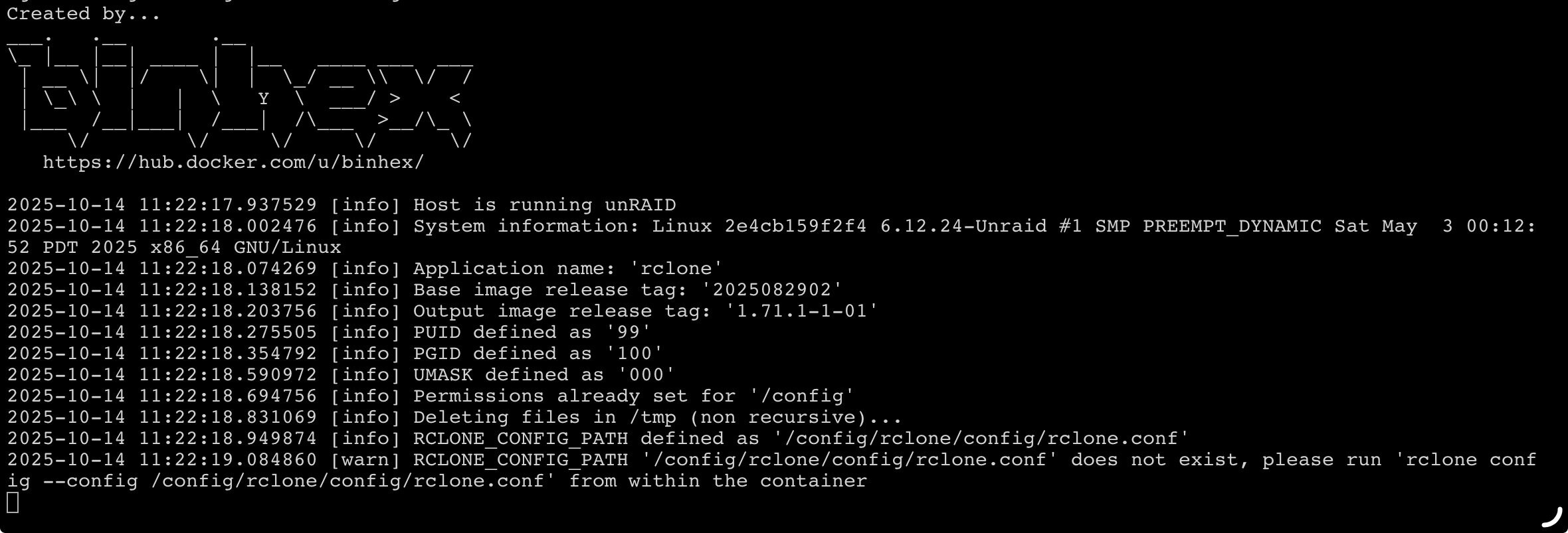

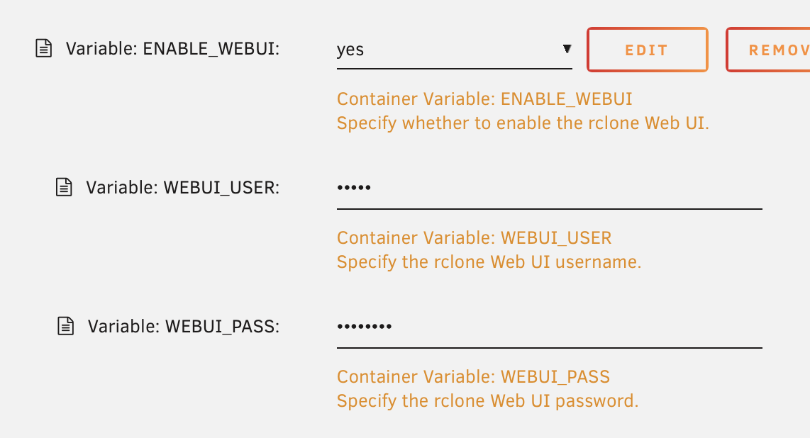

From a complete fresh setup with only a few steps needed to get the gui to actually start running, this container uses 45% of the cpu on my nas and the logs are spammed with the following:
The steps I followed to get the gui to launch were:
  • Fresh container installed via "Apps" in unraid, previous installations directories in appdata are already deleted, so it's a fresh install
  • Only 3 values are changed in the unraid configuration for the docker container: WEBUI_USER, WEBUI_PASS, and the path mounted as /media in the container (I set it to the appdata directory das that's what I want to backup). RCLONE_MEDIA_SHARES is also empty by default, I'm not sure why, so I set it to media.
  • On the container running, I note that the gui isn't reachable, and instead the logs show that I need to set a password in the container, so I do that, with: rclone config --config /config/rclone/config/rclone.conf . I set a password.
  • Then I have to restart the container.
  • Finally, I get the "password:Bad password" error in the logs
I don't know which password it's referring to, but after going through these steps, the GUI does load, but uses 45% of my cpu whilst spamming the logs. I presume that the reason for the cpu usage is just because of the bad password thing.

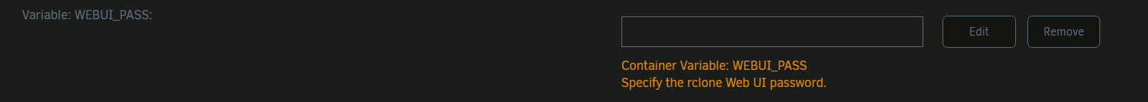

The password its referring to is most probably this one:
So try setting this to a non empty password and you should see the log spam stop hopefully.
Sorry I called it "gui password" in the post above, but it's `WEBUI_PASS`. I have set that in one of the first steps.
I edited the original post to reference the correct variable names.
Edited by J7mbo
updated post to reflect updated previous post

On a fresh setup, without setting a password in the console, here are the log lines:
Alright so once I create an empty config file I. The location, the gui loads.

the console log does not say to set a password, it says you need to generate a valid rclone configuration file using the commands specified
Next issue is that you can’t create an iCloud config in there, because apple blocks the user agent. On the command line it doesn’t work either, unless you use the —user-agent setting and set it to something random. Looks like there’s no way to do that in the gui though.
correct, you cannot generate a rclone config file via the ui, you need to use the command line option as specified in the console log, creating a empty config file will load the ui as you have found out, but it will get you nowhere as you still need to generate a valid rclone config file.
so run the following in the 'console' of the container, and when asked if you want to set a password, say no (or set it to blank):
When you see the following choose option 'New remote' do NOT choose the option 'Set cofiguration password' then walk through this and set the remote cloud storage configuration.
sh-5.3# rclone config --config /config/rclone/config/rclone2.conf
2025/10/14 11:25:50 NOTICE: Config file "/config/rclone/config/rclone2.conf" not found - using defaults
No remotes found, make a new one?
n) New remote
s) Set configuration password
q) Quit config
n/s/q>
Ah I understand, I was confusing running that config command with having to set a password.
It's now running and copying stuff after playing with the config. Thanks for you help!
