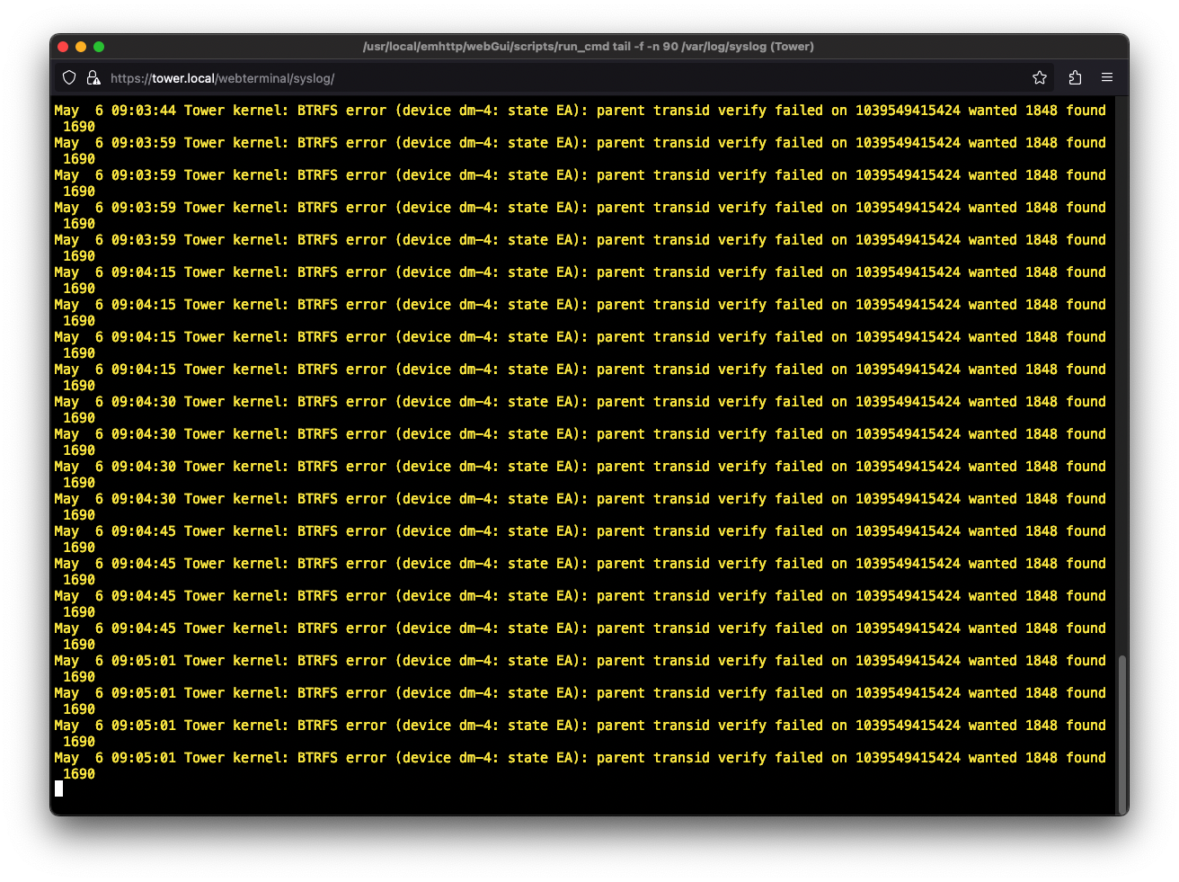

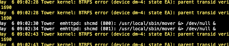

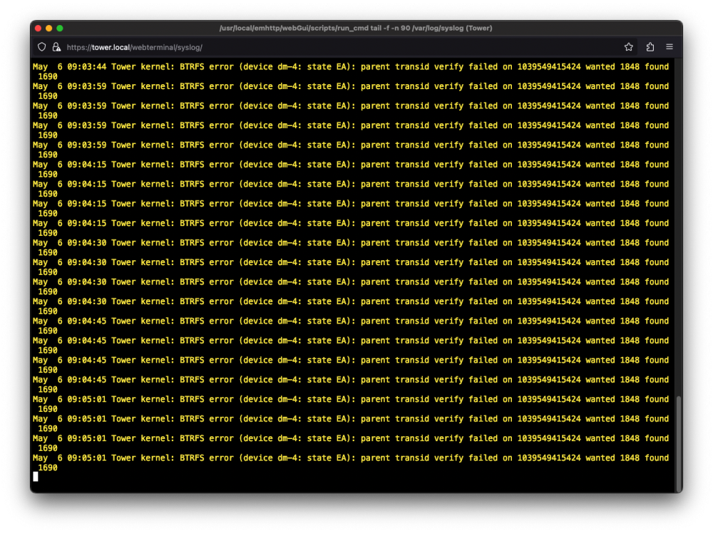

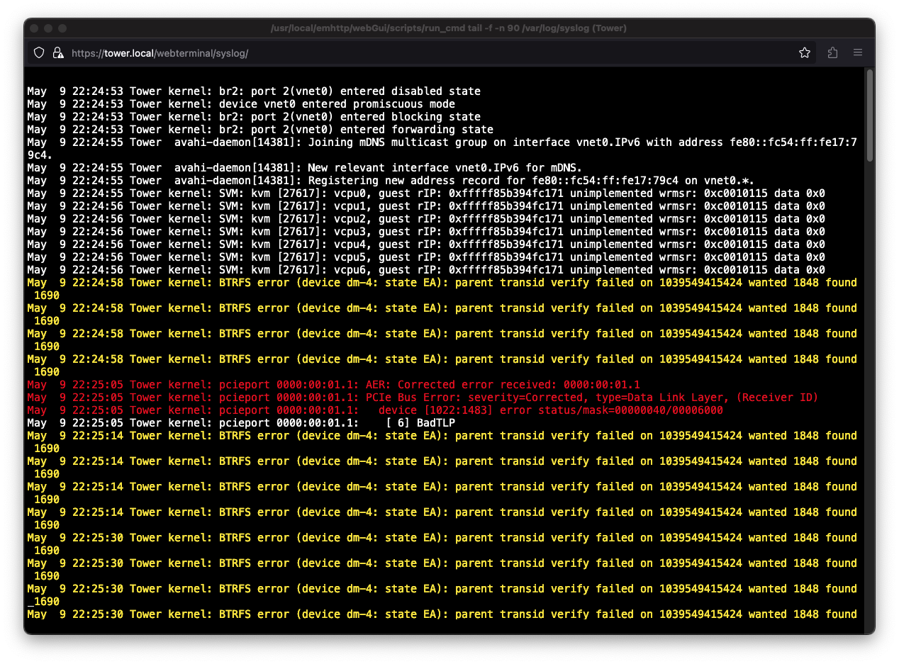

  2. the system shows [Tower kernel: BTRFS error (device dm-4: state EA): parent transid verify failed on 1039549415424 wanted 1848 found 1690] and the Mover cannot run, shows [Tower emhttpd: shcmd (800): /usr/local/sbin/mover &> /dev/null &] before the error happen, Disk 4 error and I use a new disk replace it, then use Parity Data-Rebuild. now the Data-Rebuild end, but the error cannot disapper. 😭😭😭 my file can read-write well. need help. tower-diagnostics-20230507-0015.zip

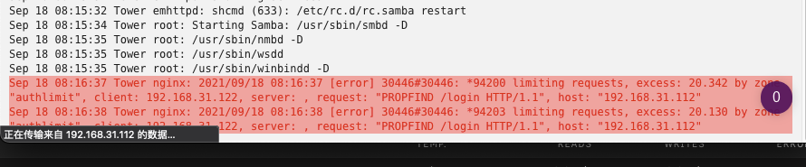

  3. unraid 6.9,能ping到主机,但是gui进不去。😭 unraid服务器插显示器,可以选择gui模式,也可以进入,但其他电脑无法进入unraid的gui界面。unraid服务器在gui模式下,可以访问百度,说明机器本身已连接互联网,但奈何本地其他电脑进不了gui,神奇了。 ip没有冲突,我两张网卡(板载+2.5g),对应的两个ip地址都没人用。 突然就出现这种情况了,硬件、软件都没有改动。倒是我现在主机的网线插着路由器,路由器开启的是无线中继模式。(之前是好的,突然一天就不行了) 求助,提前谢谢大家!!!

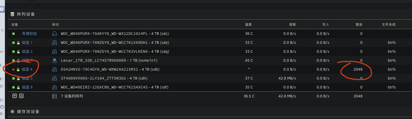

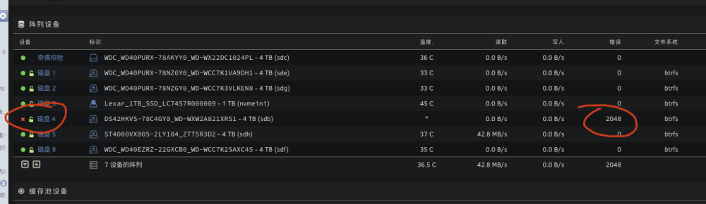

  7. 我是自己diy的主机,最近经常发生掉盘事件,买了两块新的硬盘,拿去重建阵列,然后就直接显示读写错误1000多,就掉盘了。 我拿硬盘放pc上检测,都是好的,没有坏道和报错。 不知道是什么原因,用unraid 2年了,就这几个月,掉盘十分频繁,掉了五六块。而且这些盘都扫描没问题。 不清楚是不是电源的问题,我电源一直没换过,600w的金牌,cpu是amd 3600。 硬盘掉盘后,unraid就挂载不了这块盘了,直接就不在硬盘界面显示,但是Unassigned Devices里有这块盘。

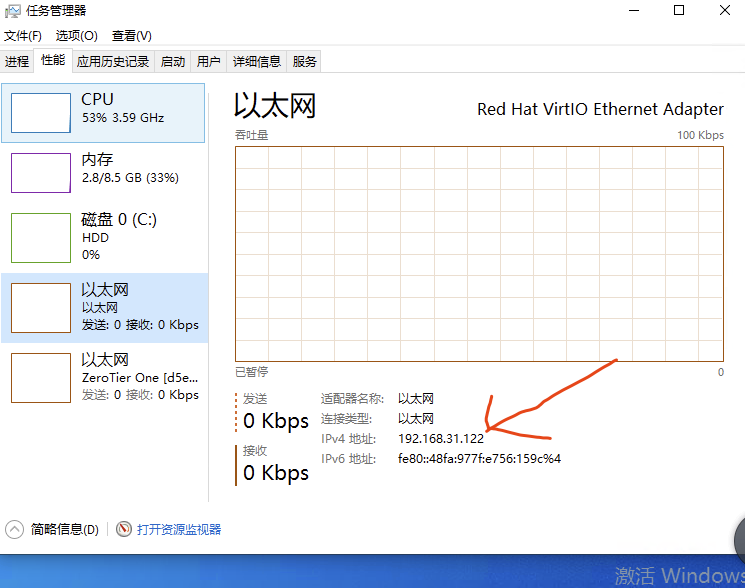

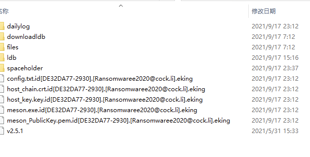

  9. Someone try to login my SERVER, the ip / 192.168.31.112 is my SERVER. the ip / 192.168.31.122 is the hacker. he alway try to login my server. I cannot FIND him, due to he ip / 192.168.31.122 is my virtual machine Win 10. the win 10 look like good. 😭 last day, some of My file to be encrypted by [ eking virus ], then I turn off the Public network ip on my router, and turn the Physical win 10 (it be hacked due to my bad easy password and Exposed it to the public network). and I delete the encrypted file.😰 I need help. encrypted file:
