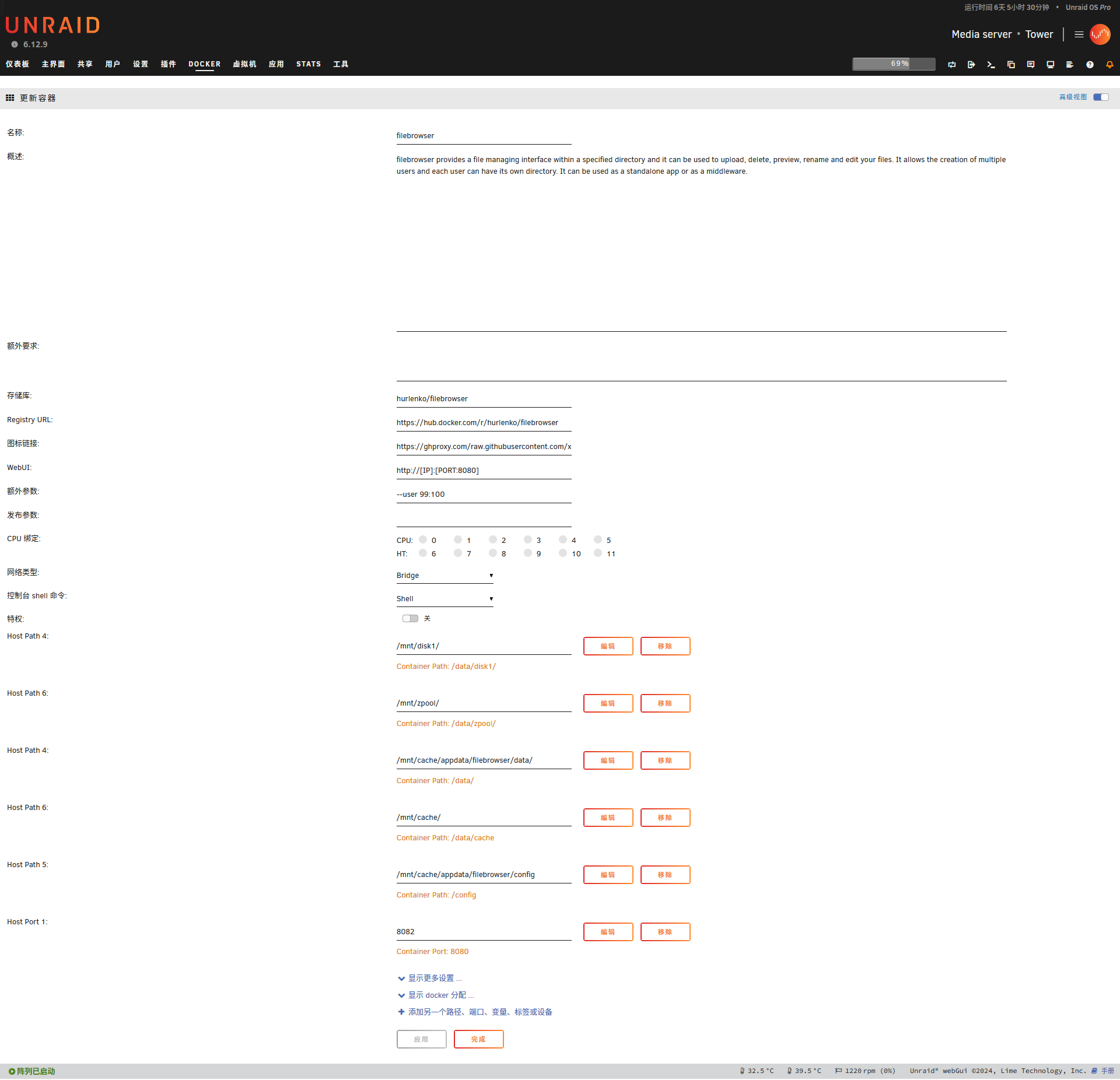

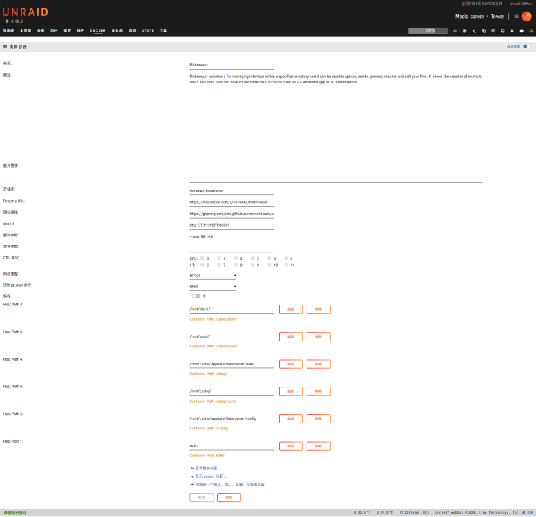

  3. The Dashboard is displayed at 100%. There are blank areas on the Docker page. If you adjust the browser zoom level to 90% or other ratios, it may display correctly occasionally. My monitor is 27 inches with a 2K resolution, and I have also installed the Docker folder plugin. I'm not sure what is causing this issue. 100%: 90%: 110%: 125%:

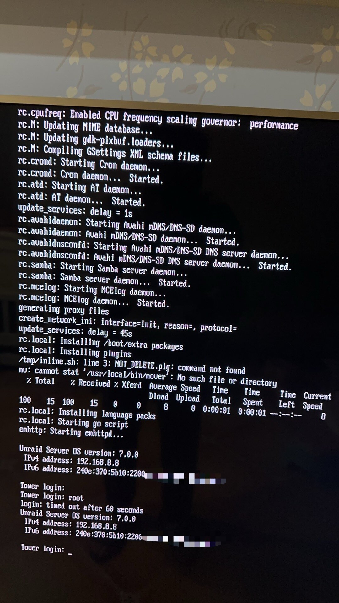

  4. 死机前安装了什么patch的插件
  5. 即使接上显示器和键盘登陆root都会超时,最后只能强制关机重启。 我怀疑是哪个docker升级后造成了cpu占满了,但是有些docker设置成了自动启动,启动阵列就启动docker了,请问有办法修改docker的自动启动设置吗?

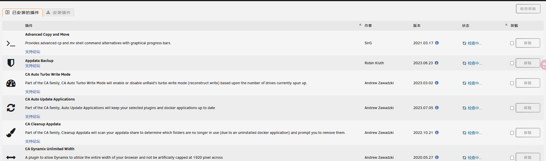

  9. web页面推荐VPN来访问(我目前用Tailscale,墙裂推荐),反向代理感觉不太安全。
  10. 最新版本出现插件无法更新的bug 状态一直在检查中
