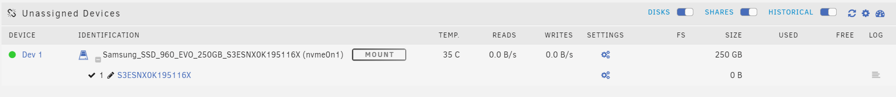

  9. I'm trying to mount my nvme drive but the mount button is just greyed out. what am i doing wrong?

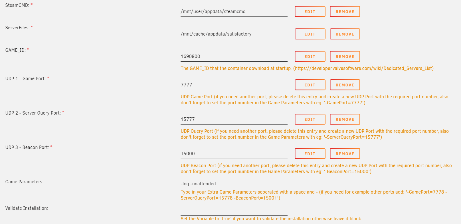

  10. so I just tried changing back steam cmd and deleting satisfactory and it went back to the old behaviour. I've now also deleted the steam cmd folder and now it's working again. So it was probably an issue with steam cmd
  11. ok, i seem to have found a fix. I changed the steamcmd folder mapping to steamcmd2 so it wasn't sharing steam cmd with your other containers and that seems to have fixed the issue
  12. ok, just tried what you suggested and got the same output as before. Also yes I do have pihole installed but it's never caused an issue with your containers for me before

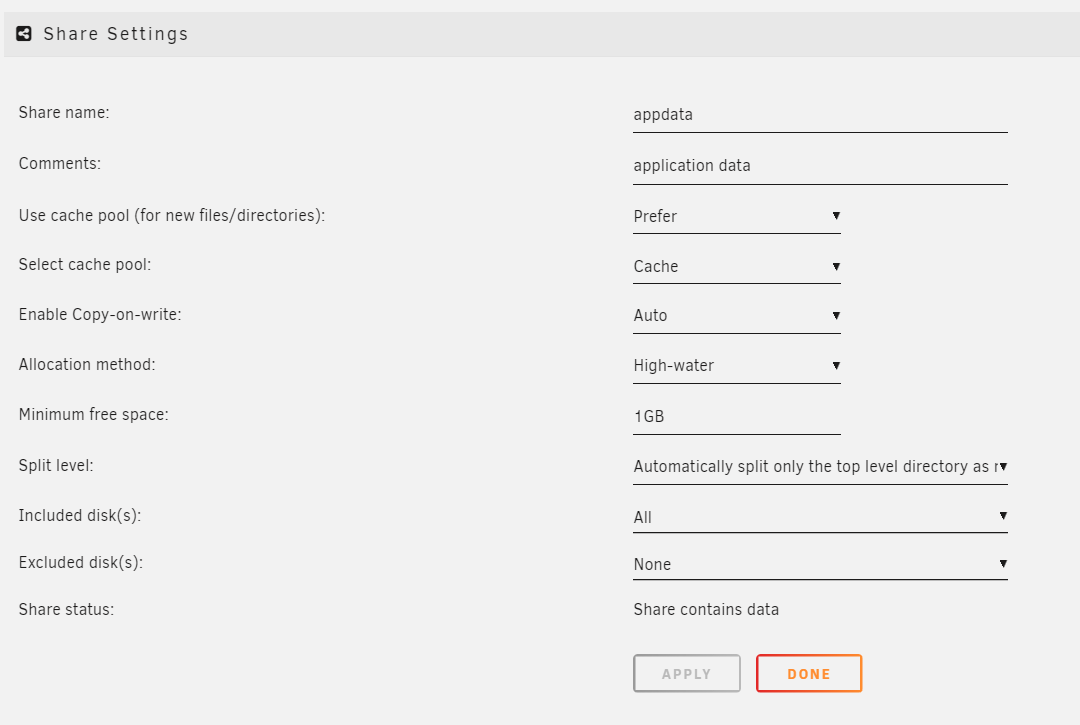

  13. @ich777 Here's the settings i'm using, i think i left them all on default And here's my settings for appdata
  14. I just installed the container from the community apps page (left all settings as default) and all i get is this same console output looped ---Checking if UID: 99 matches user--- usermod: no changes ---Checking if GID: 100 matches user--- usermod: no changes ---Setting umask to 0000--- ---Checking for optional scripts--- ---No optional script found, continuing--- ---Starting...--- ---Update SteamCMD--- ---Update Server--- ---Prepare Server--- ---Server ready--- ---Start Server--- /opt/scripts/start-server.sh: line 76: cd: /serverdata/serverfiles/Engine/Binaries/Linux: No such file or directory /opt/scripts/start-server.sh: line 77: ./UE4Server-Linux-Shipping: No such file or directory
