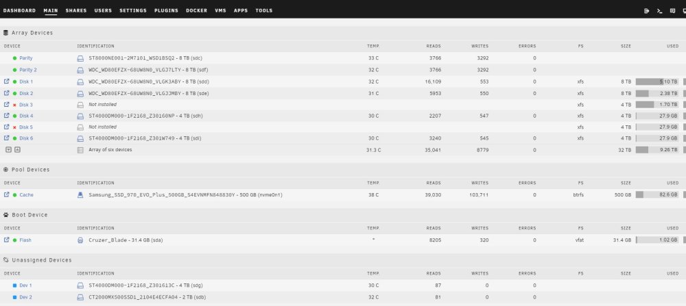

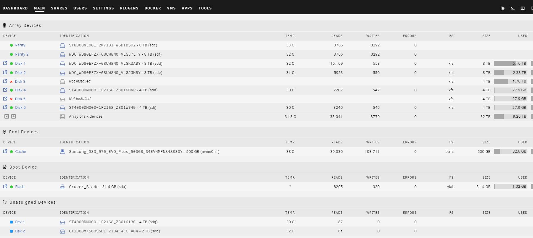

  10. I resettled the cables and now both drives are showing up as unassigned, both seem to have smart errors as well. Now the Array error is " Array has 1 SMART error." which is showing up on the parity drive
  11. Yes, one of the unassigned drives, the 4TB ones is the missing drive.
  12. In my machine, 2 of my 4TB drives decided to play truant together and are now showing up as not installed. I also found a 4TB listed under Unassigned devices. There is no 2TB unassigned device that I am aware of or is connected to the machine. I need help with next steps. How do I diagnose these 2 drives and what next steps could I take to get them to be detected back into the array? Else is my option finding a 8TB drive and plugging it in and rebuilding the array. Looking to hear suggestions on getting this out of the way. I am so thankful that I have a 2 drive parity, else I would have pulled my hair out diagnostics-20240403-0022.zip diagnostics-20240403-2125.zip
