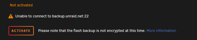

Activate flash backup = Unable to connect to backup.unraid.net:22
Cant get the backup working, always get this error message.
"Unable to connect to backup.unraid.net:22"
any ideas what to try?
So far i've tried updating,  log out and in from my servers, restarting in terminal, but it always returns the same error when i press activate.

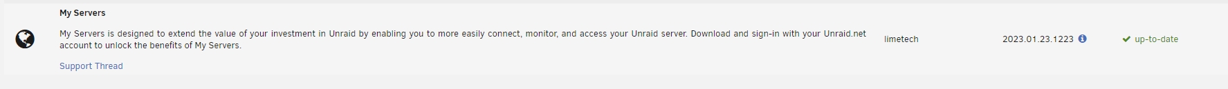

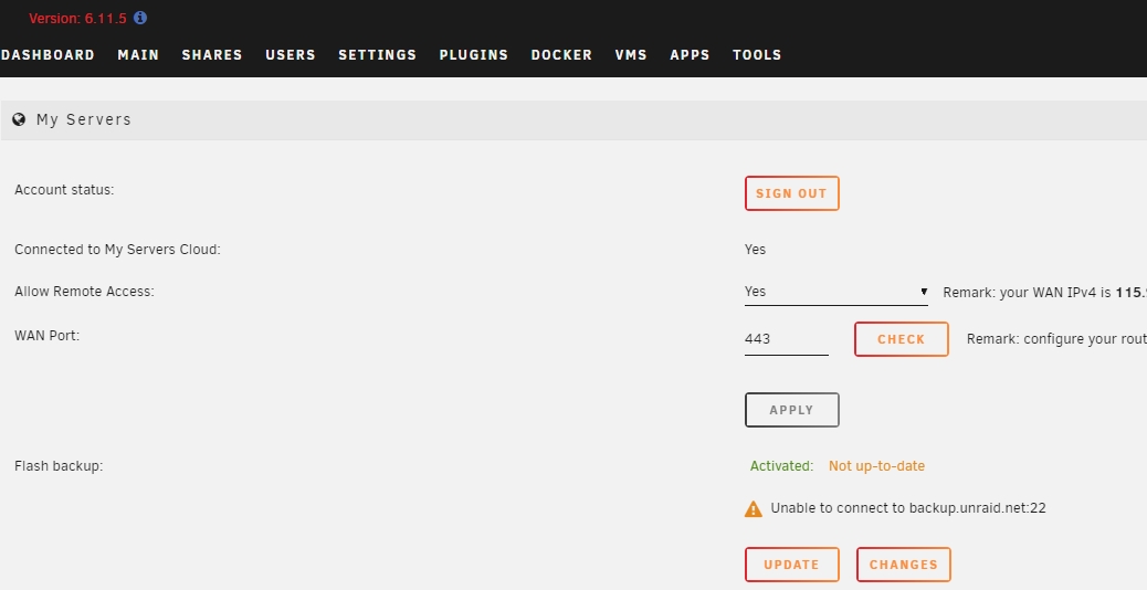

This thread is from a few versions ago so things have changed a bit. Please make sure you have the latest version of the plugin and then post a screenshot of your issue
Hi, here are pics showing the plugin version and the error
