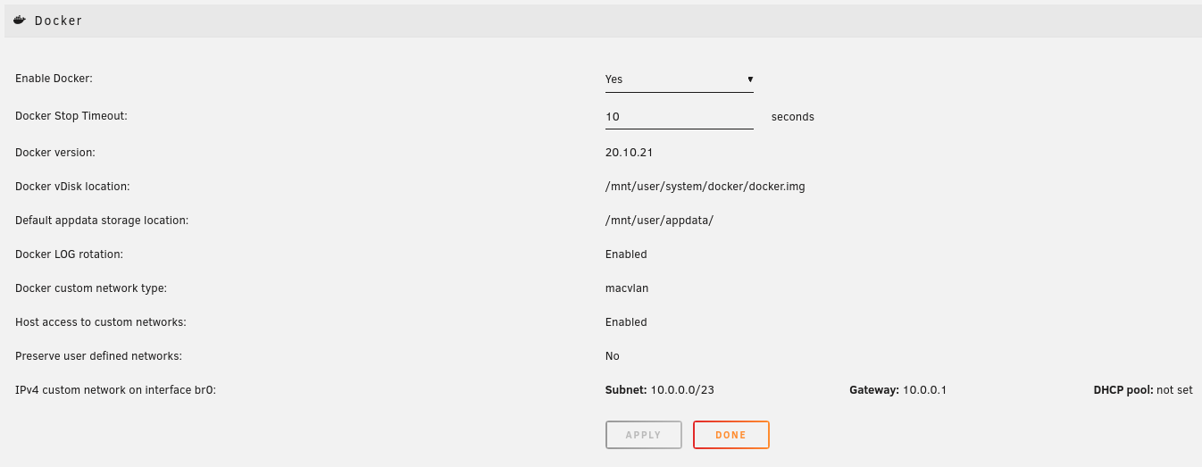

6.11.4 hangs on HPE ProLiant MicroServer Gen10 Plus
CorruptComputer replied to CorruptComputer's topic in General Support
Ah I see, thanks for letting me know! I found the option you said to change, but for me it is not able to be changed: -

I'm running on br0 because I want each of the containers to have a separate IP address that I specify. There are multiple containers running web servers on port 80, so it wouldn't be even possible to have them all running without separate IP's. I don't understand why containers running on br0 are blocked from accessing the host IP, there should be no reason as to why I can't allow that network traffic to just be routed from that virtual bridge to the router and back to the Unraid IP.
