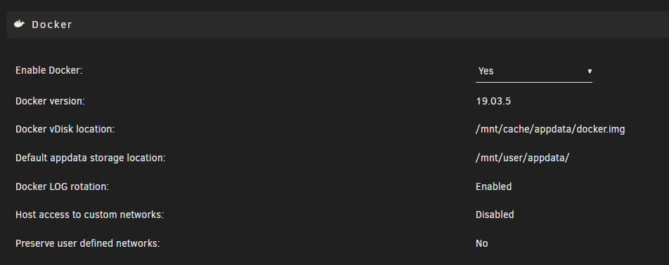

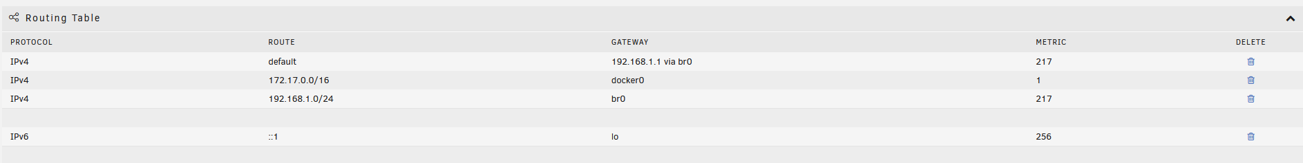

I think it may be an issue with the default route table, but I have no idea what I should change here:

However, have you tried enabling host access to custom networks in Docker Settings?
This fixed it, thanks!
