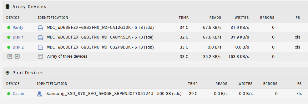

  8. Every time I shut off all my docker containers and VMS and while not accessing any data, the server continues to initiate a read/write at very small speeds (a couple dozen kb/s at most) every 3 seconds or so from disk 1 + parity (no reading on disk 2 at all). How can I find out what is causing these readings? My appdata, domains, and system shares are all solely in the cache drive.
