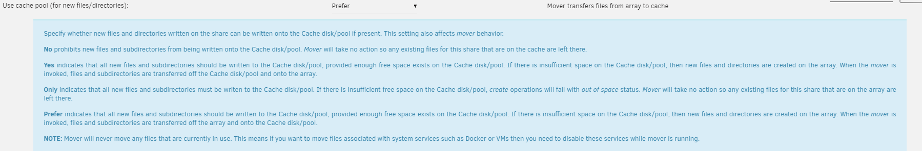

  1. Hey, I'm also a bit of a noob, but I might be able to help a bit. 1) I read the same guide. The /mnt/user/appdata** path is identical to the /mnt/cache/appdata** path, assuming that your appdata is stored on cache. You can tell this by going to the cache drive in "Main" and clicking the windows explorer-esque logo on the right to see what data is stored on it. You can then go to "Shares" and just sanity check within the share the "use cache pool" setting (see below). Going back to the /mnt/user vs /mnt/cache discussion, the reason that I've read this is a worthwhile change is that the /mtn/cache path is a more "direct" route for want of a better description, to the data, and via /mnt/user which I believe hits a few other sub-systems before ultimately hitting the cahce. I wish I could help on 2) - I know nothing
