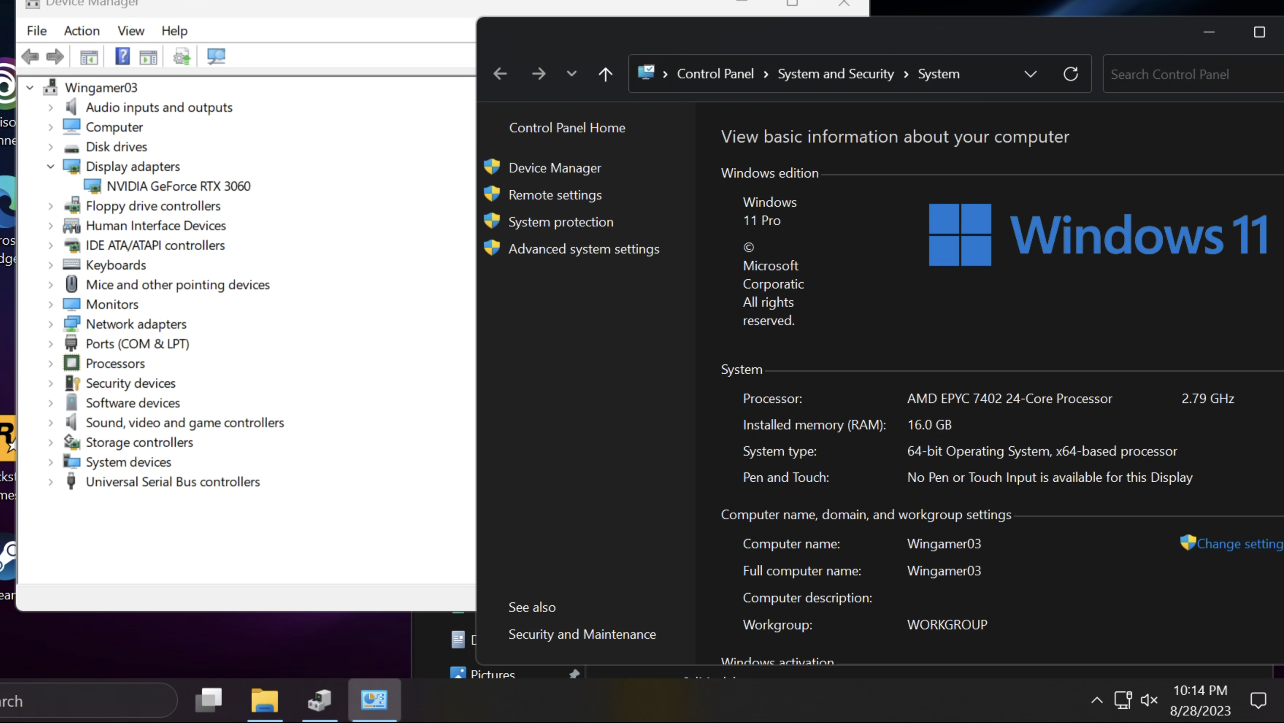

  4. Ok Success! Im still testing for stability but i was able to successfully get the GPU passed without any issues using this guide The Main issue that i had that was unique to me was that i had some type of power saving script for nvidia that started during boot up nvidia power save hourly/script that i had running at boot up from the user scripts. I've disabled and deleted it since finding out it was the culprit. Notes: 1. I can confirm that you can get a 3060 working with ASROCKRACK EPYCD8 2. You do not need a patched vbios. 3. multifunction='on' for GPU is needed for stability and useability. 4. Disable everything including docker, user scripts and all vm guests when debugging. 5. Check you diagnostics files and audit your own configurations
  5. I've had a working setup with a 1080 TI Windows 10 and Windows 11 setup but I wanted to go a more power efficient route so i got the 3060. Thats when i could not get it successfully past the Nvidia 43 error. I can get the machine powered on and showing the desktop with the system device using teamviewer. But i could get get past the nvidia 43 error. ASRockRack EPYCD8 American Megatrends Inc., Version P2.40 BIOS dated: Tue 28 Apr 2020 12:00:00 AM PDT EVGA GeForce RTX 3060 XC GAMING 12GB GDDR6 Graphics Card Notes: - Binded the GPU IOMMU group 78 and 79 1. I've created a new VM guest machine and installed all the drivers for the machine 2. Installed the latest Nvidia Drivers and got the (Error 43) 3. Tried creating a new VM guest and unzipped the installer files and tried to install Nvidia drivers and still no change (Error 43) 4. Tried dumping the vga bios successfully and tried attaching it to the VM guest, using space invaders script (Error 43) 5. Tried using the dumped VGA bios and patching it (Error 43) 6. Updated the VM guest to use the multifunction='on' and updated the Slot's and function info (Error 43) Anyone help would be appreciated!! Boot Setup Unraid OS kernel /bzimage append initrd=/bzroot video=vesafb:off video=efifb:off acpi_enforce_resources=lax vfio_iommu_type1.allow_unsafe_interrupts=1 pcie_acs_override=multifunction VM guest Setup <?xml version='1.0' encoding='UTF-8'?> <domain type='kvm' id='3'> <name>Wingamer01</name> <uuid>4ef502f7-ca5b-cc21-2833-b93c0aee9c34</uuid> <metadata> <vmtemplate xmlns="unraid" name="Windows 11" icon="windows11.png" os="windowstpm"/> </metadata> <memory unit='KiB'>16777216</memory> <currentMemory unit='KiB'>16777216</currentMemory> <memoryBacking> <nosharepages/> </memoryBacking> <vcpu placement='static'>16</vcpu> <cputune> <vcpupin vcpu='0' cpuset='0'/> <vcpupin vcpu='1' cpuset='24'/> <vcpupin vcpu='2' cpuset='1'/> <vcpupin vcpu='3' cpuset='25'/> <vcpupin vcpu='4' cpuset='2'/> <vcpupin vcpu='5' cpuset='26'/> <vcpupin vcpu='6' cpuset='3'/> <vcpupin vcpu='7' cpuset='27'/> <vcpupin vcpu='8' cpuset='4'/> <vcpupin vcpu='9' cpuset='28'/> <vcpupin vcpu='10' cpuset='5'/> <vcpupin vcpu='11' cpuset='29'/> <vcpupin vcpu='12' cpuset='6'/> <vcpupin vcpu='13' cpuset='30'/> <vcpupin vcpu='14' cpuset='7'/> <vcpupin vcpu='15' cpuset='31'/> </cputune> <resource> <partition>/machine</partition> </resource> <os> <type arch='x86_64' machine='pc-i440fx-7.1'>hvm</type> <loader readonly='yes' type='pflash'>/usr/share/qemu/ovmf-x64/OVMF_CODE-pure-efi.fd</loader> <nvram>/etc/libvirt/qemu/nvram/4ef502f7-ca5b-cc21-2833-b93c0aee9c34_VARS-pure-efi.fd</nvram> </os> <features> <acpi/> <apic/> <hyperv mode='custom'> <relaxed state='on'/> <vapic state='on'/> <spinlocks state='on' retries='8191'/> <vendor_id state='on' value='none'/> </hyperv> </features> <cpu mode='host-passthrough' check='none' migratable='on'> <topology sockets='1' dies='1' cores='8' threads='2'/> <cache mode='passthrough'/> <feature policy='require' name='topoext'/> </cpu> <clock offset='localtime'> <timer name='hypervclock' present='yes'/> <timer name='hpet' present='no'/> </clock> <on_poweroff>destroy</on_poweroff> <on_reboot>restart</on_reboot> <on_crash>restart</on_crash> <devices> <emulator>/usr/local/sbin/qemu</emulator> <disk type='file' device='disk'> <driver name='qemu' type='qcow2' cache='writeback'/> <source file='/mnt/user/domains/Wingamer01/vdisk1.img' index='3'/> <backingStore/> <target dev='hdc' bus='virtio'/> <serial>vdisk1</serial> <boot order='1'/> <alias name='virtio-disk2'/> <address type='pci' domain='0x0000' bus='0x00' slot='0x04' function='0x0'/> </disk> <disk type='file' device='cdrom'> <driver name='qemu' type='raw'/> <source file='/mnt/user/isos/WIN11.PRO.22H2.SUPERLITE+SE+COMPACT.U10.(WPE+).ISO' index='2'/> <backingStore/> <target dev='hda' bus='ide'/> <readonly/> <boot order='2'/> <alias name='ide0-0-0'/> <address type='drive' controller='0' bus='0' target='0' unit='0'/> </disk> <disk type='file' device='cdrom'> <driver name='qemu' type='raw'/> <source file='/mnt/user/isos/virtio-win-0.1.229-1.iso' index='1'/> <backingStore/> <target dev='hdb' bus='ide'/> <readonly/> <alias name='ide0-0-1'/> <address type='drive' controller='0' bus='0' target='0' unit='1'/> </disk> <controller type='usb' index='0' model='ich9-ehci1'> <alias name='usb'/> <address type='pci' domain='0x0000' bus='0x00' slot='0x07' function='0x7'/> </controller> <controller type='usb' index='0' model='ich9-uhci1'> <alias name='usb'/> <master startport='0'/> <address type='pci' domain='0x0000' bus='0x00' slot='0x07' function='0x0' multifunction='on'/> </controller> <controller type='usb' index='0' model='ich9-uhci2'> <alias name='usb'/> <master startport='2'/> <address type='pci' domain='0x0000' bus='0x00' slot='0x07' function='0x1'/> </controller> <controller type='usb' index='0' model='ich9-uhci3'> <alias name='usb'/> <master startport='4'/> <address type='pci' domain='0x0000' bus='0x00' slot='0x07' function='0x2'/> </controller> <controller type='pci' index='0' model='pci-root'> <alias name='pci.0'/> </controller> <controller type='ide' index='0'> <alias name='ide'/> <address type='pci' domain='0x0000' bus='0x00' slot='0x01' function='0x1'/> </controller> <controller type='virtio-serial' index='0'> <alias name='virtio-serial0'/> <address type='pci' domain='0x0000' bus='0x00' slot='0x03' function='0x0'/> </controller> <interface type='bridge'> <mac address='52:54:00:3a:ff:84'/> <source bridge='br0'/> <target dev='vnet2'/> <model type='virtio-net'/> <alias name='net0'/> <address type='pci' domain='0x0000' bus='0x00' slot='0x02' function='0x0'/> </interface> <serial type='pty'> <source path='/dev/pts/1'/> <target type='isa-serial' port='0'> <model name='isa-serial'/> </target> <alias name='serial0'/> </serial> <console type='pty' tty='/dev/pts/1'> <source path='/dev/pts/1'/> <target type='serial' port='0'/> <alias name='serial0'/> </console> <channel type='unix'> <source mode='bind' path='/var/lib/libvirt/qemu/channel/target/domain-3-Wingamer01/org.qemu.guest_agent.0'/> <target type='virtio' name='org.qemu.guest_agent.0' state='disconnected'/> <alias name='channel0'/> <address type='virtio-serial' controller='0' bus='0' port='1'/> </channel> <input type='tablet' bus='usb'> <alias name='input0'/> <address type='usb' bus='0' port='1'/> </input> <input type='mouse' bus='ps2'> <alias name='input1'/> </input> <input type='keyboard' bus='ps2'> <alias name='input2'/> </input> <audio id='1' type='none'/> <hostdev mode='subsystem' type='pci' managed='yes'> <driver name='vfio'/> <source> <address domain='0x0000' bus='0x01' slot='0x00' function='0x0'/> </source> <alias name='hostdev0'/> <rom file='/mnt/user/isos/vbios/nvidia_3060v3_vbios.rom'/> <address type='pci' domain='0x0000' bus='0x00' slot='0x05' function='0x0' multifunction='on'/> </hostdev> <hostdev mode='subsystem' type='pci' managed='yes'> <driver name='vfio'/> <source> <address domain='0x0000' bus='0x01' slot='0x00' function='0x1'/> </source> <alias name='hostdev1'/> <address type='pci' domain='0x0000' bus='0x00' slot='0x05' function='0x1'/> </hostdev> <memballoon model='none'/> </devices> <seclabel type='dynamic' model='dac' relabel='yes'> <label>+0:+100</label> <imagelabel>+0:+100</imagelabel> </seclabel> </domain> unraid01-diagnostics-20230828-0723.zip
