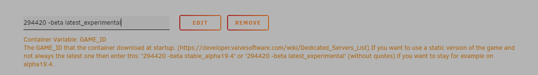

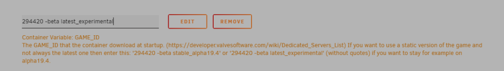

  5. 7Days to die experimental A21 server question I have this option set up for the beta latest but when i try and run it i get the below message and the server never loads but i f i set it to regular "294420" it works fine but its not Alpha21 any hints on what im doing wrong? ---Prepare Server--- ---Moving SaveGameFolder location--- ---Savegame location found--- ---Moving UserDataFolder location--- ---UserDataFolder location found--- ---Server ready--- ---Start Server--- [UnityMemory] Configuration Parameters - Can be set up in boot.config "memorysetup-bucket-allocator-granularity=16" "memorysetup-bucket-allocator-bucket-count=8" "memorysetup-bucket-allocator-block-size=4194304" "memorysetup-bucket-allocator-block-count=1" "memorysetup-main-allocator-block-size=16777216" "memorysetup-thread-allocator-block-size=16777216" "memorysetup-gfx-main-allocator-block-size=16777216" "memorysetup-gfx-thread-allocator-block-size=16777216" "memorysetup-cache-allocator-block-size=4194304" "memorysetup-typetree-allocator-block-size=2097152" "memorysetup-profiler-bucket-allocator-granularity=16" "memorysetup-profiler-bucket-allocator-bucket-count=8" "memorysetup-profiler-bucket-allocator-block-size=4194304" "memorysetup-profiler-bucket-allocator-block-count=1" "memorysetup-profiler-allocator-block-size=16777216" "memorysetup-profiler-editor-allocator-block-size=1048576" "memorysetup-temp-allocator-size-main=4194304" "memorysetup-job-temp-allocator-block-size=2097152" "memorysetup-job-temp-allocator-block-size-background=1048576" "memorysetup-job-temp-allocator-reduction-small-platforms=262144" "memorysetup-temp-allocator-size-background-worker=32768" "memorysetup-temp-allocator-size-job-worker=262144" "memorysetup-temp-allocator-size-preload-manager=262144" "memorysetup-temp-allocator-size-nav-mesh-worker=65536" "memorysetup-temp-allocator-size-audio-worker=65536" "memorysetup-temp-allocator-size-cloud-worker=32768" "memorysetup-temp-allocator-size-gfx=262144"
