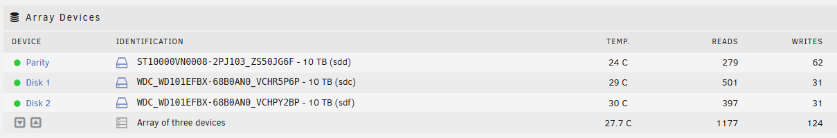

so here goes the long version why i want to know that: I have read many bug reports of this, but nothing ever came of it in any thread. its always the plugins, the vms, a docker container etc. Well, as with so many people not for me, it could not be pinned to any of those culprits. I have booted in safe mode, i have manually disabled docker and vm service, no mover, no script, my appdata and system shares are on cache only and i have made sure not a single computer on my network is connected to a share and still, the data disks keep spinning up again and again. the funny thing is i have tried so many hours to find out why and nothing came of it. i checked with open streams plugin - nothing. i checked with disk activity plugin - nothing. i have even made a new config just to be sure... even unraids own gui did not increase read or write counts for 2 consecutive spindown/spinup cycles. i am completely lost with this and i still dont think anybody can help me, but i refuse to let this one go without at least opening up another bug report as so many have done before me with no help. here are my diagnostics, although they wont help you im afraid. i know i know, smart only reads when the disk is active and so on... every bug report was full of it. well as i have detailed above, NOTHING accessed the disks when they spun up. so either its a bug or something with smart does not work. i am convinced its smart because it also had trouble displaying the drive temps correctly with my raid controller (in hba mode). what makes me believe its not an issue with my raid card or other hardware is that parity stays spun down. please just let me disable smart reading and see if the disks keep spun down. hp-diagnostics-20220911-2334.zip

parity is a 10 tb seagate ironwolf, the 2 data disks are 10 tb wd red. all connected via the hp p840 raid controller in hba mode. something about the raid controller is already fishy, as for smart data i had to manually set all drives to smart controller type = sat to show temperatures on the main tab, although with default smart also worked but would only show * in main tab as temperature.

i did that now, plex docker was also offline for good measure. disks came back from spindown twice BUT: read and write counter did not increase. so now i suspect that my wd red drives do not spin down correctly or at lease report their status wrong... that would also fit to my observation that parity does not spin up on its own. coicidentally, this is an ironwolf drive, not a wd red... i wish i had more ironwolfs for testing this theory... what i would like to try next is disabling smart. i know that smart should skip spun down disks, but maybe the problem is there. if it was "real" disc access, i would assume the read counter would increase. unfortunately i have no idea how i would do that... do you know by any chance? i know its not a good thing to do and in the long run id rather have spun up disks and smart reporting, but i would sleep easier when i know what causes the spin up. anyways, diagnostics is attached. thanks for your investment in this issue! hp-diagnostics-20220116-1739.zip
