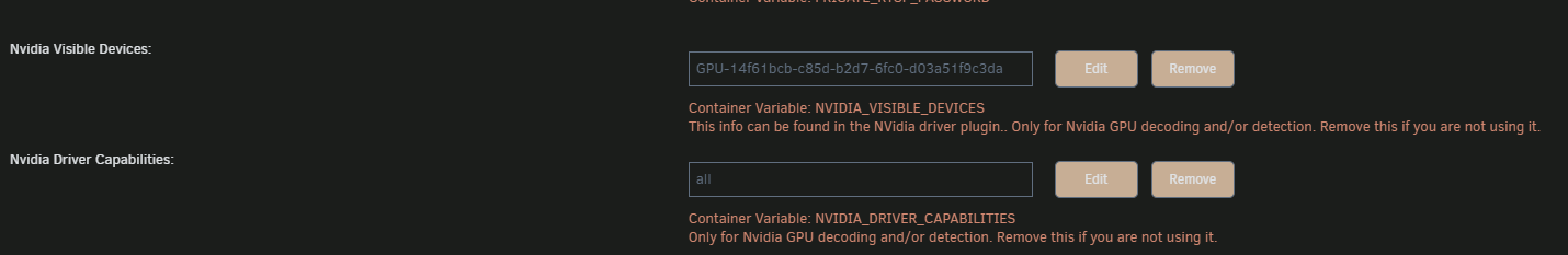

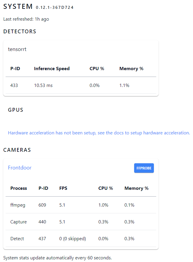

  7. Frigate doesn't seem to be detecting my nvidia GPU for hardware acceleration when checking the frigate system information This is my extra parameters line "--shm-size=256mb --mount type=tmpfs,target=/tmp/cache,tmpfs-size=1000000000 --restart unless-stopped --runtime=nvidia" I have entered the GPU ID and the set the capabilities to all. This is also the same when the capabilities are set to 'compute,utility,video' nvidia-smi on the unraid terminal shows the ffmpeg process for the 1 camera I currently have and also the tensorrt detector process I also have the hardware acceleration args like this in the frigate config: ffmpeg: hwaccel_args: - -hwaccel - cuda - -c:v - h264_cuvid Unsure of where to go next?
