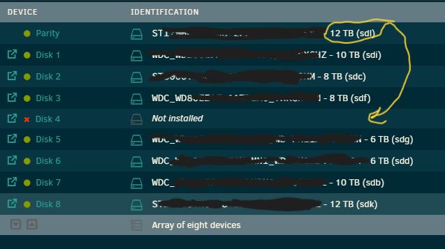

  4. unraidi5-diagnostics-20240713-1034.zip here it is.
