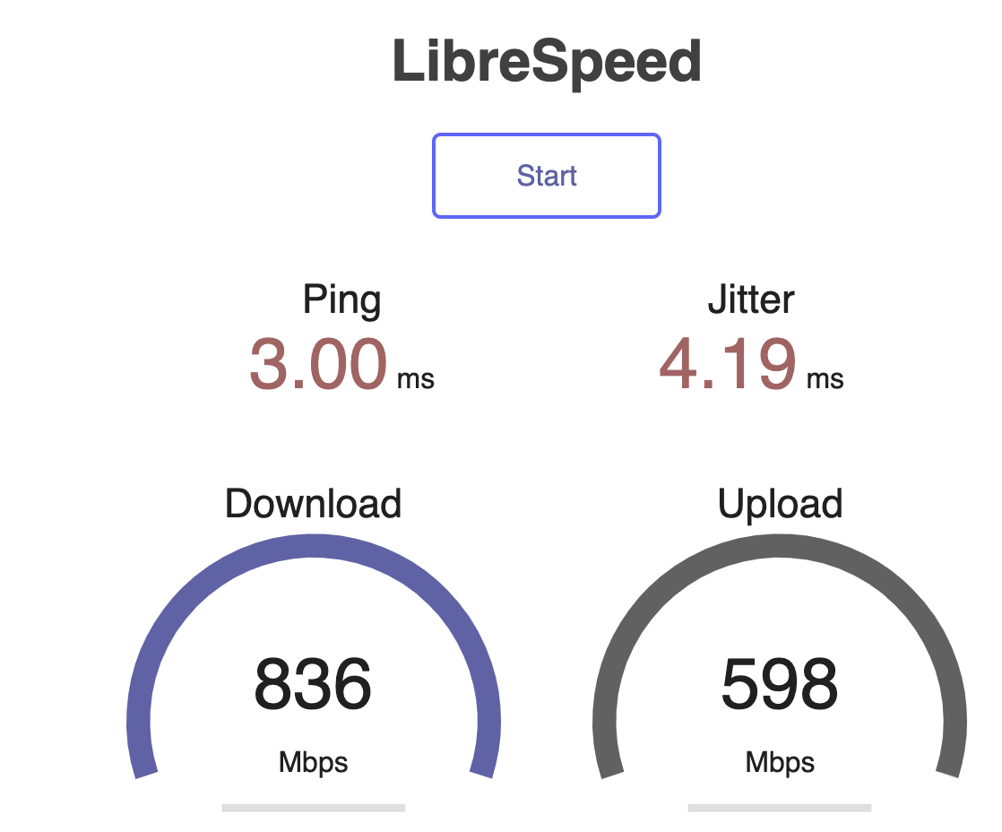

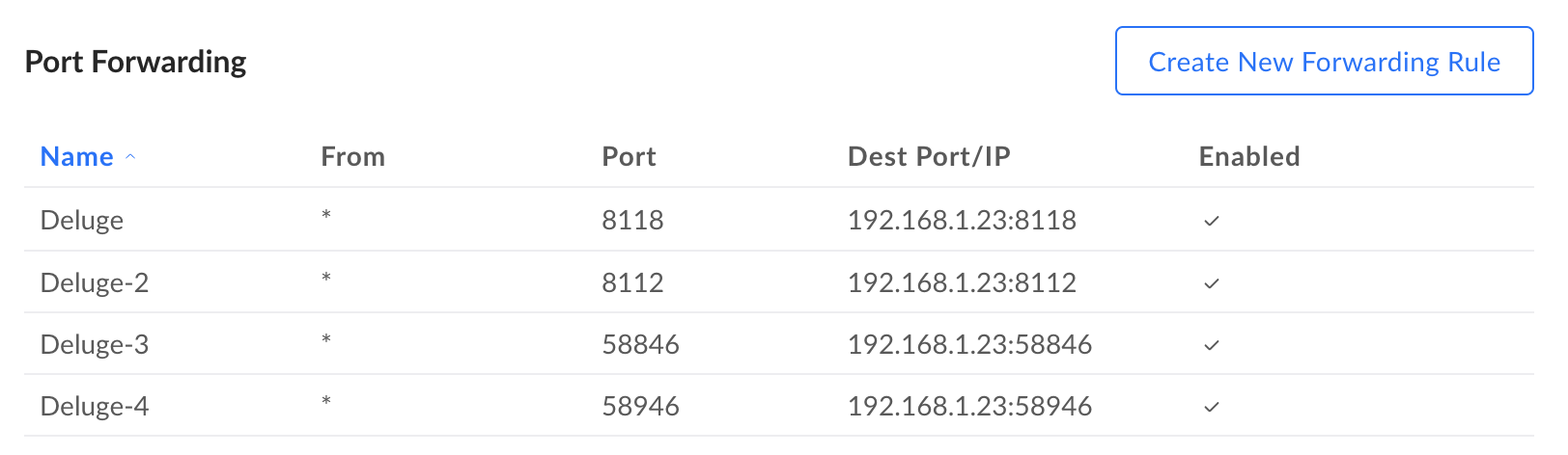

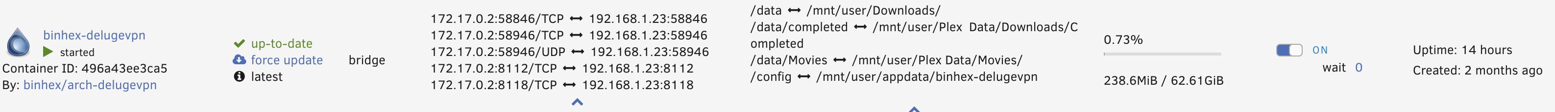

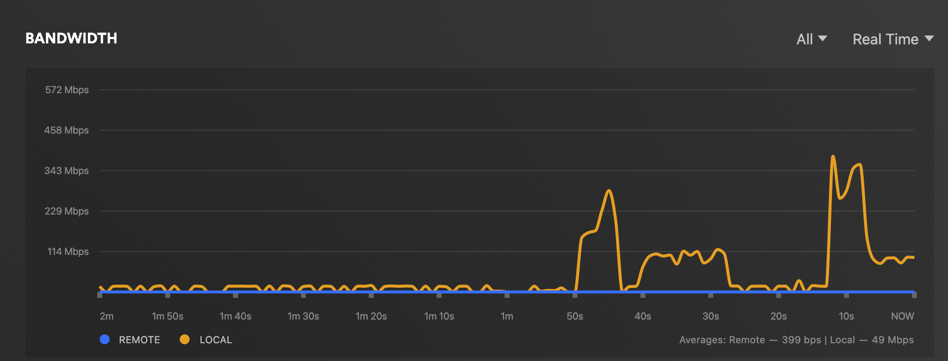

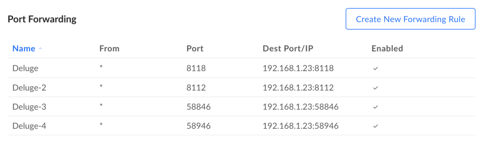

Hi. Not sure if I am posting in the right spot but I've been having issues with binhex-delugevpn docker and slow download speeds ever since I transitioned to a new Ubiquiti router/network switch setup in my house. I thought I enabled all the required port forwarding rules but it just isn't performing. I tested downloading two identical torrents one on my laptop directly and one using delugevpn on my UNRAID (both connected to same VPN location server) and deluge had trouble connecting to the torrent even while my laptop using transmission downloaded at over 20MB/s within 30 seconds of starting torrent. I used to get 40-50MB/s+ in download speeds and now I never get above a combined 4-5MB/s or it just won't connect period to those seeding (new releases with thousands of seeders in RARBG website search, not files with 1 or 2 seeders). I'm not sure what gives but hoping others can help point me in right direction. I tried it-config plugin but upload speeds are way low. I have a gigabit internet connection and laptop is on Wi-Fi while server is hardwired. I don't know if this speedtest docker is testing my laptop I'm accessing it from or the actual server but posted a screenshot of that too. I read some posts about kinked cables reverting to 100mbs speeds but if that was the case shouldn't I not be able to register this internet speed in a test or play 4K Remux videos on direct play even locally in Plex? Any ideas?

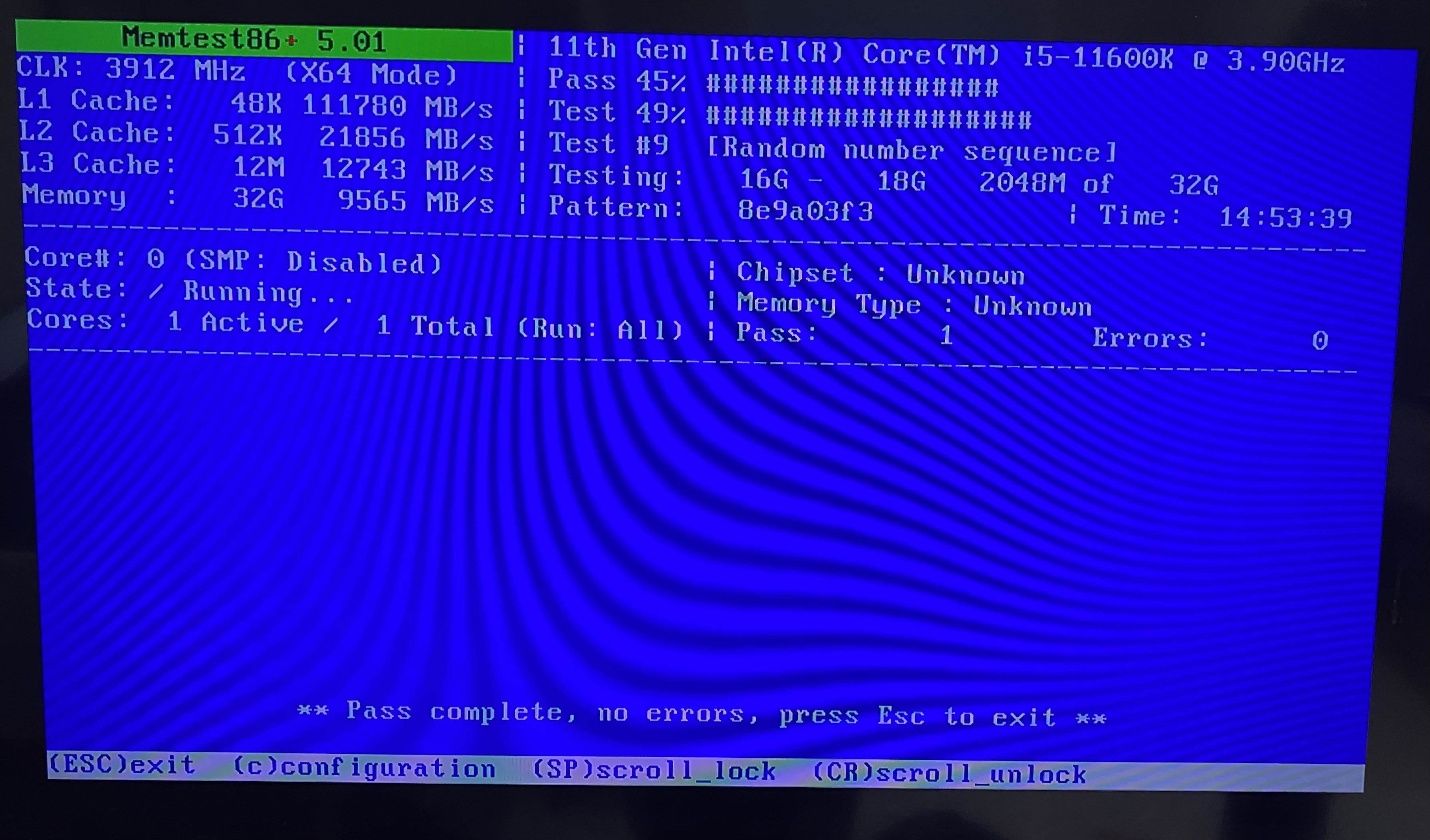

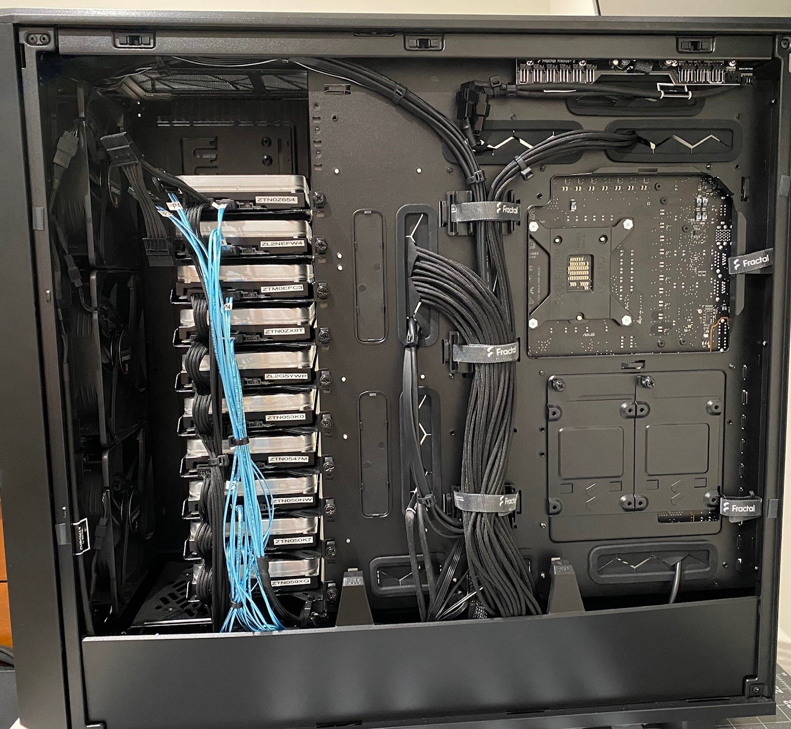

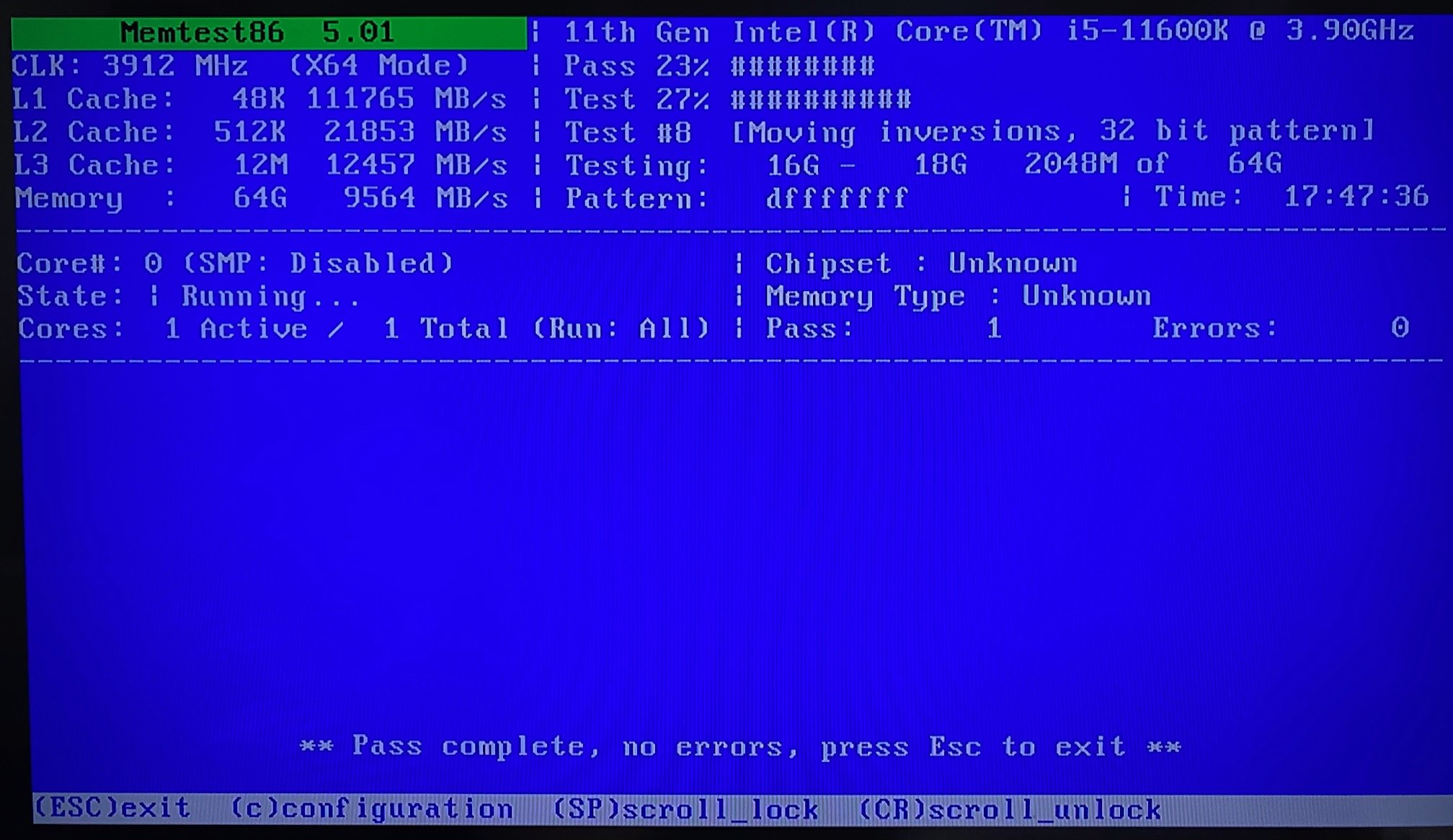

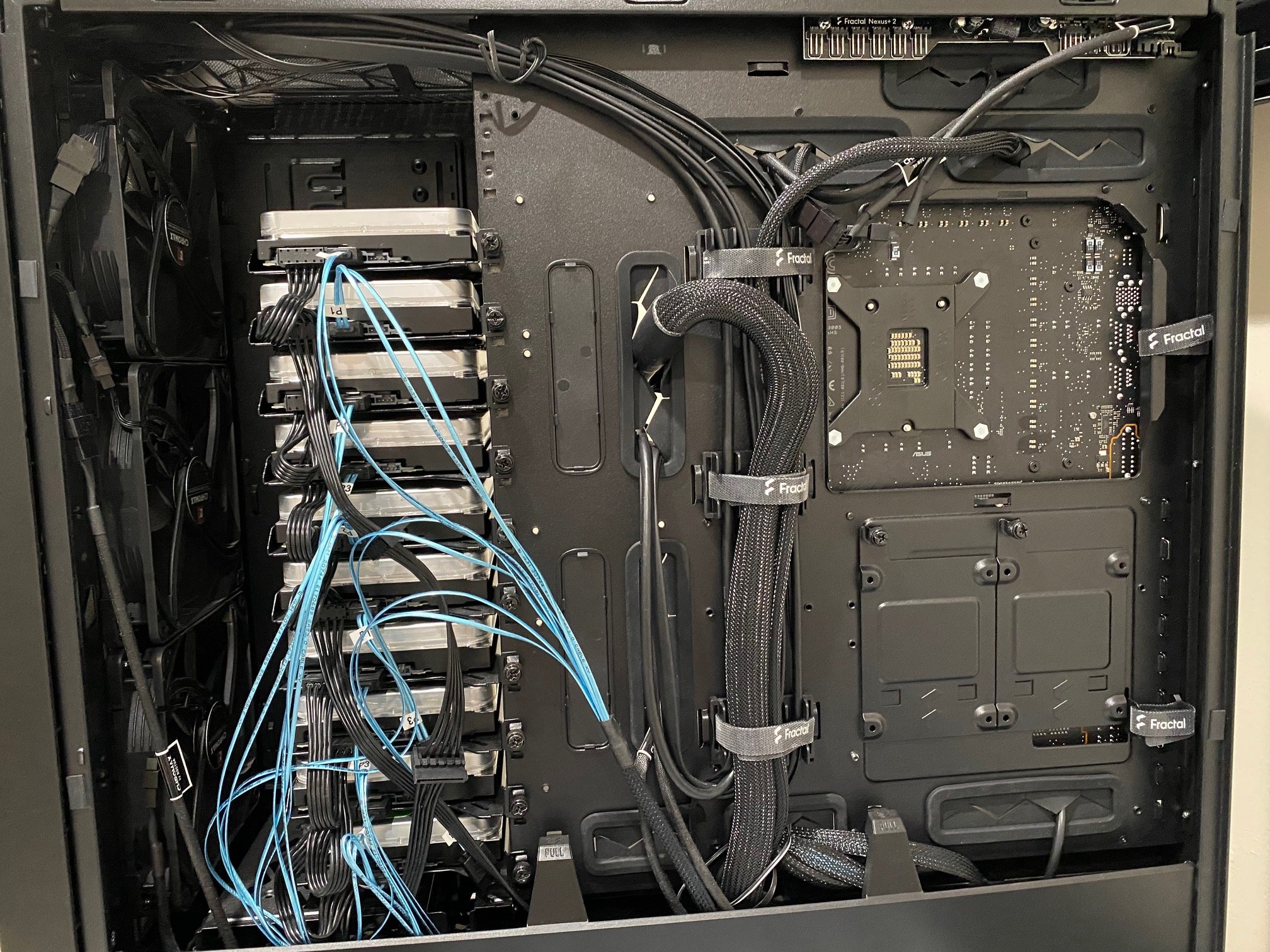

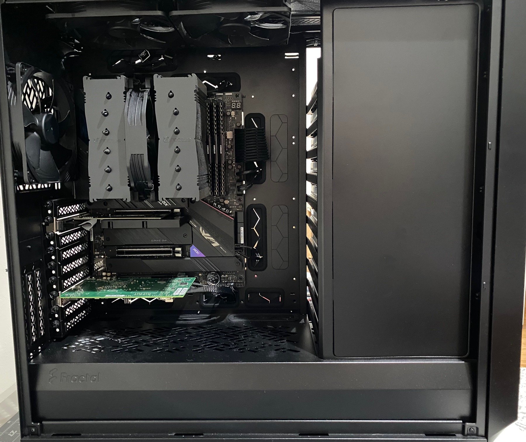

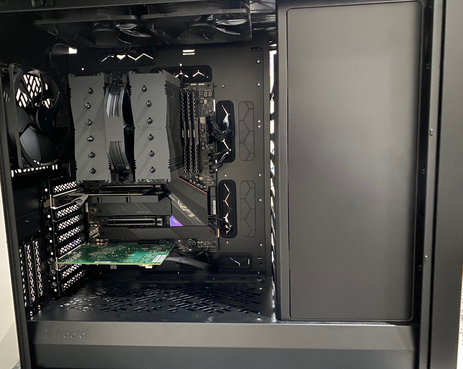

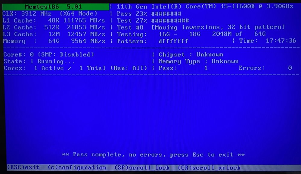

Yay! Memtest ran for over 17 hours and found no errors with all 4 sticks installed. With that result I went ahead and booted up UNRAID and installed the new drive for disk5. Rebuild process underway - estimated time to complete is 1 day 13 hours. I also cleaned up the wiring job in the case and added labels to the hard drives with their respective serial numbers so don't ever have to guess at what disk is in what slot. Before and after pictures attached.

2 sticks from the Corsair kit I grabbed on Amazon passed memtest after 14 hours with no errors. Wahoo! Test starting now for all 4 sticks of the new RAM. Really didn't expect the RAM to pass given challenges with the G.Skill sticks I was using before and all 4 sticks seemingly having issues. Thought test was going to throw errors and I was going to need a new mobo. Will find out tonight if I'm going to be able to stick replacement disk5 back in tonight once the memtest with all 4 DIMM slots filled completes. UPDATE: 3.5 hours into test with all 4 sticks and no errors so far. UPDATE 2: 6.5 hours into test with all 4 sticks and no errors so far.

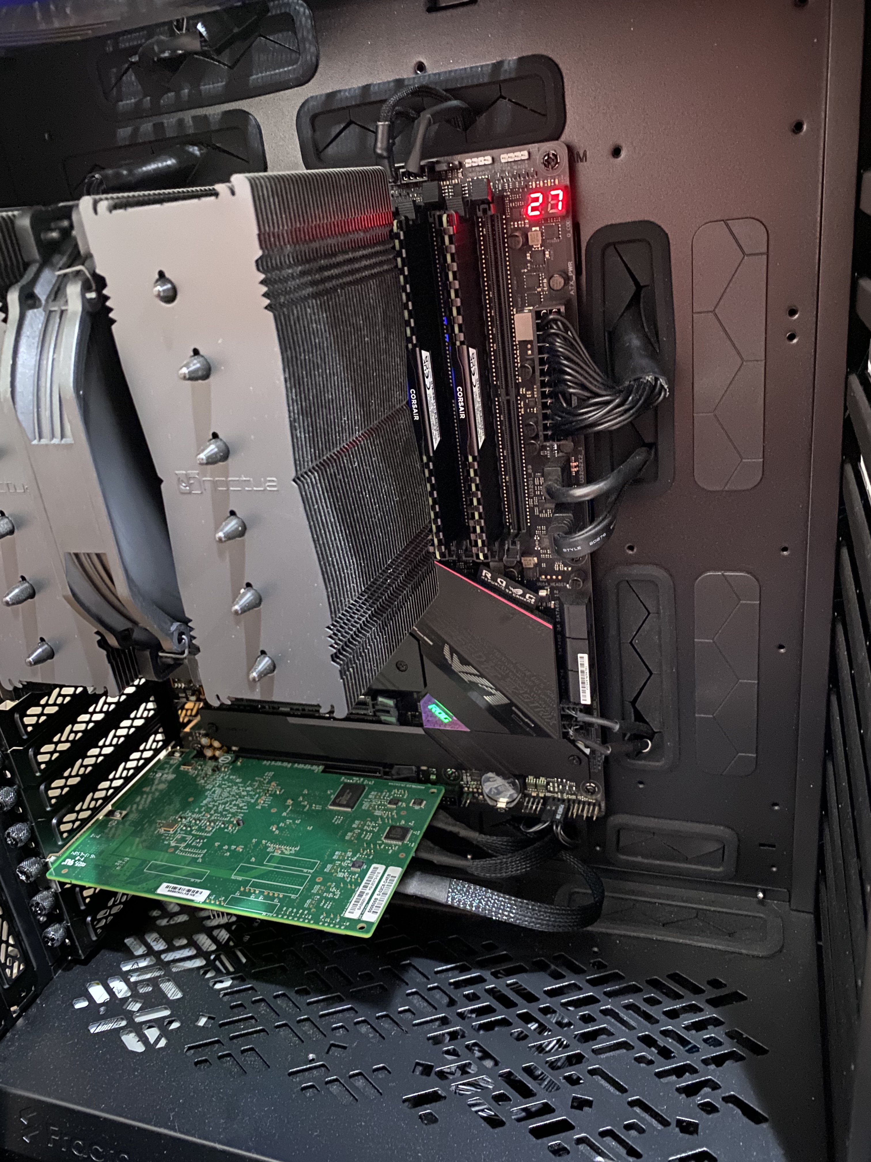

New sticks arrived. First two have been installed in slots 1 & 3. and Memtest has been started. Confirmed bios is set at the SPD settings (timing, frequency and voltage) for this memory as well. CPU running cool as cucumber at only 27 degrees haha. They do match black vibe better than the G Skill and always annoyed me on the G Skill one of the sticks always was out of sync with the other 3. Do wish HBA cards were black. About 10 minutes in so far and no errors. Next update will be if this test fails without lasting 12 hours or that it passed 12+ hours with no errors and I am starting next test with 4 sticks.

I think I found my bad stick. Got lucky it was narrowed down quickly. Removed DIMMs 2 & 4 leaving in DIMMs 1 & 3. Ran memtest again and errors within 5 mins. Powered down, replaced DIMM 1 with DIMM 2 and errors within 5 mins. Powered down, swapped out DIMM 3 for DIMM 1 and running DIMM 1 & 2 now and no errors so far after 10 minutes. Hopefully that easy but will let it run 12+ hours as suggested to be safe before I try and swap out disk5. Can also now say it is possible to remove a memory stick from DIMM 1 slot around a Noctua NH-D15S without removing it from the CPU. Barely enough room! Luckily didn't mess up any of the aluminum fins either. Felt like a game of operation when I was a kid but instead of a buzzer sound it's a cut knuckle and dollar signs. I think I will take this downtime after memtest completes to install the custom wiring I ordered from cablemod a while back as a present to myself. May be a server but doesn't mean it can't look good at the same time... UPDATE: 30 minutes in and no errors so far with combination of DIMMS 1 & 2. DIMM 3 seems to be the culprit.
