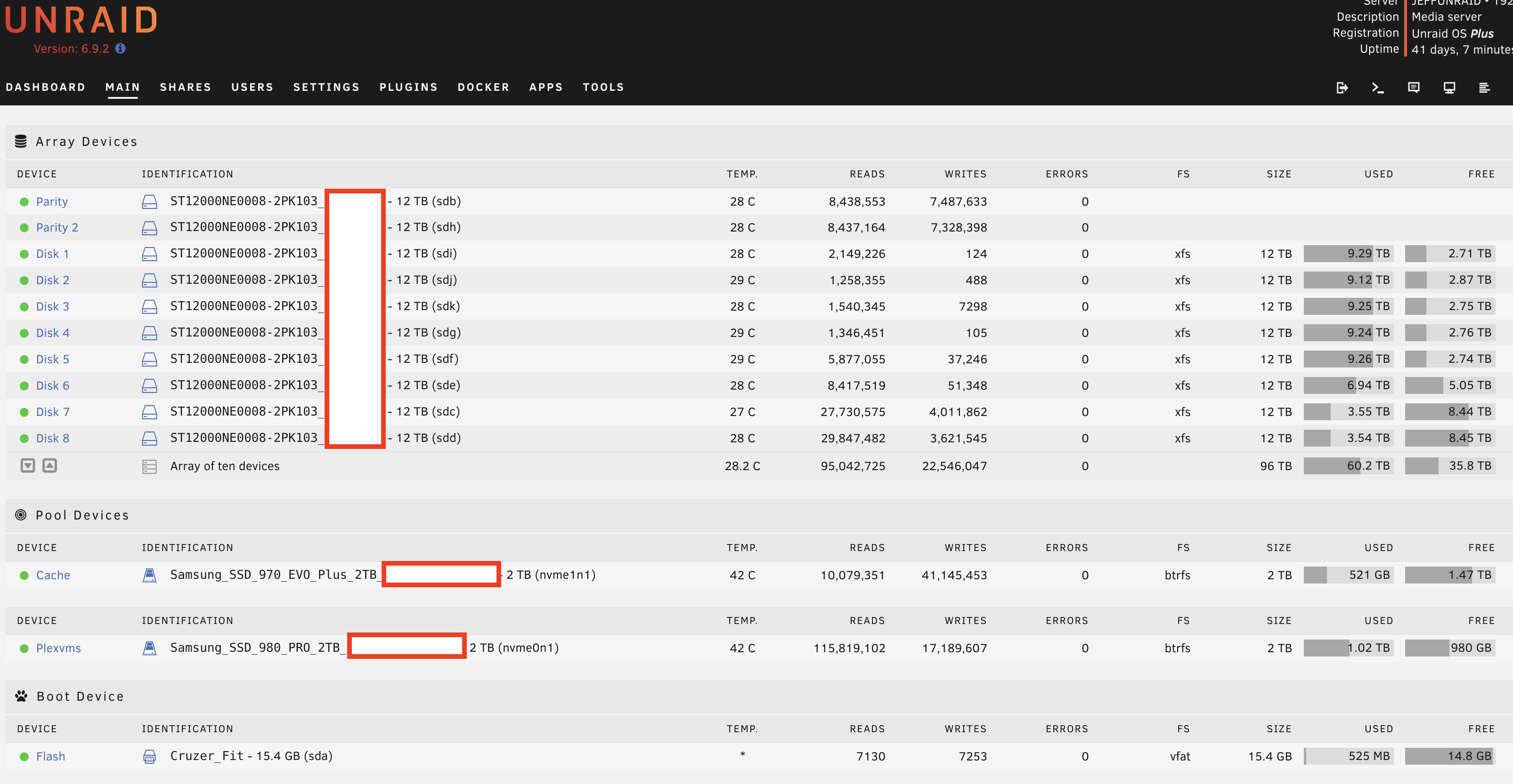

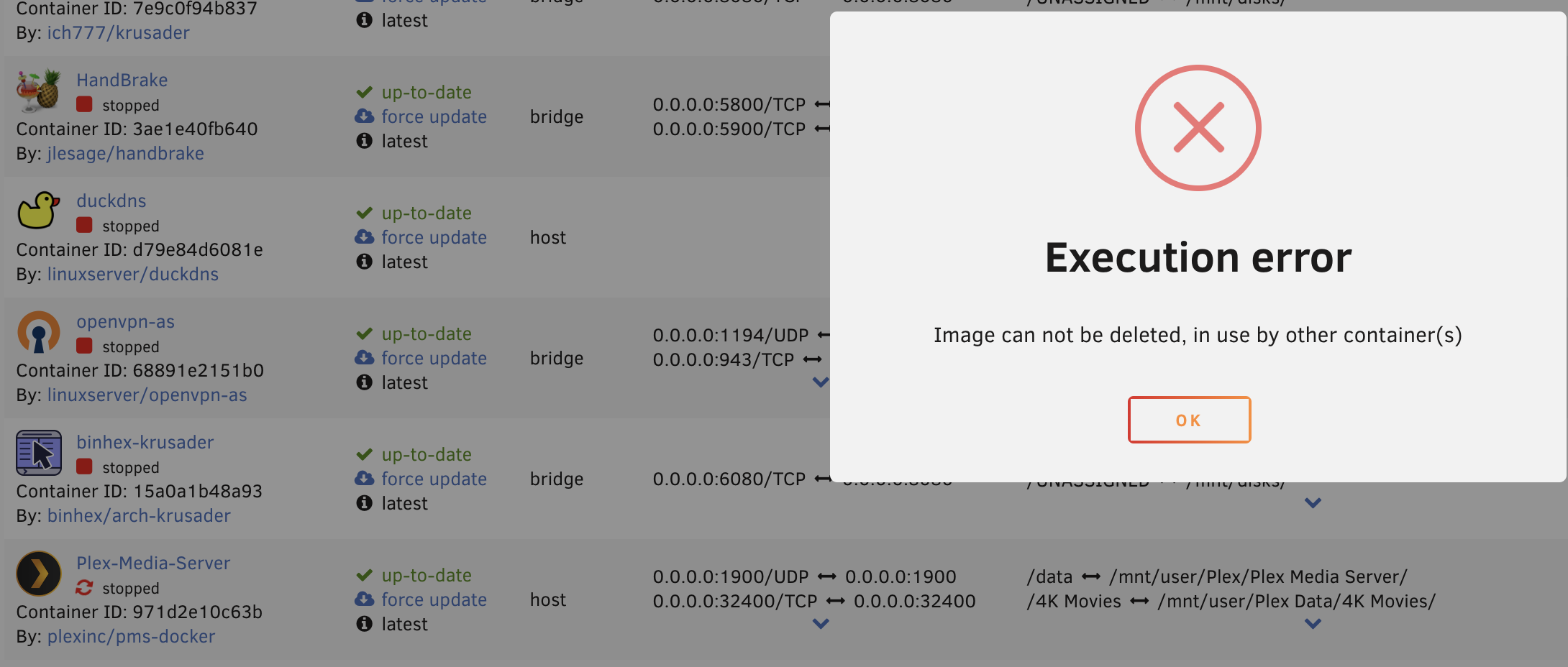

Screenshot below showing error when trying to start a docker and available space on the drives.  Wanted to reach out as I am not an UNRAID expert and didn't want to just delete docker image turning dockers on and off unless that was the best first step.  Didn't seem to work last time for me when this issue cropped up few months ago and I tried doing that after seeing it in video.

Unrelated, but your appdata share has files on both pools. Not sure if that is what you intend or not. Mover ignores any pool not designated for the share, and nothing can move open files.
I don't think I did intend for any appdata to be on the data drives.  Isn't appdata supposed to live on cache drive (2TB 970)?  I only wanted Plex data files to be on the 2nd nvme (2TB 980 named plexvms) since I wasn't sure initially how big it would get I added more data drives/content and I don't currently have any VMs installed.
Your appdata is configured to prefer plexvms. It has files on both plexvms and cache.

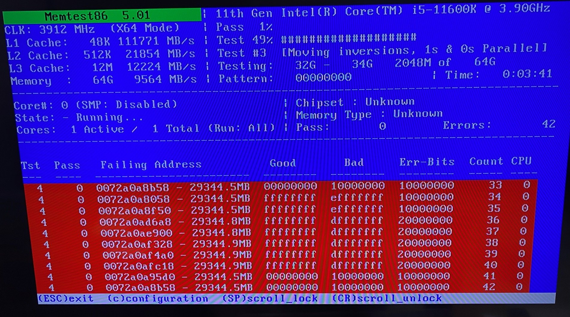

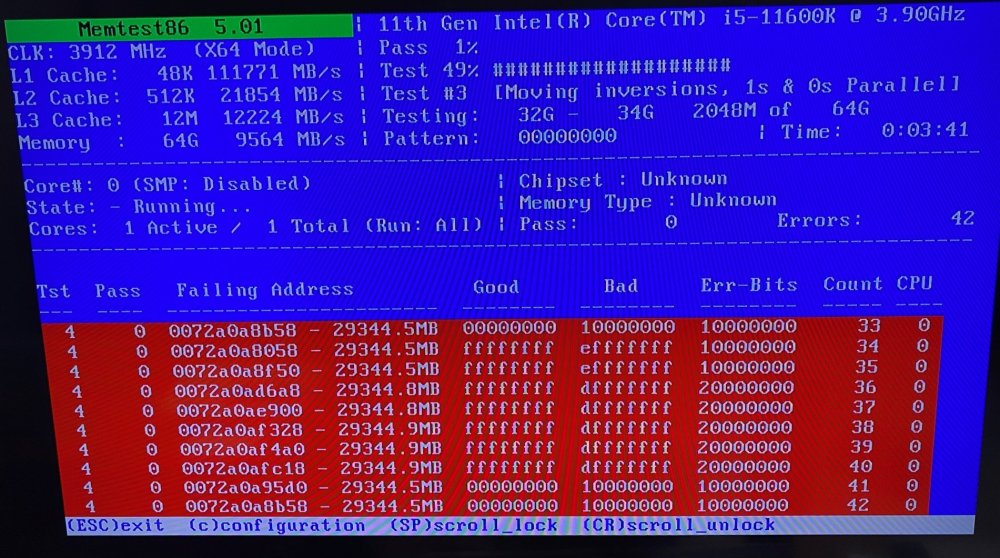

Memtest is running now - already throwing a bunch of errors.  Screenshot attached. When this happens that means you need new RAM?  Any recommendations to go along with my board and CPU combo?  I can also try to RMA this G. Skill stuff if that is better vs buying new stuff but don't know if 1 or all sticks are bad to RMA? Hate to be down because of RAM of all things lol.
Have the replacement 12tb ironwolf pro for disk5 ready to go in
Do not allow writes to any drives until your memory test is totally clean. Bad RAM will cause data corruption.

Since you have 64GB, I'd remove 32 and run memtest again, it's possible the full load of 4 sticks is causing issues. Typically if you have a bad stick of RAM, it's just one stick that needs to be replaced. Run memtest with pairs until you narrow down what's happening with each stick. It's also possible none of the sticks are bad, but your motherboard needs tweaks to run stable with all 4 populated.
Regardless of how you do it, don't continue using the system until you get an extended run of memtest with 0 errors. Preferably 12+ hours.
If your time is more valuable than the computer parts, start firing the parts cannon and get stuff on order, starting with RAM and possibly more. I deal with clients on both ends of the spectrum in my business, some want to spend as little money as possible and are OK with extended downtime, others just want the issue fixed now, even if it means replacing everything in the box.

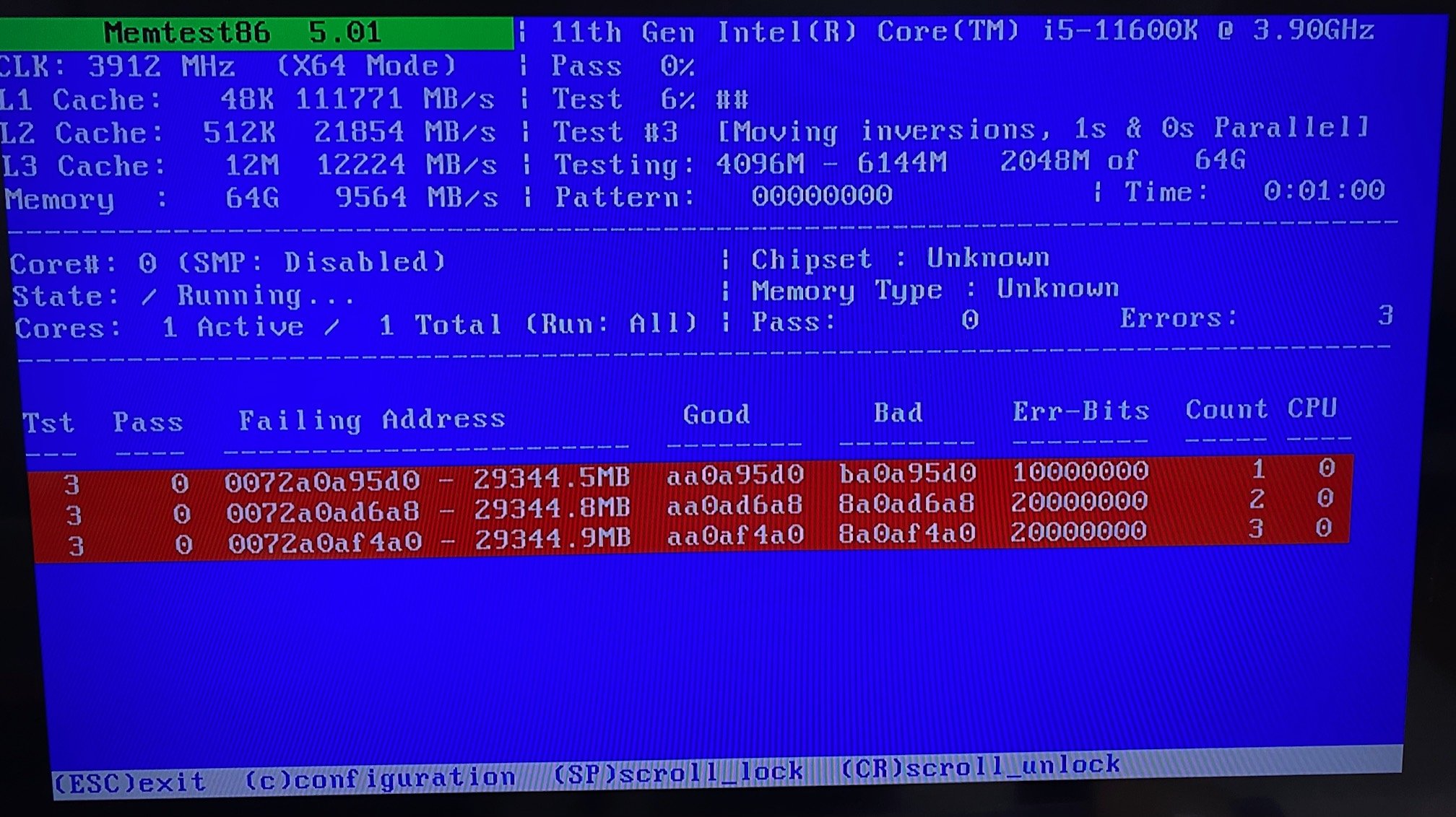

I think I found my bad stick. Got lucky it was narrowed down quickly.
Removed DIMMs 2 & 4 leaving in DIMMs 1 & 3. Ran memtest again and errors within 5 mins. Powered down, replaced DIMM 1 with DIMM 2 and errors within 5 mins. Powered down, swapped out DIMM 3 for DIMM 1 and running DIMM 1 & 2 now and no errors so far after 10 minutes.  Hopefully that easy but will let it run 12+ hours as suggested to be safe before I try and swap out disk5.

UPDATE: 30 minutes in and no errors so far with combination of DIMMS 1 & 2. DIMM 3 seems to be the culprit.

Crap...  just looked at the screen before going to bed and now DIMMs 1 & 2 have an error after 3.5 hours - too bad since hoped it was just the one stick but now appears to be two.
Testing now with DIMMs 2 & 4.  DIMMs 1 & 3 both reported errors in combination with another stick (DIMM 2) and were from the same package.  DIMMs 2 & 4 were from the second set of 2x16GB sticks I purchased and so far 7 minutes in no errors.  Will let this continue to run over night and update folks tomorrow after I'm home from work.

Memtest had another error on screen when I woke up. So combination of DIMMs 2 & 4 also resulted in an error (just one but error nonetheless).  I didn't have time to swap in a different combo of sticks or try sticks in slots 2/4 vs slots 1/3 but my gut is telling me motherboard based on others bringing it up and fact no combo of RAM tried so far has given me a clean pass.
Ideas?  Order new RAM to test before trying to RMA motherboard or something?  I don't have any spare kits I could swap in for testing if RAM is culprit and don't have spare motherboard either so both would mean ordering or waiting for RMA process to complete before it's back up.
