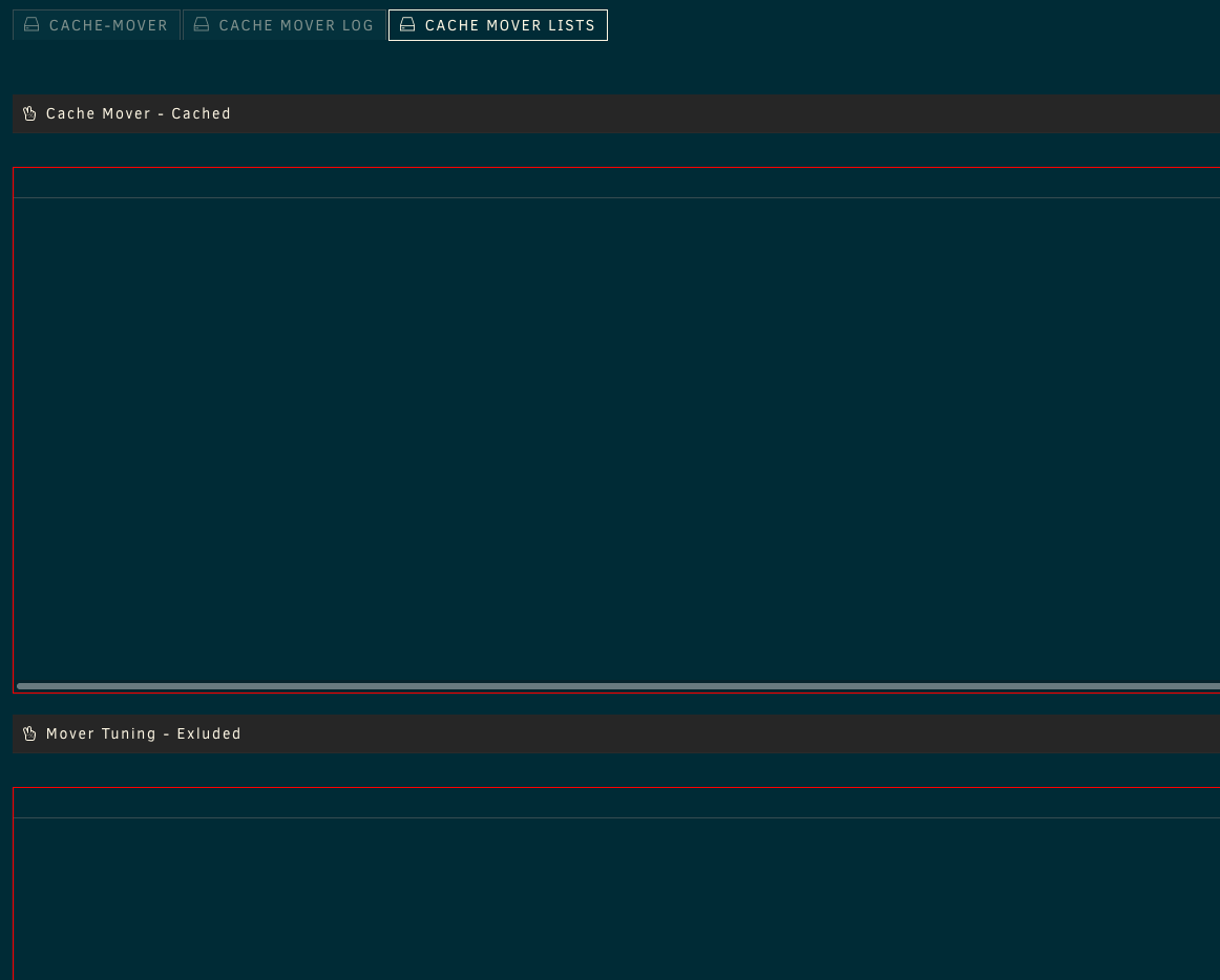

  5. It works now thanks again for your help 😊. I still have a clarification question. My setup: /mnt/user/video - here are all the videos this share is on: /mnt/disk1/video /mnt/disk2/video /mnt/disk3/video Cache for the Share: Mnt/cache_data/Video The script is also copied to this cache folder. Assumed: I have a series where a new episode is loaded every week. This is first copied to the cache on Mnt/cache_data/Video. It then remains there for 5 days (set in mover). Let's say today S02E05 was loaded but the episodes S02E01-04 are already on the HDDs. Someone now watches episode 1 and the script now copies episodes 1-4 back into the cache to Mnt/cache_data/video. In the script under "Cache Mover - Cached" - we now have the S02 complete - Cached What happens if after 7 days the series is deleted from the cache (via script) with episode 5 in the Folder because it was not yet copied to the HDD? In the "Mover Tuning - Exluded" only the whole folder is displayed or does the script treat each file in the season folder separately. I hope I was able to formulate my question clearly.

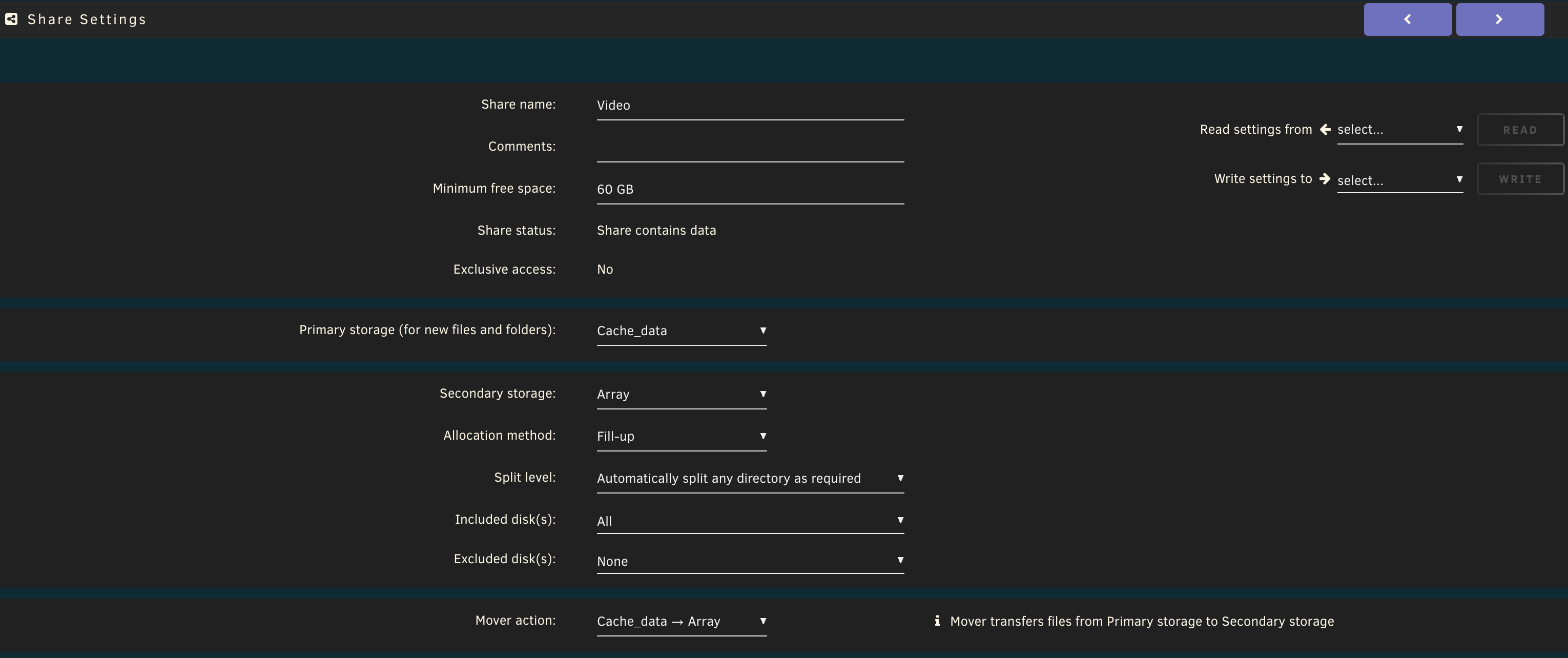

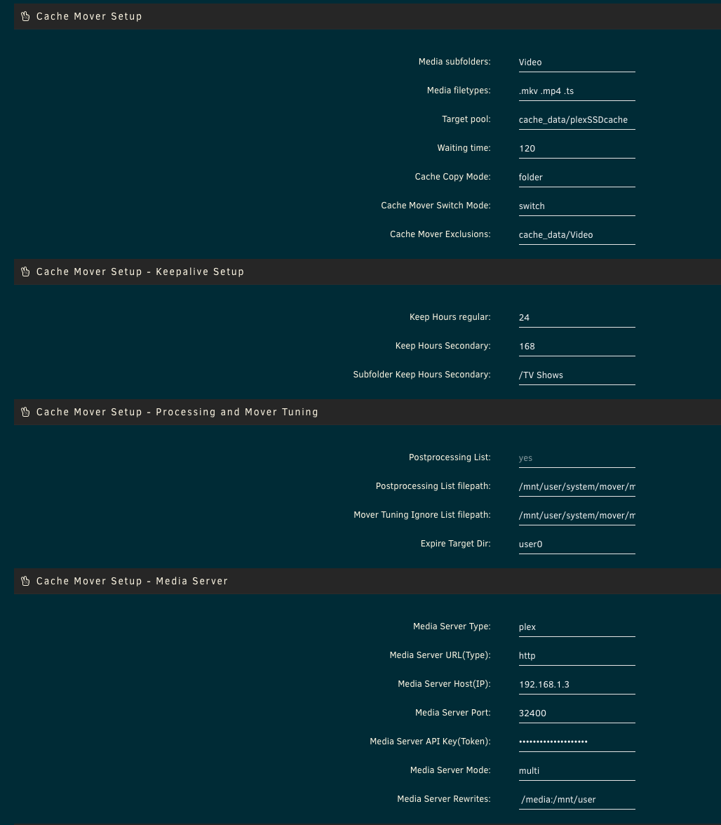

  7. yes these are my settings for the share. So i only should set the Target Pool to: cache_data But then on my cache_data SDD also all new files are stored and the mover take actions for this folder or did you script exclude this? The Media Server Mode is already set to : only

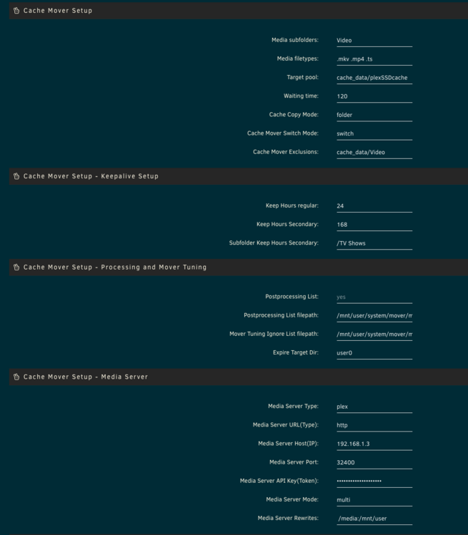

  8. So my share is /mnt/user/video - here are all the videos this share is on: /mnt/disk1/video /mnt/disk2/video /mnt/disk3/video the ssd cache for /mnt/user/Video is on: Mnt/cache_data/Video that's why I wanted to create an extra folder for the script that will move the files to /mnt/cache_data/plexSSDcache so that I can exclude Mnt/cache_data/Video in the script The videos are also copied there. in my Plex container: Container path: /media Host path: /mnt/user in plex direct the librarys are set to: /mnt/user/video/TVShows /mnt/user/video/Movies

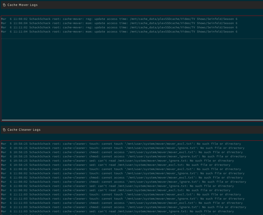

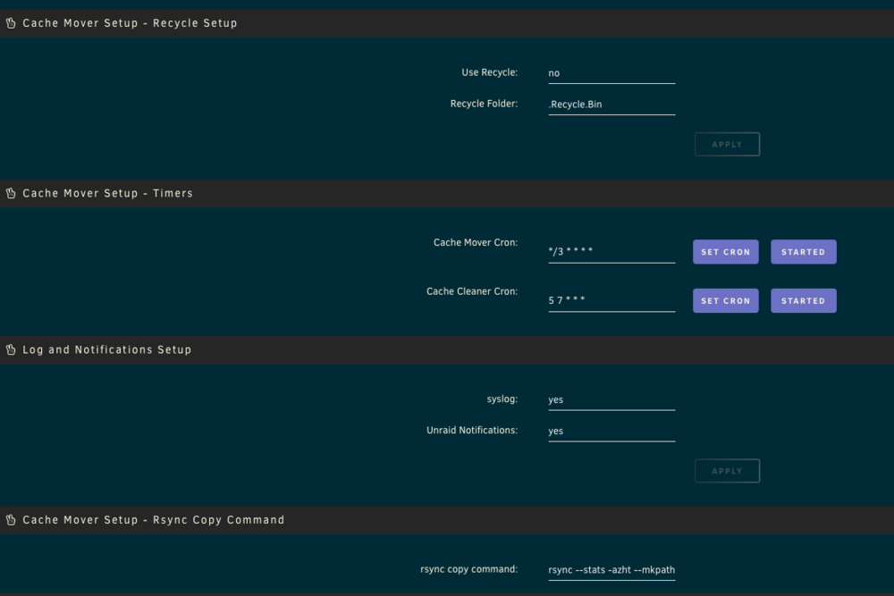

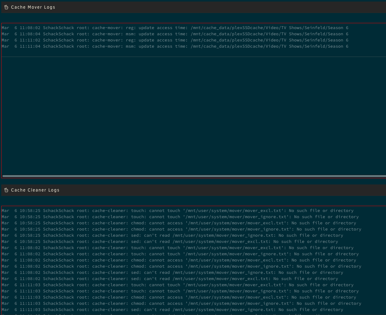

  9. Hello, Can someone maybe check if I made a mistake with Cache Mover. The series was copied to the specified folder, but Plex is still using the HDD (I can't get it to spin down). I don't see anything useful in the log. Did I maybe make a mistake somewhere in the config?
