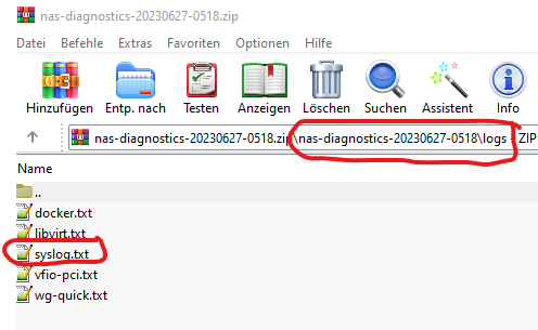

  22. ok thx for the explanation. In an earlier post I did add the syslog file directly from the log file folder. So the system is currently running on 6.12.2 for the past 2 hours, fingers crossed
  23. ok thx did switch it to ipvlan, now udpate again to 6.12.2 and test it if the server is stable?
  24. here is the file the crash should be around 01:30 in the morning of the 27.06.2023 syslog
