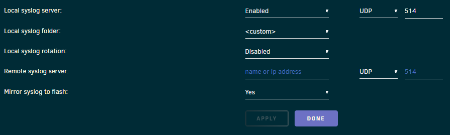

Now with syslog server activated
That doesn't come with the diags, you need to also post that log.
i thought it should be in the log folder? i set it up like this
It will be in the flash drive, /logs folder
so this is not the file in the diagnostic file?
here is the file the crash should be around 01:30 in the morning of the 27.06.2023
syslog
