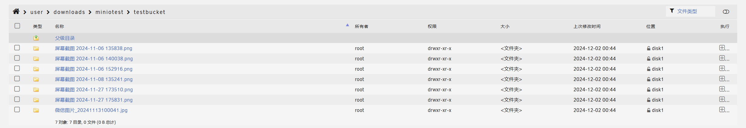

  2. Does Minio currently support the shfs filesystem? I did not use mergefs,but it seems that minio works as well

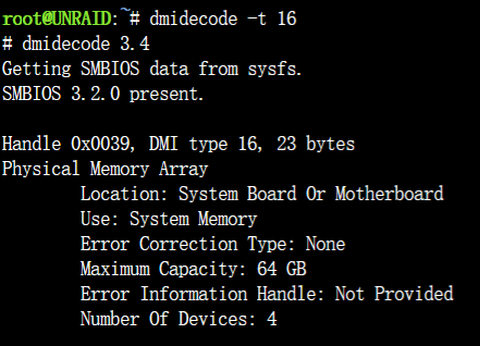

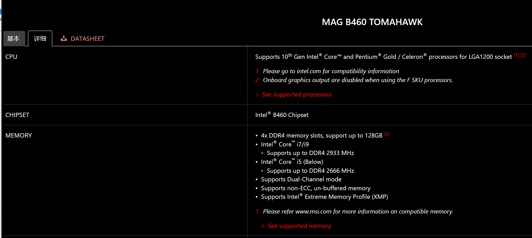

  16. msi 这款b460 官网上说是支持128g的,为什么查出来64g max呢
