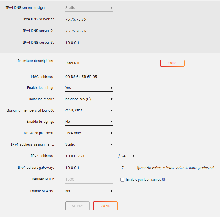

  1. After I reverted to 7.1.3, I had no further issues, so decided to let well enough alone for the time being. That was until 10/24/25, when the issue showed up again. I was unable to get connection to GitHub for a plugin update check. I disabled bonding and the connectivity worked again. Today, I updated to 7.2.0, and re-enabled bonding with the previous settings, and plugin update check is working again using the earlier bonding configuration.
  2. I have experienced a similar issue with 7.1.4. Also resolved by going back to 7.1.3. No connection to GitHub. Entire LAN slowed to a crawl whenever GitHub connection attempted. Also running bonded NICs, including one Intel. Detail below. The Realtek NIC driver has been updated. Sorry I captured no logs. Been too busy troubleshooting other tech! [10ec:8168] 22:00.0 Ethernet controller: Realtek Semiconductor Co., Ltd. RTL8111/8168/8211/8411 PCI Express Gigabit Ethernet Controller (rev 15) [8086:10d3] 24:00.0 Ethernet controller: Intel Corporation 82574L Gigabit Network Connection
