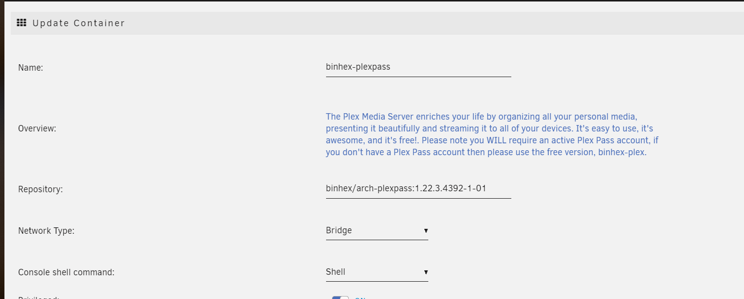

  3. I specified the version using tags.
  4. Cannot reach plex.tv [solved] Rollback to binhex/arch-plexpass:1.22.3.4392-1-01 and my transcodes are fine again. See others with this pain .at https://forums.plex.tv/t/plex-media-server-1-23-0-4438-unable-to-access-server-content-could-not-resolve-host-plex-tv/712425 At least I learned about perms.txt, updated my docker imagemax size, used curl to troubleshoot and got better at docker navigation and troubleshooting.
