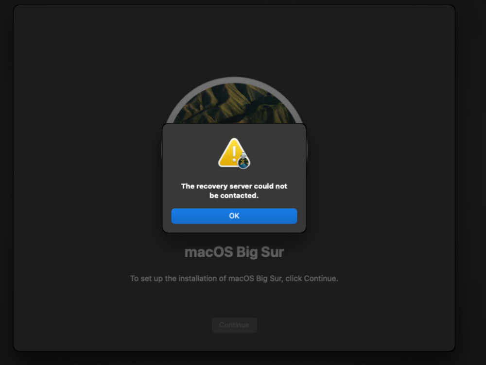

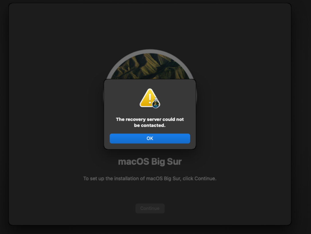

  6. I cannot seem to connect to the recovery server for any of the os versions. I followed the online tutorial and made sure I tried multiple nic settings. rerunning the docer after every change / attempt.

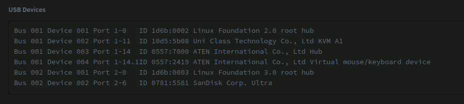

  14. Can you explain what you mean by you removed the iso files. If I remove them and try to boot the os it doesnt work. Just woundering what your actual steps were when you got this working.
