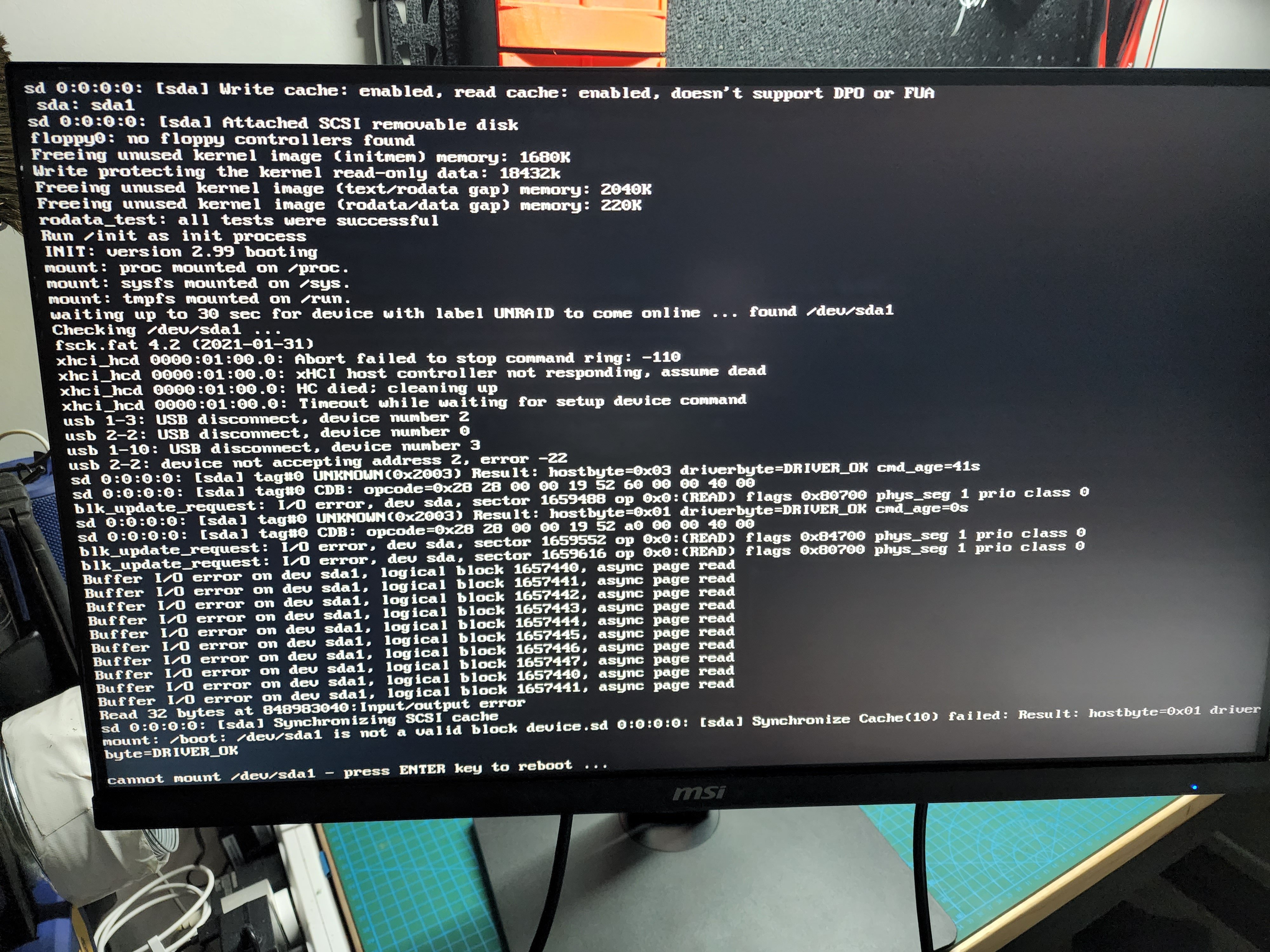

  1. I'm getting the same thing, I can get it to boot if I do a full power down wait 30 sec then plug back in. But if I reboot from the gui it just hangs here forever and if I hit enter to reboot as it says it again just does the same thing. Or it'll not even detect the usb any more. I've tried every bloody bios setting imaginable even tried switching back from uefi to legacy with no joy. Running 6.10.3
  2. Any update on this, did you manage to solve it. I am having the exact same issue.
