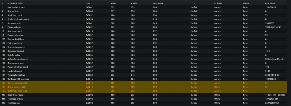

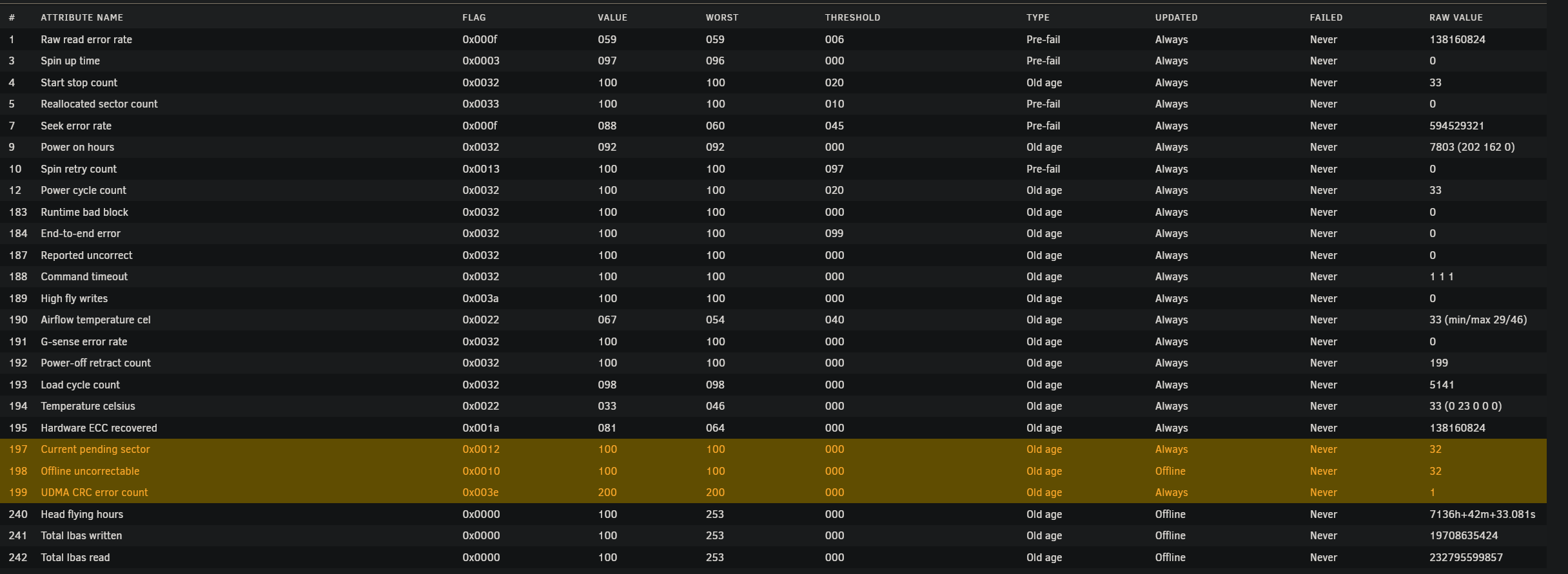

Okay so i have restored all my files and everything seems to be working fine, however last night i got a couple of warning notifications in regards to some SMART errors (See Below). So am i to assume this drive is going to shit itself again, should i look into something like unbalance to move everything to a different drive before this happens?
I ran an extended test see results attached  ST4000DM004-2CV104_ZTT088XX-20211220-1828.txt

SMART test failed, disk should be replaced.

Not needed, and likely would fail since the disk is bad, replacing the disk will rebuild the data to the new disk.
