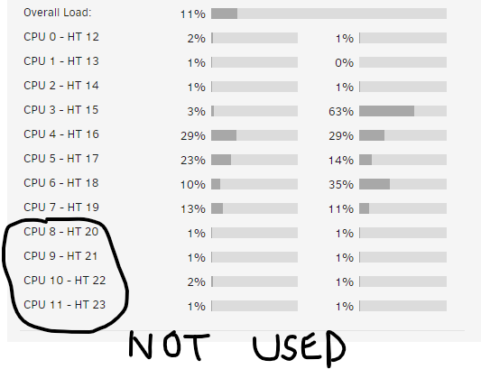

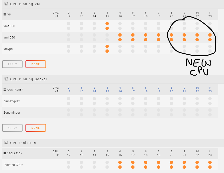

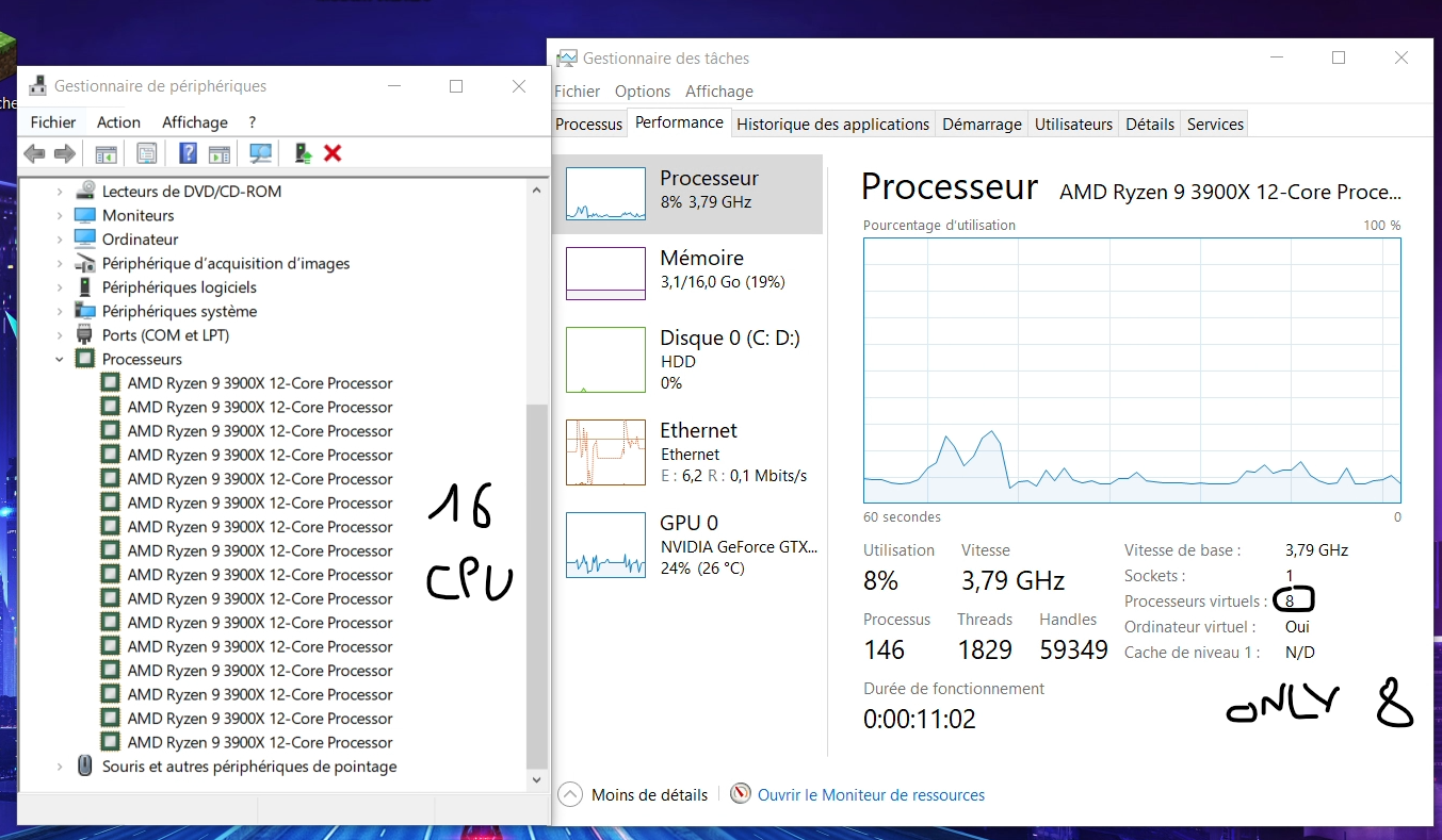

  4. Hello everybody, i decided to add some cpu to one VM (see pic) from 8 to 16 cpu. unfortunaly, after several check and several reboot, it has no effect: -in my VM, i can see the 16 cpu. (still only 8 cpu in the task manager) -in the unraid dashboard, only the 8 original cpu are used I checked the vm config file and everything seem right An idea please? by advance, thanks, Fabrice ps : unraid 9.11.5, gpu passthrough with nvidia 1650
