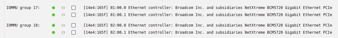

  4. Hey everyone, I had a similar issue. I'm using a DELL R720 with a Broadcom quad NIC. For some reason only two of the four NICs was present in the pfSense VM, but all for was present in other (Windows, Ubuntu) VMs. I've tried everything mentioned in this thread but I couldn't solved the problem. Let me document my issue then provide a solution: Unraid: v6.9.2 pfSense: v2.5.1 My NICs and IOMMU groups: The solution was to modify the the XML of my VM the following way: <hostdev mode='subsystem' type='pci' managed='yes'> <driver name='vfio'/> <source> <address domain='0x0000' bus='0x01' slot='0x00' function='0x0'/> </source> <alias name='hostdev0'/> <address type='pci' domain='0x0000' bus='0x05' slot='0x00' function='0x0' multifunction='on'/> </hostdev> <hostdev mode='subsystem' type='pci' managed='yes'> <driver name='vfio'/> <source> <address domain='0x0000' bus='0x01' slot='0x00' function='0x1'/> </source> <alias name='hostdev1'/> <address type='pci' domain='0x0000' bus='0x05' slot='0x00' function='0x1'/> </hostdev> <hostdev mode='subsystem' type='pci' managed='yes'> <driver name='vfio'/> <source> <address domain='0x0000' bus='0x02' slot='0x00' function='0x0'/> </source> <alias name='hostdev2'/> <address type='pci' domain='0x0000' bus='0x06' slot='0x00' function='0x0' multifunction='on'/> </hostdev> <hostdev mode='subsystem' type='pci' managed='yes'> <driver name='vfio'/> <source> <address domain='0x0000' bus='0x02' slot='0x00' function='0x1'/> </source> <alias name='hostdev3'/> <address type='pci' domain='0x0000' bus='0x06' slot='0x00' function='0x1'/> </hostdev> Please note: for the first two hostdev entry I use the same domain-bus-slot combination with a different function id and added the multifunction property. For the next two NIC I did the same but with a differet bus id. Hope this will help somebody, I spent some days to figure it out. If somebody could tell WHY this helped it would be appreciated, because I'm an Unraid noob, and I would like to learn. Best regards, Csard
