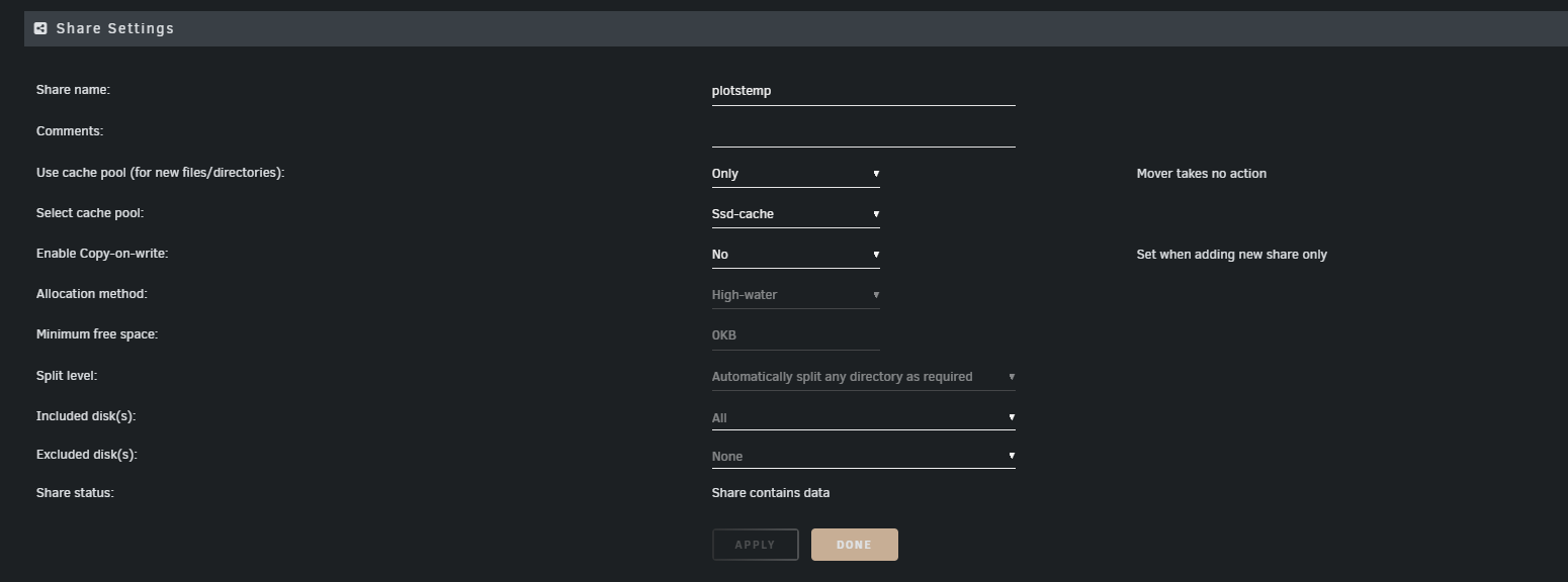

At this time the usage of this disk is 0% (close to 0) because like I said I stopped the container cleaned the directory manually from CLI and started it running again may be like 30 minutes ago. And here additionally how the share is defined: (since its mounted on user share)

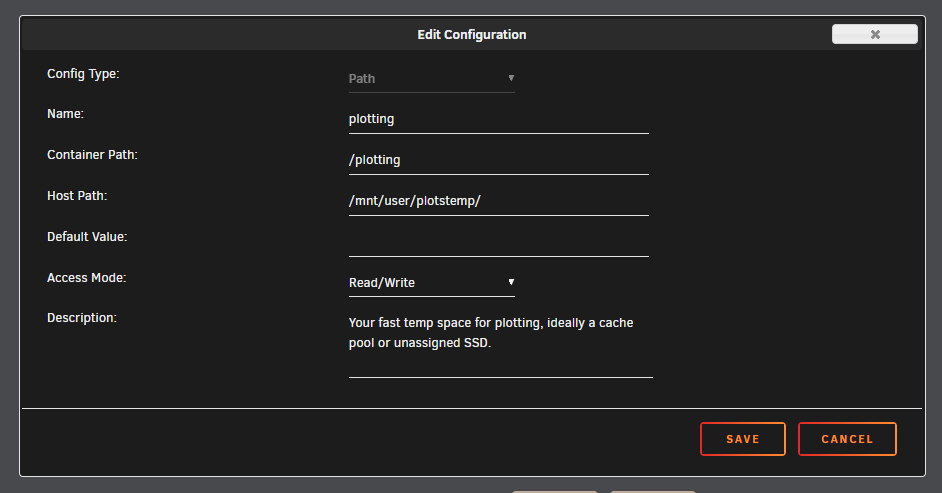

Hi I am using a share on a "cache pool" with "cache only" setting as temp plot directory, and it looks like plotter never deletes anything it creates interim or final. I am creating plots with k=32, have 2 plots being created in parallel and I still run out of disk space which is 1TB big. And 1TB should be more than enough for k=32 with two plots even at maximum temporary plot sizes. just to test I've cancelled one of the running plots, it disappeared from "plotting status" page, and the free space in th is cache drive did not change at all. Finally I stopped the docker container for machinaris and I still have a "full ssd" drive, and have to go in manually delete these temporary files generated by hand. Am I missing something or do I have to adjust a setting to.. I don't know "garbage collect"

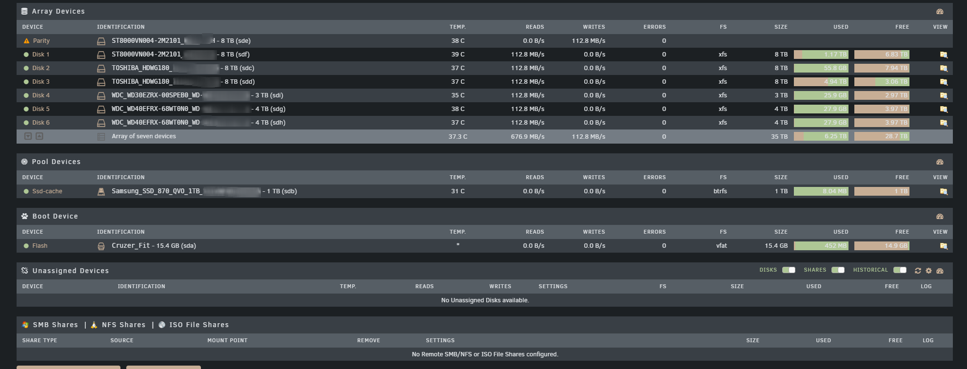

No sorry, the X did not disappear, but it was no longer complaining about a write error. I dropped the parity and re-added it. It is building the parity now 15hours 50 minutes remaining.. Out of curiosity do these speeds look normal to you? The first two are seagate ironwolf (ST8000VNZ04) and toshibas are Toshiba N300. Is there like a "community shared knowledgebase" of hdd's people own? I'm asking this because I have doubts about my HBA which I bought of off amazon as "new kit including cables" and received a generic brown box delivery with no cables. I removed the heatsink (to install a fan) and noticed the thermal paste was frozen like a brick, and the heatsink pins are bent on one corner. So it is 100% used, but I don't want to return it because of the "global chip shortage" unless it is visibly faulty. Is there a way to compare speed other than plugging one hdd off the HBA and plugging it on the mobo.

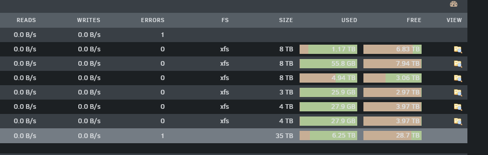

Thanks for the quick reply @trurl here is the full screenshot, in the previous one I only intended to show the "error = 1" side. Without even touching the box, I rebooted the system and unraid told me "all disks turned green" So does this still mean I have to rebuild the whole parity? for a momentary write error? (from the link you've posted) My perception (which can be entirely wrong) was: "random read/write errors happen all the time to mechanical hdd's but these are retried and corrected without user interference" So anytime there is a read/write error I have to rebuild the parity?

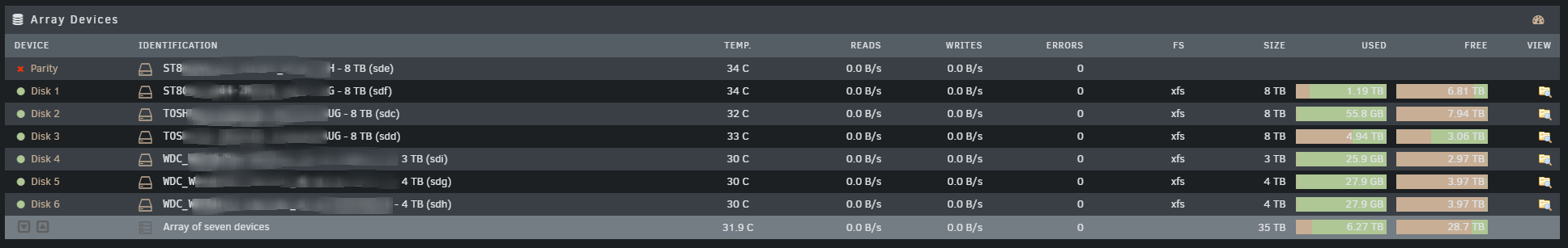

Hi, first and foremost apologies if something is amiss in this post, I'm very new to unraid (purchased last week) and this is my first post in this forum. Unfortunately it is a failure post. Before writing any further here are the diagnostics reports. [ edit: removed reports ] Like I said, this happened overnight and I woke up to this. The 8TB drives (including the failing parity drive) are brand new, the other 3-4TB ones are sourced from my other computers. I ran a full "pre-clear" on all new and used drives before setting up the server. So what I am failing to understand is: Is this drive in a "continuous error" state? OR "one error happened and Unraid took it offline?" What is the error? is it something to warrant sending the disk back? If not how do I clear this error and start using this parity disk again?
