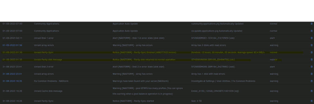

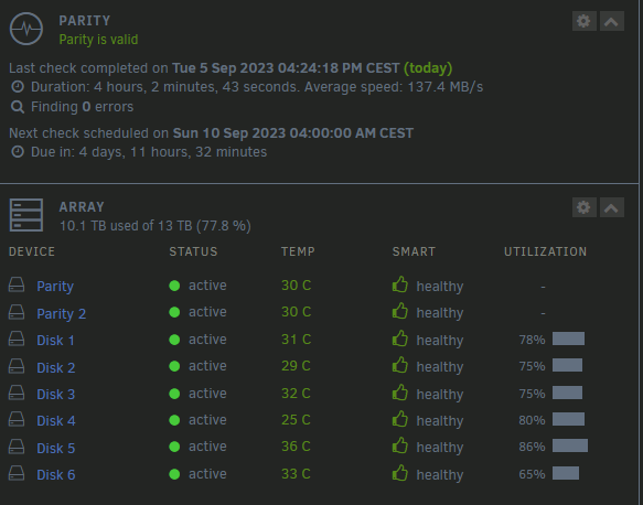

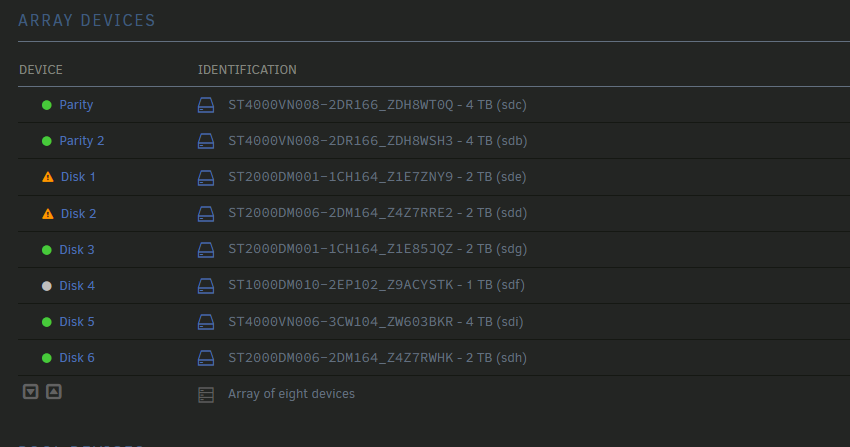

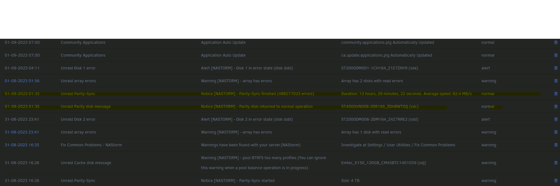

  1. Hello back, it's been a nightmare since then, everytime the parity sync runs, it finishes correctly, and then, one or two disk get disabled immediately. I shut the server off one week ago because I had no time to investigate. Yesterday, Parity 1 and Disk 1 were disabled. I changed sata cables for parity 1 parity 2 and disk 1 and ran a rebuild. It completed this night and seen the logs, it disabled the disk 1 and disk 2, 20 min later. Is it ok to continue on this topic or should I better open a non resolved topic ? Attached are the diagnostic, server was not powered down since then. nastorm-diagnostics-20230901-0912.zip

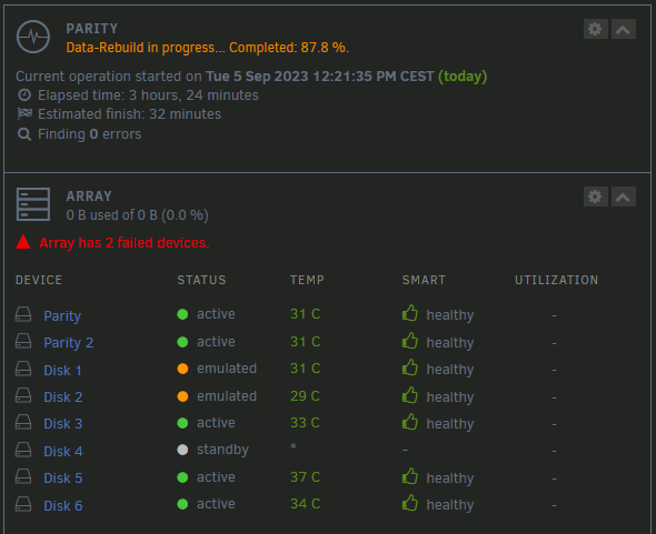

  4. Thanks. I started the array It did mount indeed ! It directly started a re-build. Do you think one or both disk are failing and should be replaced ? Since I'm 2 down, the array is currently unprotected, I maybe should not try to rebuild if a disk is in an unproper shape. edit : no lost+found folder on either disk.

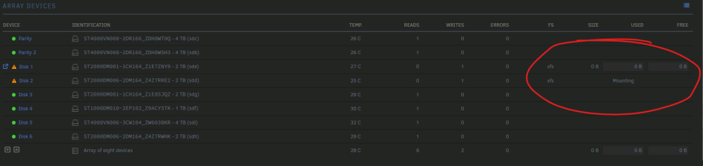

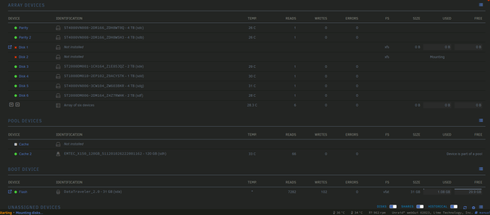

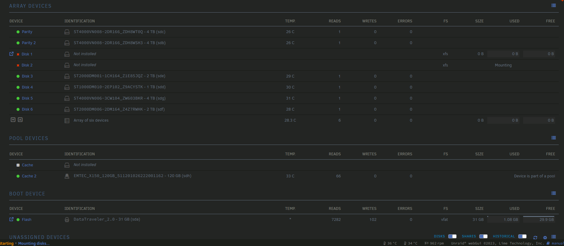

  8. To add another picture, here is what happens when both disk are disconnected in hardware, I can't even start the array to access the contents (emulated) as it is stuck on "Mouting disks..."

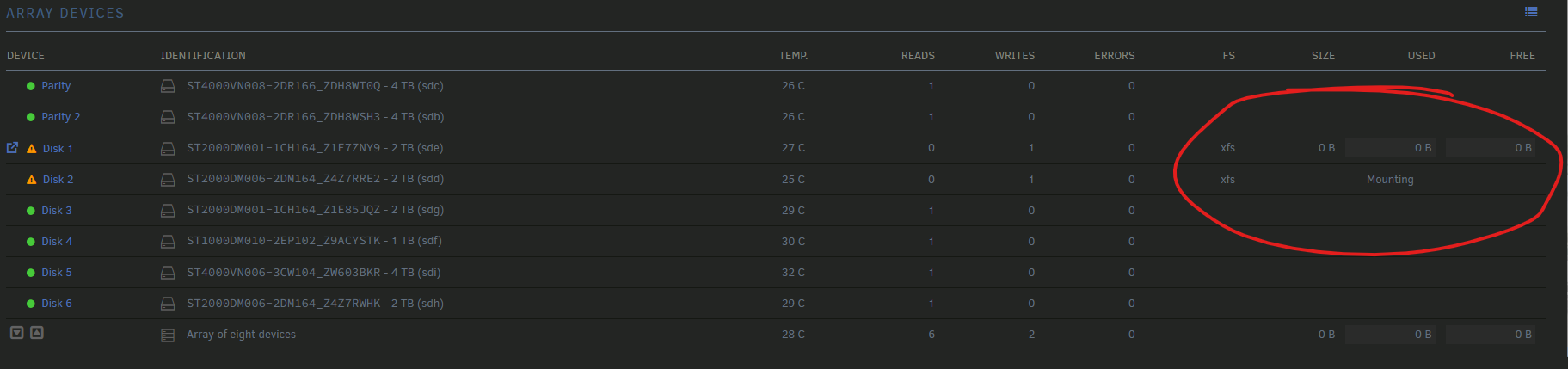

  9. Hello, I have 2 disk which have failed. I'm kind of lost about what to do as all the usual links to the FAQ are broken. I attached my diagnostics. Even when I unselect both disk (empty) and starts the array, it is stuck and also show "mounting" on disk 2. It does the same thing after trying to rebuild the array. Thanks in advance. nastorm-diagnostics-20230815-1658.zip
