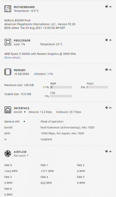

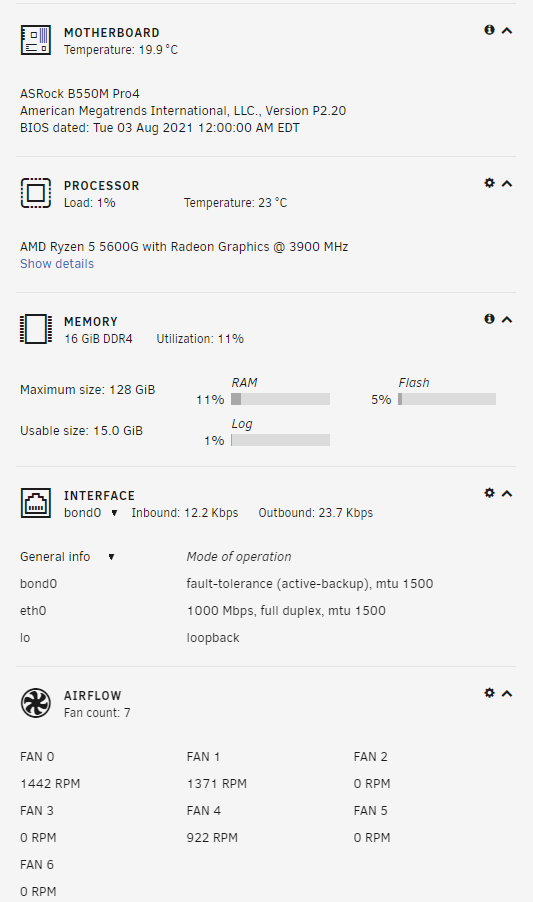

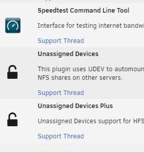

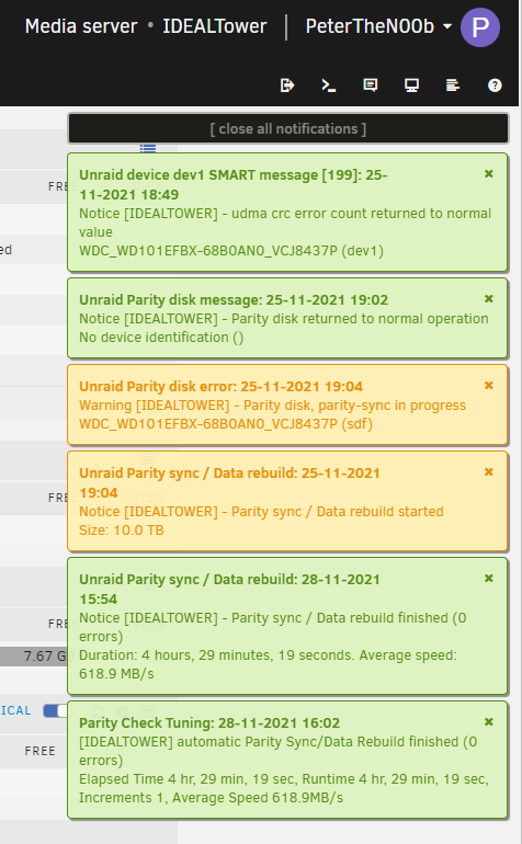

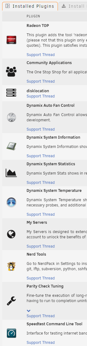

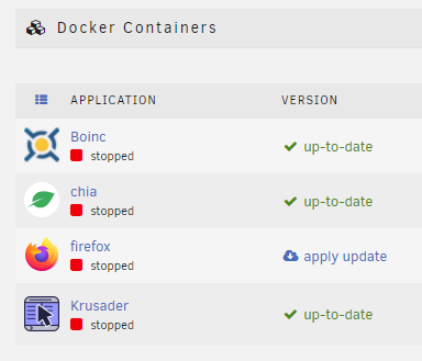

  2. Hi All; I just upgraded my Parity Drive from an 8TB to 10TB disk. Saved a backup of my config prior to swap Went to Main tab of Web GUI and did a shutdown of system. Physically swapped out 8TB Parity drive and replaced with new 10TB drive Powered on machine Changed Parity Drive to None Started Array - normal mode not Maintenance mode Stopped Array Updated Parity Drive info to point at new physical disk Started Array - normal mode not Maintenance mode Parity sync / data rebuild started Numerous instances of drives overheating so paused / resumed Parity sync / data rebuild multiple times (took 3 days) Noted that one data disk showed as Unmountable: Not mounted Upon completion of parity sync / data rebuild --> went to disk 1 page and ran Check with -n option - stupidly did not save output Ran Check with no options and got a long string of data (attached) Ran Check again with -n option and got a short report I don't understand what the check did/did not do so I need some guidance. Have attached: Output from Check command Diagnostics file produced after attempt to use Check to fix drive (previously stated I was a doofus and did not copy initial Check output) Supplementary data: screen snip of notifications from startup after swapping physical parity drive during parity rebuild - (I cleared all the ones about disks getting hot and returning to normal temperature). Notification messages: List of installed Docker Containers List of installed plugins (2) System Info Version: UNRAID 6.9.2 MOTHERBOARD ASRock B550M Pro4 American Megatrends International, LLC., Version P2.20 BIOS dated: Tue 03 Aug 2021 12:00:00 AM EDT Processor AMD Ryzen 5 5600G with Radeon Graphics @ 3900 MHz MEMORY 16 GiB DDR4 Utilization: 12% Maximum size: 128 GiB RAM 12% Flash 5% Usable size: 15.0 GiB Log 1% Docker 15% IDEALTower Disk 1 Check Output.txt idealtower-diagnostics-20211128-2305.zip IDEALTower Supplementary screenshots and check output.zip
