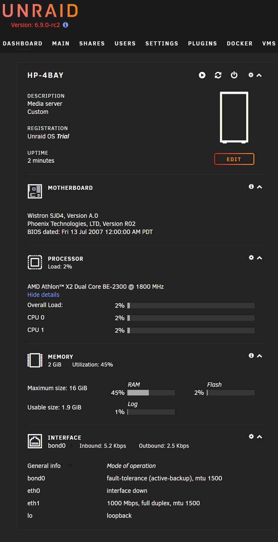

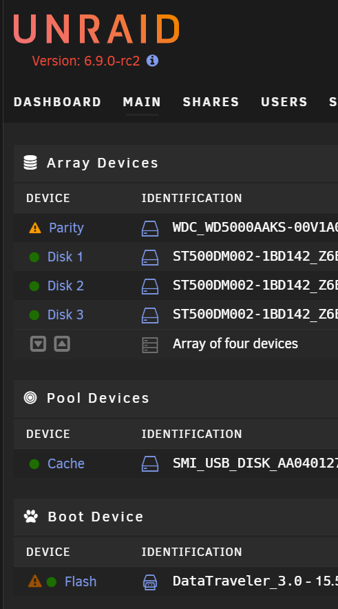

March 2, 20215 yr On 2/6/2021 at 1:05 PM, bombz said: Thank you so much for this Unraid Version: 6.9.0-rc2 Currently all 4x disk (test server) are detected I plugged in a SSD disk to the ESATA port (cache disk) on the back of the HP EX470 (modded system) and it detected Currently started the array and waiting to test over the next month. If all goes well grabbing another license! LOVE YOU UNRAID!!!! I have attached a photo of my test rig of disk I had laying around. Glad to see this old NAS (that really sucks as a stock NAS) is working with the golden UnRaid OS, with support (tested) up to 10TB How did you get the network port to run at full speed? it is super flaky and mine wont even register the trial license. It has an SiS 191 chipset
March 2, 20215 yr 32 minutes ago, lordbeavis said: How did you get the network port to run at full speed? it is super flaky and mine wont even register the trial license. It has an SiS 191 chipset hmmm.....i found some info on this but i am in over my head regarding compiling a kernel https://www.howtoforge.com/creating-the-sis191-gigabit-ethernet-driver-on-linux-2.6

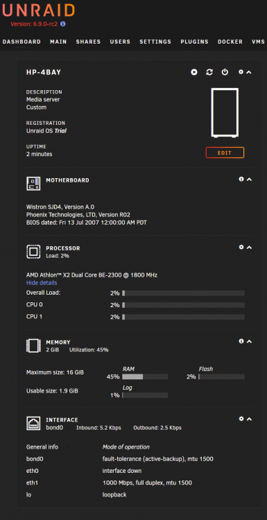

March 2, 20215 yr ok... my 4gb of ddr2 ram must have failed. got the 2 blue and 2 red after pressing the pinhole button in the front currently waiting for a AMD Athlon 64 X2 3250e to be delivered, so i needed to tear it apart anyways but i changed to a 2gb ddr2 800mhz. havent run the memtest86+ on the new ram but my issue with not being able to activate the trial key is gone. with 6.9.0-rc2 the link speed on my adapter 100 00:04.0 Ethernet controller: Silicon Integrated Systems [SiS] 191 Gigabit Ethernet Adapter (rev 01) Mar 2 14:45:43 HPSTORAGE kernel: sis190: sis190 Gigabit Ethernet driver 1.4 loaded Mar 2 14:45:43 HPSTORAGE kernel: sis190: 0000:00:04.0: Read MAC address from EEPROM Mar 2 14:45:55 HPSTORAGE kernel: sis190 0000:00:04.0 eth0: mii ext = 0000 Mar 2 14:45:55 HPSTORAGE kernel: sis190 0000:00:04.0 eth0: mii lpa=c5e1 adv=01e1 exp=000f Mar 2 14:45:55 HPSTORAGE kernel: sis190 0000:00:04.0 eth0: link on 1000 Mbps Full Duplex mode Mar 2 14:45:55 HPSTORAGE dhcpcd[1294]: br0: carrier acquired Mar 2 14:45:55 HPSTORAGE kernel: bond0: (slave eth0): link status definitely up, 100 Mbps full duplex Mar 2 14:45:55 HPSTORAGE kernel: bond0: (slave eth0): making interface the new active one so i am back to not connecting at 1gbit hpstorage-syslog-20210302-2251.zip Edited March 3, 20215 yr by lordbeavis
